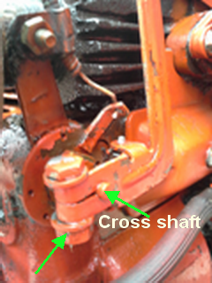

rmaynard 17,527 #2 Posted April 30, 2014 Sounds like a governor issue. Can you post some pictures of how you have the governor/throttle set up? Share this post Link to post Share on other sites
MikeWW 0 #3 Posted April 30, 2014 Here are the pics for "Full" and "No" throttle Thx, Mikeww Share this post Link to post Share on other sites

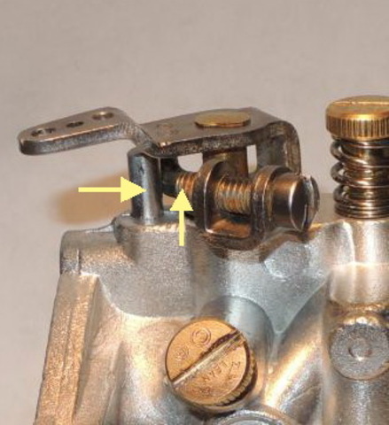

rmaynard 17,527 #4 Posted April 30, 2014 Is this a recent problem, or has it been ongoing? From what I can see, it looks like the governor setup is correct. When you are in the no throttle position, is the idle speed screw against the throttle stop? When you go between no throttle and full throttle, is there any change in speed? Have you had the carburetor off to inspect the throttle? Sounds like the throttle plate is not closing. Share this post Link to post Share on other sites

rmaynard 17,527 #7 Posted May 1, 2014 So if I understand you correctly, when you pull the throttle cable out 1/4", the throttle on the carburetor opens all the way? If that is the case, the governor is not holding it back. You need to check the governor for correct operation. Loosen the bolt that tightens the governor arm to the cross shaft. Try rotating the cross shaft. It should not rotate more than about 1/8 of a turn. If it does rotate freely, you probably have a broken tab on the shaft as buckrancher said, which will require engine disassembly to repair. If it only rotates a little, then readjust the governor by following the procedure described in the Kohler manual. If you don't have a manual, you can download it here. Share this post Link to post Share on other sites
