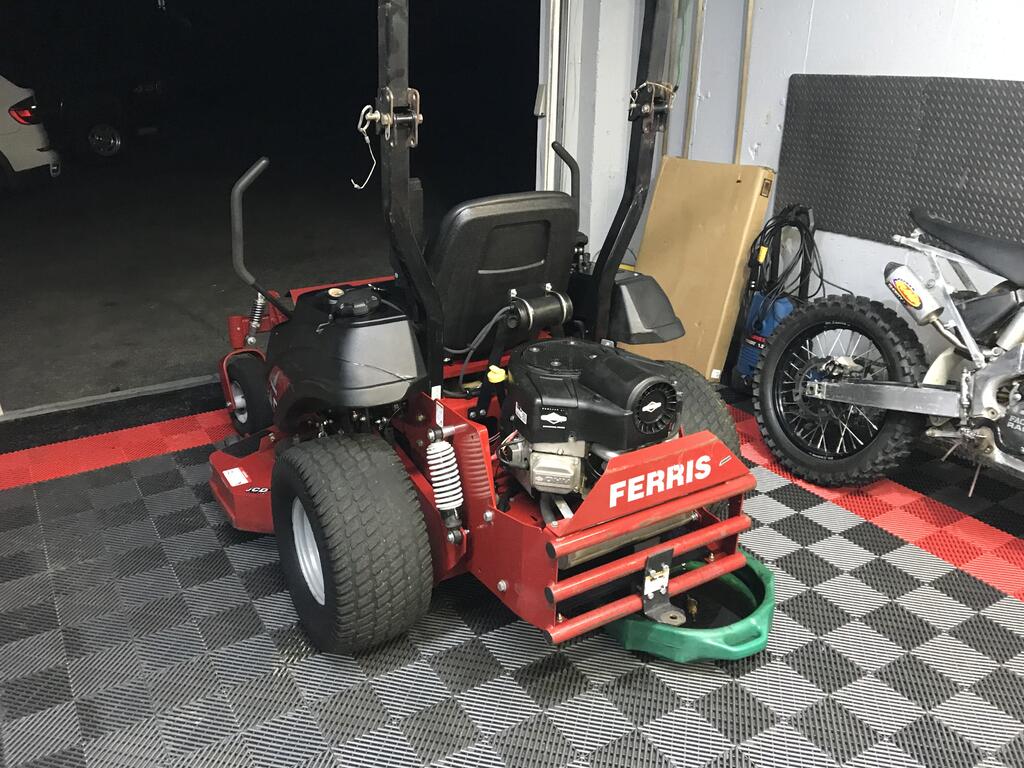

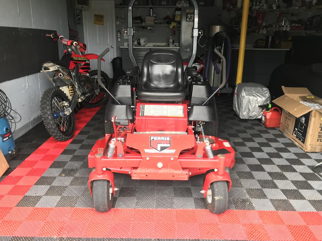

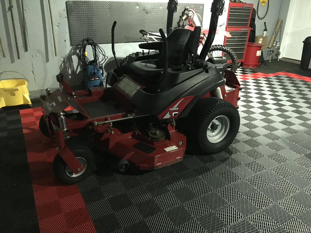

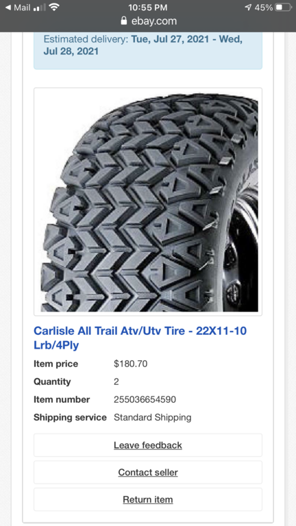

stevebo-(Moderator) 8,742 #1 Posted July 21, 2021 So I bought a Toro Timesaver 50” a few months ago. It was like new but after using it on my hills it was just not good for my property. Too light and rear wheels were too small to hold the hills. Sold that on Monday morning and Monday afternoon I picked up this 2013 Ferris 52” 700 series zero turn. The machine is a one owner with only 660 hours. After a bath and tune up it is everything I could want in a mower. I love my horses but this machine is the cats meow. Big Briggs twin runs mint and has tons of power. The machine has shocks all around. I ordered up some Carlisle trail tires foe the back and that should help hold the hills. It is not a horse but it is red! 8 1 Share this post Link to post Share on other sites

stevebo-(Moderator) 8,742 #10 Posted July 27, 2021 Thanks guys. This machine is the real deal and love it. Should have new rear shoes tonight or tomorrow according to the updates 1 Share this post Link to post Share on other sites

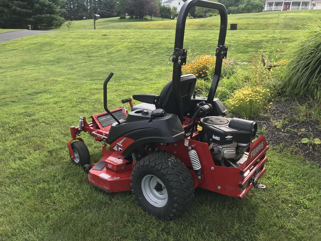

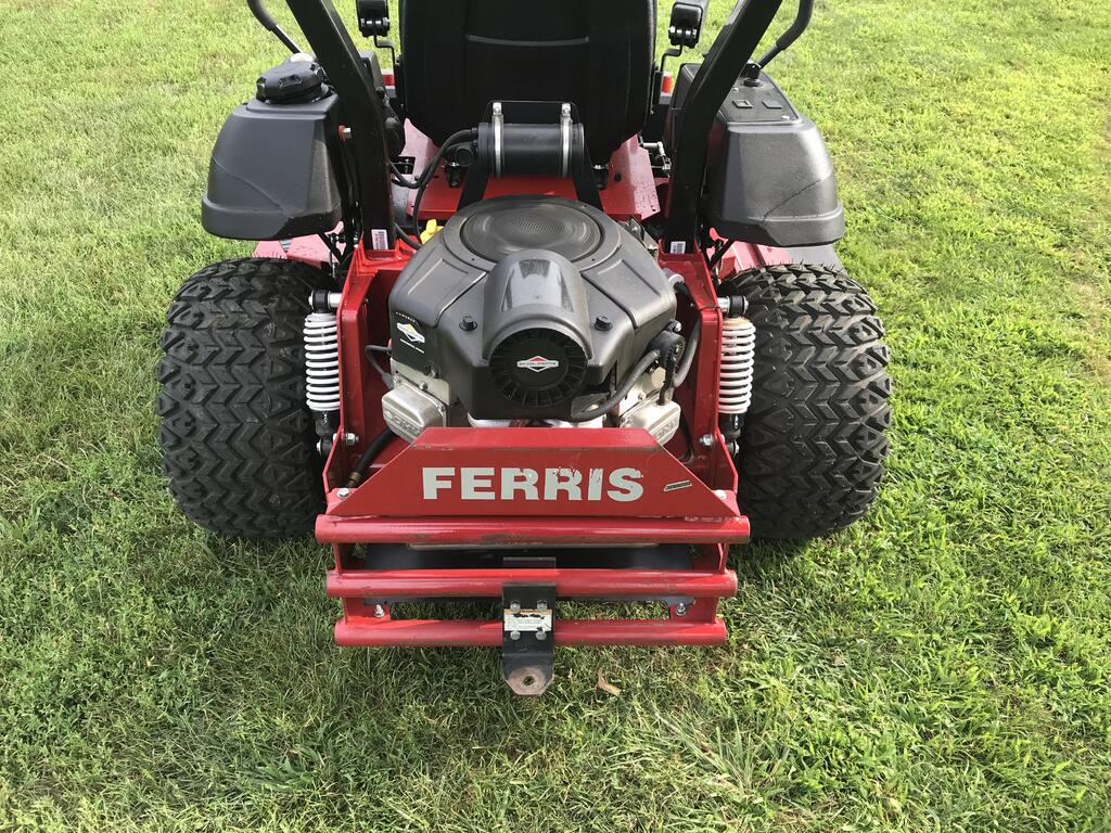

stevebo-(Moderator) 8,742 #11 Posted August 7, 2021 Finally got the tires and put them on today. What a huge difference on the hills! Share this post Link to post Share on other sites
stevebo-(Moderator) 8,742 #12 Posted August 7, 2021 I do have a question on blades. Those of you would have this machine are you running high lift or mulching blades? Pros/cons? PO told me he only ran 1 high lift blade and the other two are non high lift. I am yet to remove the deck and see. Lastly, If anyone has weight bracket on front I would love to see pics of it as I am gonna fabricate one. I have 4 small suitcase weights I picked up at the big show this year I plan on using for it Share this post Link to post Share on other sites
Handy Don 17,392 #13 Posted August 9, 2021 On 8/7/2021 at 6:54 PM, stevebo said: I do have a question on blades. Those of you would have this machine are you running high lift or mulching blades? Pros/cons? PO told me he only ran 1 high lift blade and the other two are non high lift. I am yet to remove the deck and see. Lastly, If anyone has weight bracket on front I would love to see pics of it as I am gonna fabricate one. I have 4 small suitcase weights I picked up at the big show this year I plan on using for it From what I can see, you have a front suspension. Adding weights (either to the axle as "unsprung weight" or to the frame as "sprung weight") will change the suspension's dynamics and possibly affect handling/ride. Share this post Link to post Share on other sites
