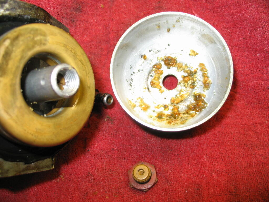

daveoman1966 3,884 #7 Posted July 19, 2021 Google search: PA ethanol free gas 16335 (Your State...and Zip). It'll pop up REAL GAS in your area. ps...here is what E-gas did to my K241 carburetor, after sitting for less than a month. 1 Share this post Link to post Share on other sites

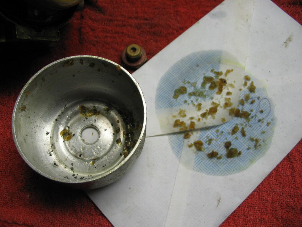

lynnmor 9,055 #14 Posted July 20, 2021 2 hours ago, formariz said: I have never had these problems with the gas I use but my next door neighbor which also has a wheel horse has. I clean that carburetor at least twice per year finding it always clogged with the famous "pearls". I have here tractors such as my 753 and my 551 just to name a couple, that haven't had the carburetor removed in over 10 years and work flawlessly even though they sit all the time. I start them perhaps once every two weeks at best. Many people bring on the problems by the way gas is handled. Keep the cans and tanks completely closed except for the brief period of time to pour the gas. A friend of mine has a camp in the mountains and only uses the gas caps on the cans when transporting. Share this post Link to post Share on other sites

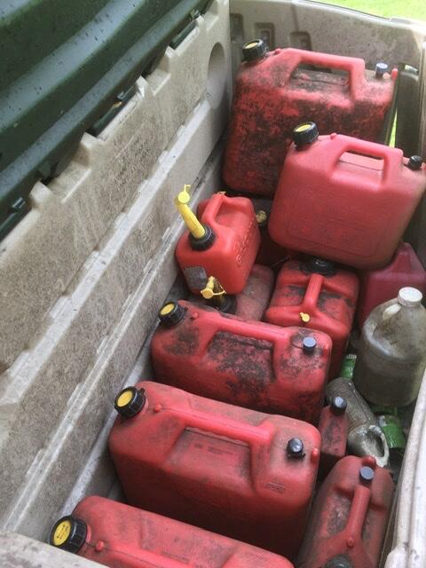

tom2p 2,396 #16 Posted July 21, 2021 (edited) I do just about everything wrong - but knock on wood no issues use standard gas from the local Sheetz gas sits in plastic containers in an outdoor resin / plastic storage bin that is exposed to the elements and falling apart and not sealed well - and the caps / vents on the plastic containers are not tight (because when tight the containers will swell due to pressure build) go figure but the gas does not sit long - so that could explain why no issues for the tractors I will typically fill two 5 gallon containers and go through them quickly ... can use around 15 gallons per month spring through fall I use Sta-bil in the gas toward the end of fall - when there is a greater chance the gas will sit longer in the containers or tractors ... and sometimes will also add a little 2 cycle mix the tractors will often sit unused for a few months in a garage during the winter months (Dec - Mar) - but I will start / run them every 30 - 45 or so days Edited July 21, 2021 by tom2p Share this post Link to post Share on other sites
