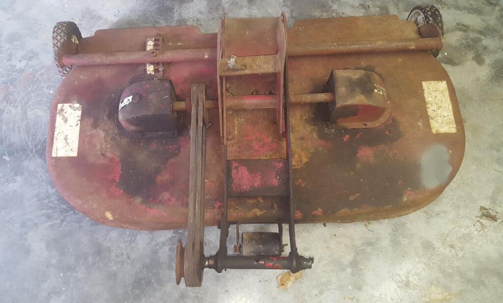

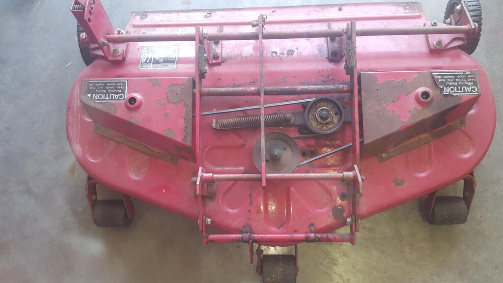

Gregor 4,838 #1 Posted July 18, 2021 So, I have this mower deck. It came with the C-141 when I bought it. I can find no numbers or serial # tag on it. It measures 44" wide, has 3 blades, and is rear discharge. If possible, I would like to rebuild it, and put it on the C-125. Will it fit? Is the mule drive the same? I also have this deck. It came with the 876. It measures 37" wide, has 2 blades, and is rear discharge. Things look a little caddy-wompus on it right now, But I think it can be straightened out. I would really prefer this deck on the 125, but I don't know if the PTO can be adapted to work. Can it be done? Anyone ever done it? Share this post Link to post Share on other sites
pfrederi 17,128 #2 Posted July 18, 2021 Smaller deck is driven by a 2.5" pulley not the 5" on your C125...Blades might take off at doubled speed Share this post Link to post Share on other sites
clueless 2,898 #3 Posted July 18, 2021 Top picture deck looks to be a 36" or 42" RD deck, probably a 42". It will work with the C125 and mule drive just fine with the right PTO drive belt. The one in the bottom picture, not so much . Share this post Link to post Share on other sites
gwest_ca-(File Mod) 10,478 #4 Posted July 18, 2021 The 42" deck will be one of these Mower DNA 1976 model 65-42MR01 replaced by - (Has the flat spindle belt idler pulley mounted on a triangular plate.) - (Has multi-link hardware at the gauge wheel support) 1977 model 75-42MR01 - Both use blades with 5/8" x 3/4" double-D center hole unless the spindles have been upgraded. (Has the flat spindle belt idler pulley mounted on a triangular plate) - (Has multi-link hardware at the gauge wheel support) ---------------------------------------------------------------------------------------------------------------------------------------------------------------------------------------------------------------------------------------------------------------- These all use blades with 3/4" center hole. 1977 model 75-42MR02 replaced by - (Has the flat spindle belt idler pulley mounted on a flat bar) (Has multi-link hardware at the gauge wheel support) 1978 model 85-42MR01 - (Has the flat spindle belt idler pulley mounted on a flat bar) (Has multi-link hardware at the gauge wheel support) 1979 model 95-42MR01 - No ipl available 1979 model 95-42MR02 - (Has no multi-link hardware at the gauge wheel support) 1980-1983 model 05-42MR01 1984 model 05-42MR02 - Last year for bearings with 3/4" ID 1985 model 05-42MR03 - First year for bearings with 17mm ID unless older spindles were updated. 1986-1988 model 05-42MR04 1989-1990 model 15-42RC01 1990-1992 model 15-42RC02 1993-2012 model 78350 Share this post Link to post Share on other sites
peter lena 8,035 #5 Posted July 18, 2021 @Gregor agree with @clueless on the 42" R/D deck , have 3 of them , rebuilt a couple and detail upgraded them for dependability , improvements , all bearings are the 6203 ( 3/4 " id ) also replaced the pto bearings , my suggestion is to use the LUCAS EXTRA HEAVY DUTY POLYUREA GREASE , HI TEMP AND ANTI SLING , I REGREASE ALL MY BEARINGS WHEN NEW , WITH A WIPE OUT OF OF ORIGINAL GREASE. and refill with lucas hi temp , for zero failure and no noisy whining. like the way those r/d decks clean out , any questions just ask . pete 1 Share this post Link to post Share on other sites
