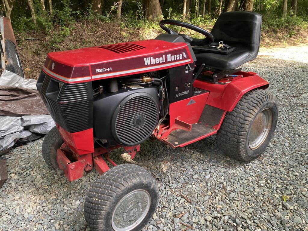

zeke37 24 #1 Posted July 16, 2021 Hello my 520H has developed a condition of fuel in oil. History is purchased last spring ran all summer changed oil fall, filled to capacity and checked on the stick. Over winter tried, but could not get it to start. Couple of days ago tried and it fired up and is running pretty good as I took it for a laps around the yard. Checked oil, was least a quart up, drained some and noticed it was thin and smells strong of fuel. New to these engines, any thoughts? Big Thanks, Tim Share this post Link to post Share on other sites
953 nut 69,555 #2 Posted July 16, 2021 Your fuel pump is a vacuum operated pump and when the diaphragm develops a leak the crank case vacuum will draw fuel into the crank case. I would suggest capping the vacuum line and get an electric low pressure fuel pump. 4 Share this post Link to post Share on other sites
Gregor 4,848 #3 Posted July 16, 2021 First thought. DON'T START IT AGAIN , until you change the oil, and fix the problem. 3 2 Share this post Link to post Share on other sites
Bill D 3,158 #4 Posted July 17, 2021 (edited) 2 hours ago, 953 nut said: Your fuel pump is a vacuum operated pump and when the diaphragm develops a leak the crank case vacuum will draw fuel into the crank case. I would suggest capping the vacuum line and get an electric low pressure fuel pump. I'll second this. Try Facet 40177 if you go with an electric pump. Edited July 17, 2021 by Bill D 1 1 Share this post Link to post Share on other sites

Handy Don 17,491 #12 Posted July 17, 2021 Replacing the diaphragm pulse pump is not hard or expensive. Many 520’s do just fine with “stock” components. Share this post Link to post Share on other sites
