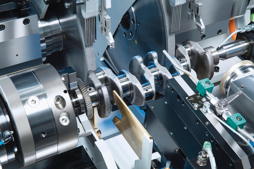

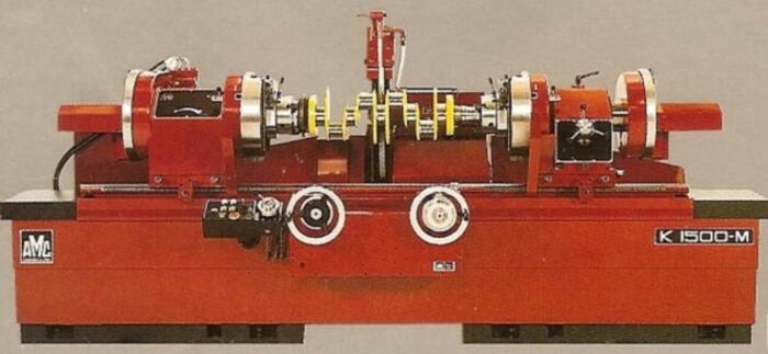

Handy Don 17,419 #51 Posted August 1, 2021 I've often wondered what sort of jig holds a crankshaft so that the rod races can be machined. Anyone have an image? Share this post Link to post Share on other sites
richmondred01 2,391 #52 Posted August 1, 2021 27 minutes ago, Handy Don said: I've often wondered what sort of jig holds a crankshaft so that the rod races can be machined. Anyone have an image? they are large machines to handle any crankshaft. These little engines that we fool with only half the machine is used. Share this post Link to post Share on other sites
Handy Don 17,419 #53 Posted August 1, 2021 2 minutes ago, richmondred01 said: they are large machines to handle any crankshaft. These little engines that we fool with only half the machine is used. Both of these images seem to address machining the main journal bearing surfaces that are in line with the shaft. How does it align the offset rod journals? Share this post Link to post Share on other sites
