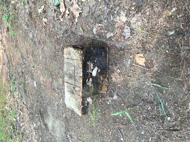

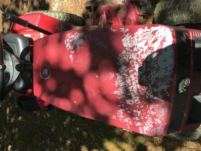

AHS 1,703 #1 Posted July 11, 2021 It happened during the 2” of rain! My garage was full of other wheel horses! So I put a tarp on the WH, then held it in place with a block of wood. And when I pulled the tarp of, white on the front of the hood. It doesn’t feel like primer. Or the paints peeled. It wasn’t at all windy, so the wooden block did not move. Water underneath the paint? Share this post Link to post Share on other sites
ebinmaine 81,047 #2 Posted July 11, 2021 Water alone certainly shouldn't have done that. Perhaps the tarp was off gassing or has something on/under it? Does the white scrape/clean off or is it the actual metal of the hood? 2 Share this post Link to post Share on other sites
rmaynard 17,634 #3 Posted July 11, 2021 (edited) What's on the underside of the tarp? Was this original paint or had it been repainted? Edited July 11, 2021 by rmaynard 1 Share this post Link to post Share on other sites
squonk 48,287 #4 Posted July 11, 2021 (edited) I bought a low hour 312 with original paint that had the same thing happen. Owner had covered it with a tarp. White milky paint. Almost like the tarp drew the pigment out of the paint. Really weird. Edited July 11, 2021 by squonk 1 Share this post Link to post Share on other sites
AHS 1,703 #5 Posted July 11, 2021 10 minutes ago, rmaynard said: What's on the underside of the tarp? Was this original paint or had it been repainted? Original Share this post Link to post Share on other sites
AHS 1,703 #6 Posted July 11, 2021 2 minutes ago, squonk said: I bought a low hour 312 with original paint that had the same thing happen. Owner had covered it with a tarp. White milky paint. Almost like the tarp drew the pigment out of the paint. Really weird. Yes! I’m not at that point yet.. but I was wondering if I should buff it? I dunno if that’ll bring out the paint. Share this post Link to post Share on other sites
squonk 48,287 #7 Posted July 11, 2021 Nothing worked with the tractor I had. The color was gone. The milky color was not on top of the red. 1 Share this post Link to post Share on other sites
c-series don 12,609 #8 Posted July 11, 2021 A friend of mine had an absolutely beautiful D-160, I mean damn near a 10 out of 10 but he put it outside under a blue tarp. It rained and then the sun came out and baked the tarp to the hood, basically ruined the paint. Really was a damn shame. 2 Share this post Link to post Share on other sites
tunahead72 2,662 #9 Posted July 11, 2021 This is so weird. I just had the same thing happen to my 310-8 a few days ago. It survived a road trip to Virginia and back with no incidents, got back home and rain threatened before I was going to be able to get it back in my shed, so I covered it with one of the silver-colored heavy duty tarps from True Value or Ace I had laying around. It rained that night, and when I uncovered it a couple of days later, it had the same kind of damage you guys are describing. This particular tarp had a load of topsoil on top of it for several weeks, and sat on top of the pressure-treated deck of my trailer that whole time. I should have rinsed it off before I put it on my tractor, but didn't have time. Maybe the topsoil leached through the tarp, or something from the pressure treatment, I don't know. The white stuff didn't come off at all with a wash of mild dish detergent and water. I did rub one small area more aggressively with my finger tips, and it seemed to disappear a little and reveal red paint again, but I stopped before I did more damage. The paint is original, only been washed and waxed a few times in its lifetime. I hope somebody has some ideas, short of repainting the whole hood, which in this particular case isn't going to happen. Share this post Link to post Share on other sites
AHS 1,703 #10 Posted July 11, 2021 I was thinking, what if it were the wood that I had on top of it? ( in that exact same area). I mean it has sat outside for many of rain storms and snow storms….. it what if that had something to do with it. I have absolutely no idea what has been on that block of wood…. Grease, creosote, gas, oil… you name it. I guess that’s an idea… to open the hood.. and tarp it, right from the rear end all the way over the motor. Close the hood. (The hood will be left un tarped) Share this post Link to post Share on other sites
Jeff-C175 7,211 #11 Posted July 11, 2021 I believe it's the 'plasticizers' in the tarp material that are 'migrating' into the paint. One time I stuck a cassette tape box above the sun visor in my brand new-ish Pontiac. A few days later I went to pull down the visor and the two plastics had 'welded' together. And it was NOT hot out, it was winter time. Probably what happens with the tarps. Check out: https://flooristics.com/plasticizer-migration/ 1 Share this post Link to post Share on other sites

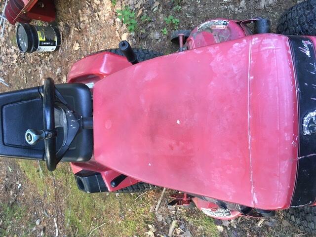

AHS 1,703 #17 Posted July 14, 2021 I got it clear by wet sanding, by, er 300 grit! (That’s what I had). Not bad for 20 year old paint… that’s all I can ask for! I’m not an auto body painter!! 🙈 Share this post Link to post Share on other sites
rmaynard 17,634 #18 Posted July 15, 2021 Looks like you are on the right track. Get a pack of fine grit sandpaper up to 3000 grit. Work your way up to 3000 by wet sanding 400, 600, 800, 1000, etc. As long as the paint is thick enough, you will end up with a pretty good finish. Then rub it out with compound and polish. https://www.amazon.com/gp/product/B07DTGP1QT/ref=ppx_yo_dt_b_asin_title_o00_s00?ie=UTF8&psc=1 3 1 Share this post Link to post Share on other sites
Jeff-C175 7,211 #19 Posted July 15, 2021 (edited) 1 hour ago, rmaynard said: fine grit sandpaper I've had pretty good results with LIGHT PRESSURE on 0000 steel wool also, perhaps one of the solutions that's designed to remove the iron particles from car finishes... and if you really wanna go crazy, clay bar! and then a good compound and polish afterward. Edited July 15, 2021 by Jeff-C175 2 Share this post Link to post Share on other sites

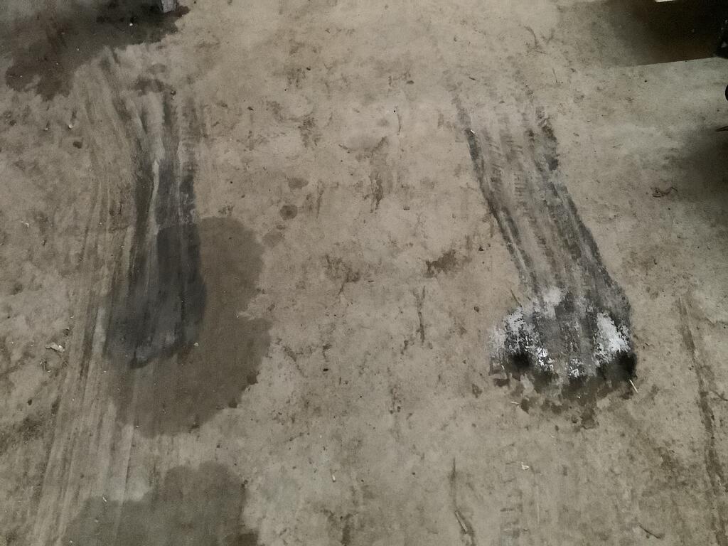

Pullstart 71,482 #20 Posted July 15, 2021 On 7/12/2021 at 7:20 AM, 953 nut said: May as well face it, Wheel Horse built a great garden tractor but their paint jobs weren't the best. Look at any old survivor and you will see that the Kohler engine paint is always in better shape than the paint. Paint on the engines of these two survivors is much better than the tractors. Richard, you’re right about paint quality... ...but they sure did shine in putting power to the ground! I used Jada’s 857 “Barney Fife” to move a work bench with a few of my FIL’s things on it this morning... 1 1 Share this post Link to post Share on other sites
AHS 1,703 #21 Posted July 15, 2021 @pullstart the 857s got limited slip? Hmm… I’ve got an 857! 1 Share this post Link to post Share on other sites
ebinmaine 81,047 #22 Posted July 16, 2021 28 minutes ago, AHS said: @pullstart the 857s got limited slip? Hmm… I’ve got an 857! I don't believe that one does. The 1967 to 1970 6 or 8 speeds and (some/all?) hydros had LSD. 1 Share this post Link to post Share on other sites
Pullstart 71,482 #23 Posted July 16, 2021 1 hour ago, AHS said: @pullstart the 857s got limited slip? Hmm… I’ve got an 857! No, just equally poor grip apparently! 1 Share this post Link to post Share on other sites
tunahead72 2,662 #24 Posted September 13, 2021 Back to the original subject... I saw this on CraigsList just now, look familiar? 3 1 Share this post Link to post Share on other sites
AHS 1,703 #25 Posted September 19, 2021 On 9/12/2021 at 9:17 PM, tunahead72 said: Back to the original subject... I saw this on CraigsList just now, look familiar? Yup, wet sand it. I’ve done two like that, with white patches on the hood. I’m not so scared to have white blotches on the hood, just wet sand it! 3 Share this post Link to post Share on other sites
