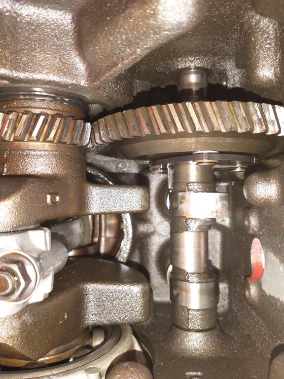

squonk 48,157 #12 Posted July 14, 2021 30W Rotella year round. This engine has had Rotella for 10 years. 1000 hours and I took it apart because the balance gears bean to rattle. Look how clean it is. No sludge or gunk. 2 1 Share this post Link to post Share on other sites
