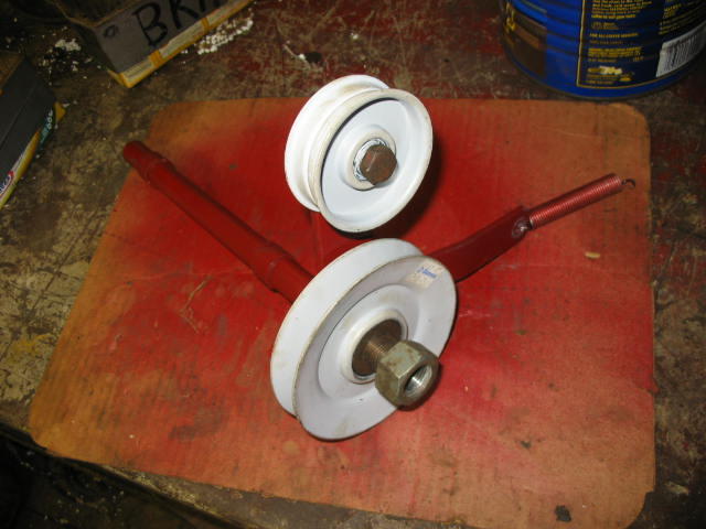

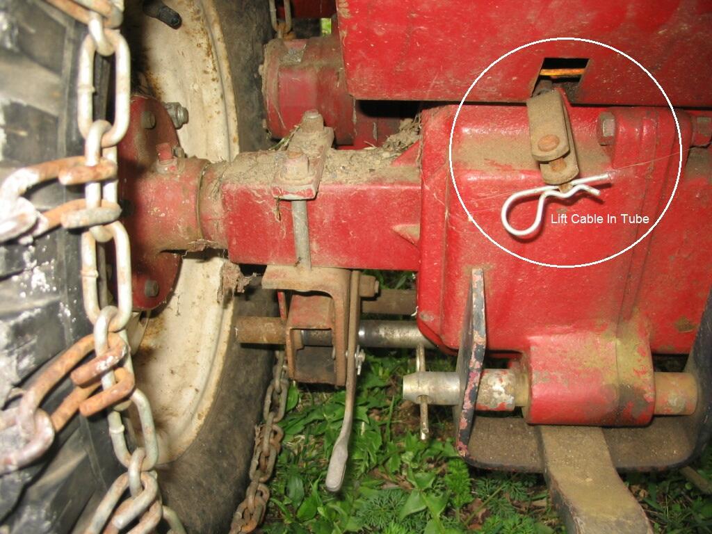

Solze1267 202 #1 Posted July 10, 2021 So I just purchased a tiller for my 1267 but the guy wasn’t able to show me how exactly it hooks up. I do know it uses the brackets for the snow plow which I already have on the tractor but I guess I don’t know from there. Do I leave my sleeve hitch on or take it off? Where does it attach to be able to lift? Pictures would help tremendously as I’m a visual learner. 1 Share this post Link to post Share on other sites
daveoman1966 3,880 #2 Posted July 10, 2021 You also need the Idler Pulley Assembly...looks like this, but there are variants. You need a CABLE lift that laces thru the CONDUIT TUBE under your seat.. ((I can provide the parts in the pic named 'Cable Conduit (3,& 1)..for $45...shipped)).. The pic shows where the LIFT CABLE extends thru the TUBE at the back of your tractor (This pics is a C-160, so the tiller bracket is different.) That cable hooks to a BAR link on the tiller and is raised/lowered by your implement LIFT LEVER. 1 1 Share this post Link to post Share on other sites
Solze1267 202 #3 Posted July 10, 2021 @daveoman1966 thank you that helps out tremendously Share this post Link to post Share on other sites
