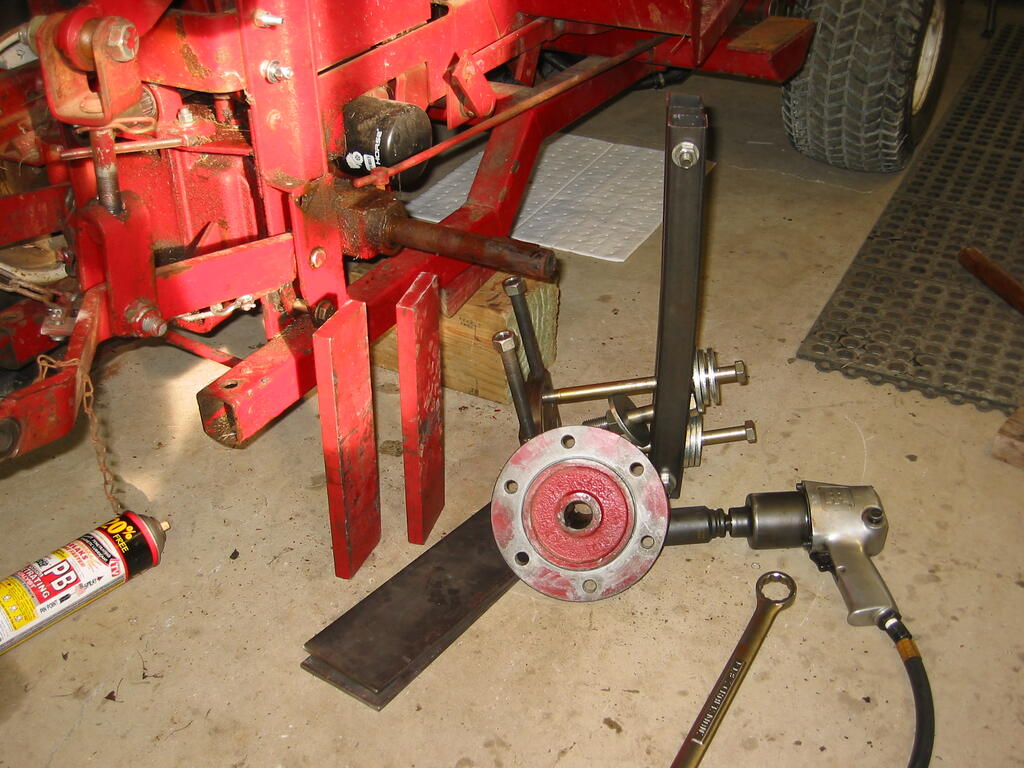

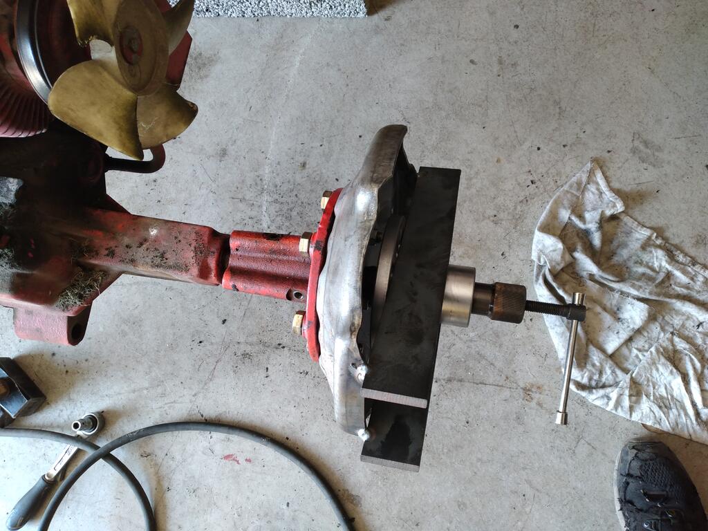

Skipper 1,792 #1 Posted July 7, 2021 (edited) Hi Guys This sounds like a noob question, and it kind of is, so please bear with me. I have newer taken off 6 lug hubs before I have taken plenty hubs off, the 5 lug type, no problem. But on the 195 and D series, they have a much longer contact area, and the ones I am working on are stuck hard. I made up a custom puller from a HD commercial rim center of very thick steel, some 1/2" flat bar, and a 5 lug hydraulic press. All is bolted up perfect to the hub, trying to push it off the axle. The set screws are out, and penetrating oil has been soaking in for a few days. I have put as much pressure on as I dare. tried heat, and tapping with a set of mallets on the sides, like you would to loosen a steering ball joint. (not on the mating surface of cause). Nothing makes it budge. I would estimate there is about 2-3 tons of pressure on it, and my gut feeling tells me that if I crank it up much further, the hub mating surface will snap. Can't tell exact pressure with this little press, but everything else I have used it on, would have given up a long time ago. So, now I have 2 options left, to avoid breaking something. 1. Pull the whole tranny, and set it up in the 50 ton shop press. That's heavy, and I will have to make axle wide fixtures for it, to go inn behind the hub. 2. Hope that someone here has the golden idea, that I have missed. Thanks guys Edited July 7, 2021 by Skipper 2 Share this post Link to post Share on other sites
squonk 48,072 #2 Posted July 7, 2021 If you could fabricate a 2 piece plate to go behind the hub it would be better. and a hex on the puller screw to use a breaker bar or big impact. 2 1 Share this post Link to post Share on other sites

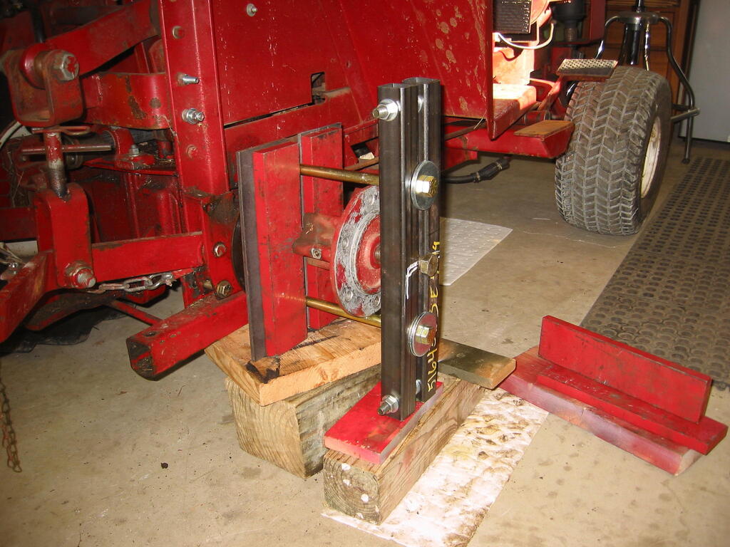

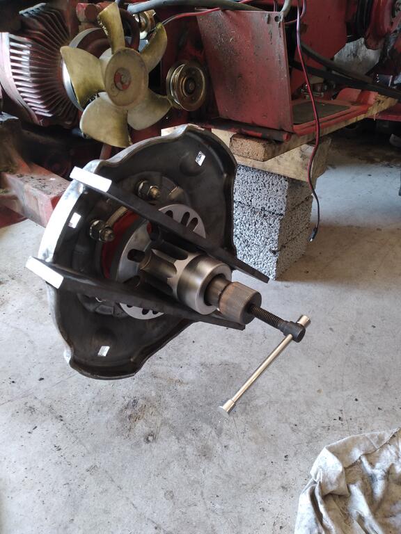

pfrederi 21,145 #3 Posted July 7, 2021 To avoid snapping the flange you have to pull against the back of the hub. 2 6 1 Share this post Link to post Share on other sites
peter lena 10,047 #4 Posted July 7, 2021 @pfrederi, great example of strength against strength , when you get a very solid and secure hook up , lubrication and leverage advantage , it just walks off the pull point , I like , pete 2 Share this post Link to post Share on other sites
squonk 48,072 #5 Posted July 7, 2021 4 minutes ago, pfrederi said: To avoid snapping the flange you have to pull against the back of the hub. Paul do those 2 red and bare metal plates just stay there from pressure or are they fastened some way? Share this post Link to post Share on other sites
pfrederi 21,145 #6 Posted July 7, 2021 11 minutes ago, squonk said: Paul do those 2 red and bare metal plates just stay there from pressure or are they fastened some way? They are held by the silver flange puller being behind them pulling them against the hub. 2 Share this post Link to post Share on other sites
Handy Don 17,462 #7 Posted July 7, 2021 1 hour ago, pfrederi said: To avoid snapping the flange you have to pull against the back of the hub. This setup looks like it can exert a fearsome amount of force! Well done 2 Share this post Link to post Share on other sites

pfrederi 21,145 #10 Posted July 7, 2021 53 minutes ago, Handy Don said: This setup looks like it can exert a fearsome amount of force! Well done Note that it bent the square tubing (Heavy wall) 3 Share this post Link to post Share on other sites
Skipper 1,792 #11 Posted July 7, 2021 2 hours ago, pfrederi said: To avoid snapping the flange you have to pull against the back of the hub. Yeah. My thoughts exactly. That was also what I would do in the big press. I guess I can fab up a contraption like yours or so. That's surely the way to go if the tranny should stay in. Thanks. Super info! 1 Share this post Link to post Share on other sites

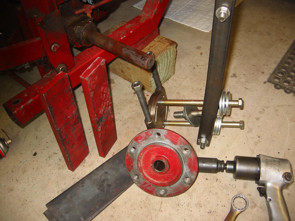

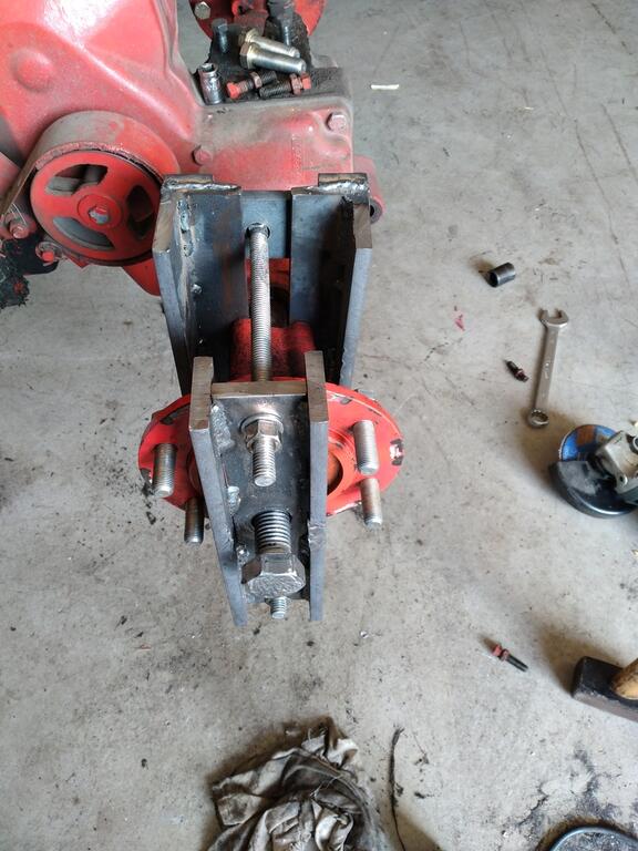

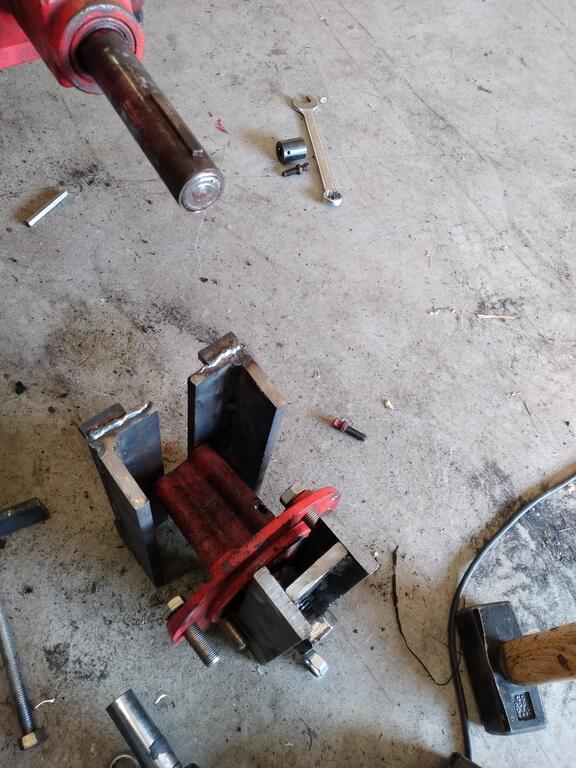

Skipper 1,792 #20 Posted August 3, 2021 (edited) So a quick update. I made a puller, and I really thought i had made it plenty strong. I welded it up in a H-frame style of 1/2"x2" steel. Put a 1" bolt in the middle, and put the impact gun on it.....................woulden't budge the least. So i figured while under tension, i would try wacking the big bolt, while pulling the axle as much out of the tranny as possible, and then with the weight of that puller contraption, and a lot of wacking, tightening and further wacking, it slowly creeped out. Next time, the puller will be rebuild to hold a bottle jack for sure. This was a PITA. The second hub was removed in the big shop press, no issues at all. Just a heads up on making life easier, if you ever have to split the diff, while in the tranny, with one side off. This flex end socket could easily sneak inn, and go on the nut. easy breezy. So as to why the tranny had to come apart, that will shortly appear in another thread Edited August 3, 2021 by Skipper 2 Share this post Link to post Share on other sites
953 nut 69,147 #21 Posted August 3, 2021 30 minutes ago, Skipper said: Next time, the puller will be rebuild to hold a bottle jack for sure. That is the only way to go! I made one like the one @meadowfield has, rather than a hub I used a 6" X 6" piece of 3/8" steel. 2 Share this post Link to post Share on other sites
squonk 48,072 #22 Posted August 3, 2021 A fine thread center bolt would have given you more pulling power. 1 Share this post Link to post Share on other sites
