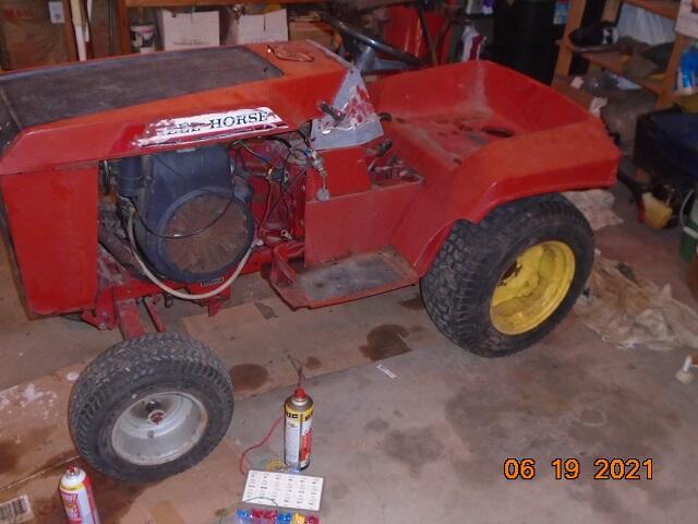

flatlndr 16 #10 Posted June 27, 2021 Hi Randy, I'm out here in Rossville, 30 min nw of Topeka on Hwy 24. Have sold quite a few of my WH's trying to get rid of inventory so kids don't have to. Had a weak moment and needed something to work on. Mistake! This thing will just about need a total rebuild. The engine did fire and sounds pretty good though. Kinda partial to these black hoods. Plastic fenders, why??????? Share this post Link to post Share on other sites

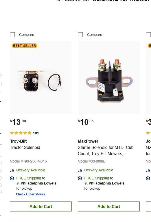

pfrederi 21,043 #11 Posted June 27, 2021 Lowes/ HD sell after market universal garden tractor solenoid for small $ Share this post Link to post Share on other sites

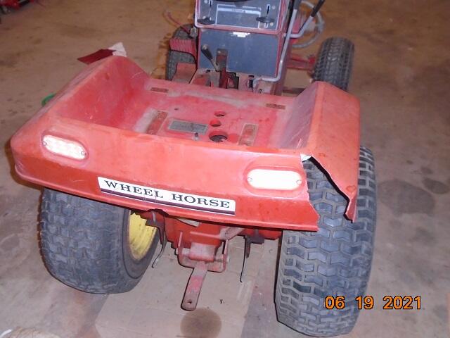

6wheeler 676 #12 Posted June 27, 2021 2 hours ago, flatlndr said: Hi Randy, I'm out here in Rossville, 30 min nw of Topeka on Hwy 24. Have sold quite a few of my WH's trying to get rid of inventory so kids don't have to. Had a weak moment and needed something to work on. Mistake! This thing will just about need a total rebuild. The engine did fire and sounds pretty good though. Kinda partial to these black hoods. Plastic fenders, why??????? That looks like a good project. . You may need to take a look at the rear end. It appears that all of the power is going to the right rear tire. Blew that fender right out. 1 Share this post Link to post Share on other sites
kpinnc 18,884 #13 Posted June 28, 2021 12 hours ago, 6wheeler said: Plastic fenders, why??????? Some executive at WH in the early 80s probably thought they would save money on production. Thank goodness it didn't continue for long. And they look great with metal fenders too! Share this post Link to post Share on other sites
