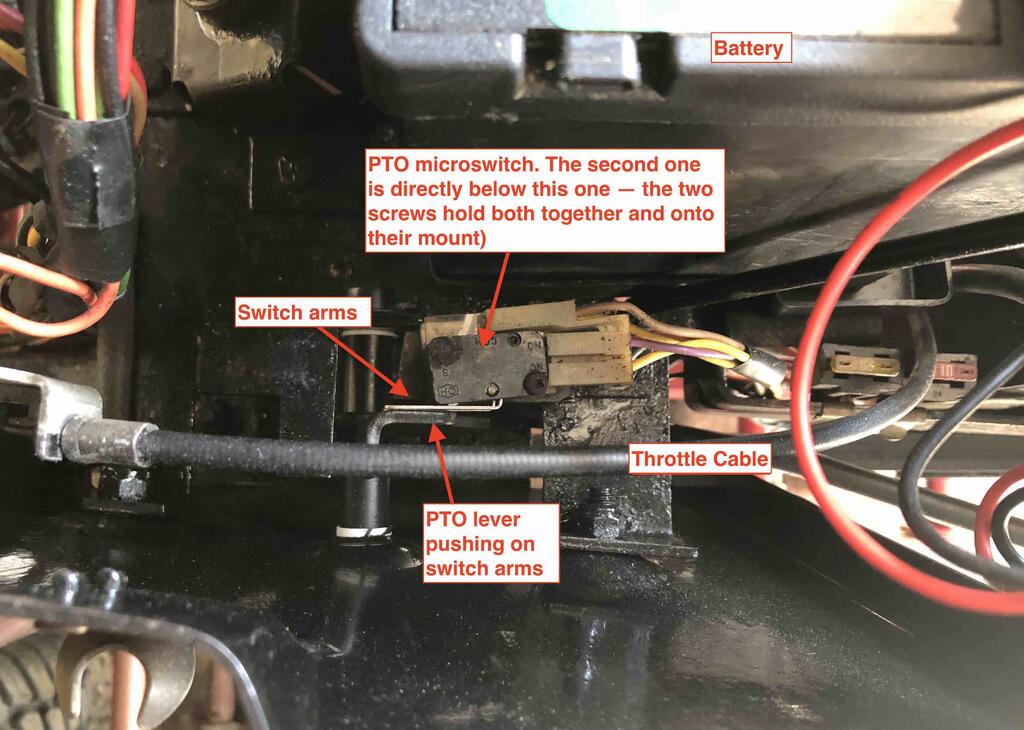

Handy Don 17,193 #13 Posted June 21, 2021 The PTO switches (there are two in a "twinned" arrangement) are just above the pivot point for the lever, inside the hood stand next to the battery. They are not easily seen unless the battery has been removed. Share this post Link to post Share on other sites
Pollack Pete 2,273 #14 Posted June 21, 2021 Ah,just another reason to not allow a woman to get near anything mechanical.I've always found here,that if something here is going to break,the Squaw has usually just been using it.Coincidence???? Maybe.Maybe not.I call her the jinx.She gets mad as hell. 3 Share this post Link to post Share on other sites
Handy Don 17,193 #15 Posted June 21, 2021 PTO switches are here stacked one on top of the other below the throttle cable. 1 Share this post Link to post Share on other sites

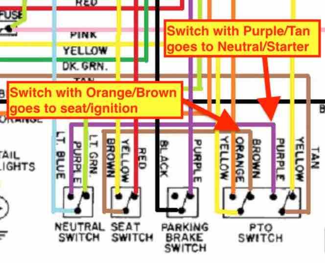

Handy Don 17,193 #19 Posted June 22, 2021 Great! One switch locks out the starter. The other kills the engine if the operator isn't in the seat. Share this post Link to post Share on other sites
porschpow 7 #20 Posted June 22, 2021 Ok, good to know! I am assuming the one that hooks into the seat switch is most likely bypassed. I will trace the wiring to see which switch goes to the starter. Share this post Link to post Share on other sites

Handy Don 17,193 #22 Posted June 22, 2021 I'm a broken record on this, but here goes: please repair broken or non-functional safety switches, remove any bypasses, and do not add any bypasses. It takes only a moment's inattention or a brief distraction to inflict a serious injury on oneself or others. These machines are powerful. One member called the deck the Three Blades of Doom. On some later 520's there is single PTO switch that operates a DPDT relay that then interacts with the seat switch/ignition and the neutral/starter circuits. On earlier models, there are two separate PTO switches for the two circuits. On the latter (like mine), the wiring looks like this: Share this post Link to post Share on other sites
