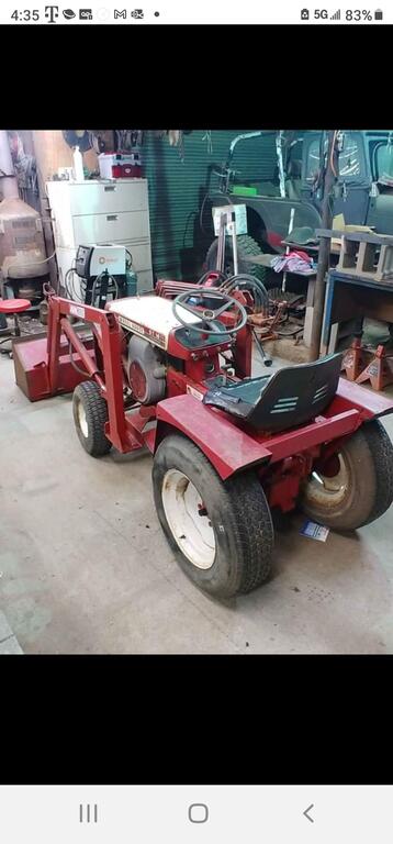

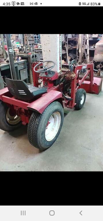

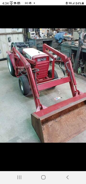

Kuda427 9 #1 Posted June 20, 2021 I've going to look at 70,gt14 with ark loader tomorrow Looks like she is good shape Loader line leak a little as does the rear end..small leak Runs and drives good Only things it's missing for me is a mowing deck He is asking $2k Thoughts? 4 4 Share this post Link to post Share on other sites
c-series don 12,116 #2 Posted June 20, 2021 $2000 is a fair price I’d say. As for as no mower deck I wouldn’t worry about that because switching from the mower deck to the loader is not a ten minute job. For me I’d say once you put the loader on it’s kinda committed as a loader tractor. 12 Share this post Link to post Share on other sites
8ntruck 9,051 #3 Posted June 20, 2021 You will probably want to shop for rear wheel weights, and some weights to hang on the back of the tractor to counterbalance the FEL. 2 Share this post Link to post Share on other sites
953 nut 67,392 #4 Posted June 21, 2021 Without wheel weights or a weight box you will have no traction when you lift a load. Before you spring for it put the bucket against a tree and make sure the rear wheels both spin when in forward and then chain it to the tree and make sure both rear wheels spin in reverse. If the limited slip differential isn't working or the transmission isn't strong you will have some work ahead of you. If that checks out OK this is a very reasonable price. 5 Share this post Link to post Share on other sites

Wheel Horse 3D 3,825 #6 Posted June 21, 2021 Thats a fair price just for a loader. If the GT is in good shape, even if it needs work thats a deal all day long. 1 Share this post Link to post Share on other sites

pfrederi 20,869 #10 Posted June 21, 2021 Looks great!!! Good deal on price also As indicated get some counter weight. Forget using it o mow. Way to hard to get deck on and besides the FEL makes maneuvering difficult. 1 Share this post Link to post Share on other sites

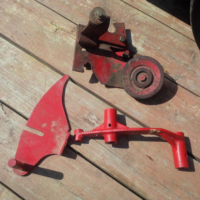

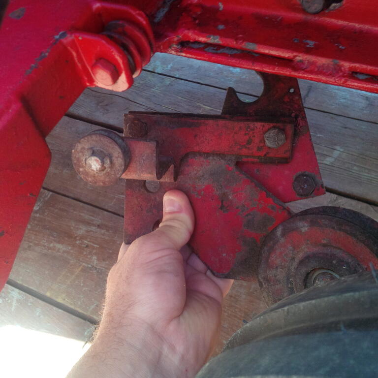

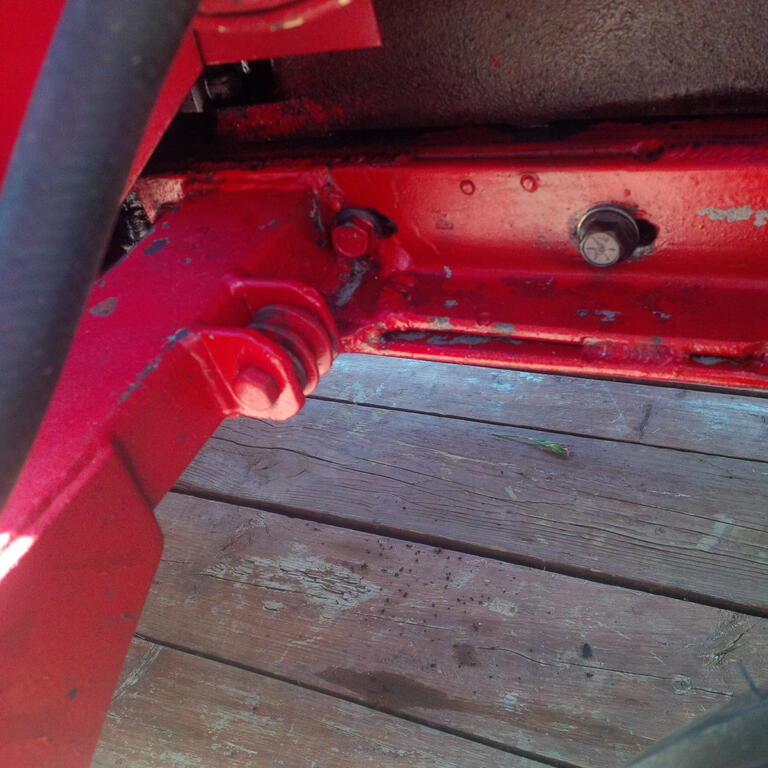

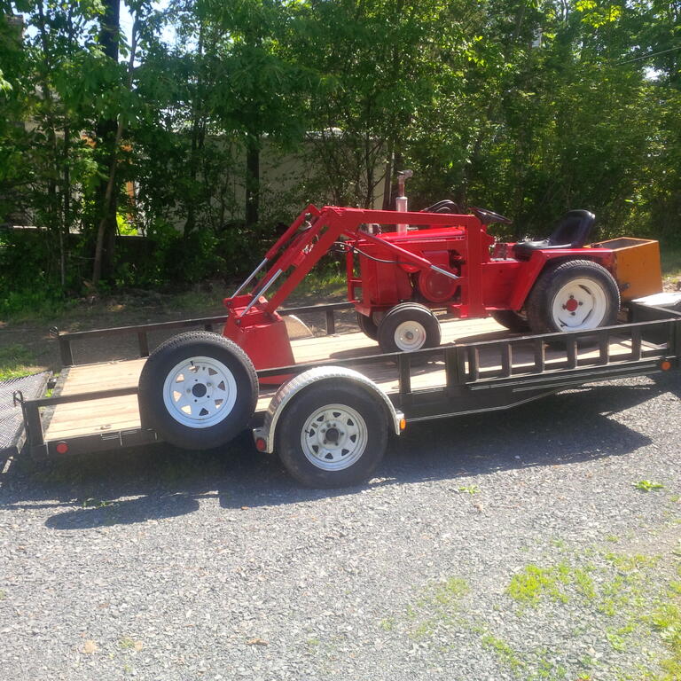

fast88pu 3,393 #11 Posted June 21, 2021 2 hours ago, Wheel Horse 3D said: @c-series don is correct, A swap over from FEL to deck will take ya quite a bit, Now would it be possible to engineer something where you could leave BOTH mounted? Maybe. The pump for the FEL mounts up front and I think in the way of regular mule drive installation. If the mule drive and belts would clear you might be able to run both, then a bit of modification to the center tachmatic at least. For my efforts, my c141 Auto will be a dedicated digger, and I'll invest in something else for mowing. The gt14 is a completely different animal, the mule drive is not out front like a newer c series. The belt goes off the electric clutch and down. So I dug into my gt14 parts and did some mock up to show you guys. You can run a deck and loader at same time! Just the deck will spin when you have to use loader too. The gt14 loader Frame does not hang lower then tractor frame so a mower deck will operate as normal. Here are photos to end the questions. 2 Share this post Link to post Share on other sites
fast88pu 3,393 #12 Posted June 21, 2021 They are tanks and with counter weight you can lift a c series. They are rated to lift 500lbs and will do it. It's the sub compact of their time. To put that in prospective a jd 445 with Fel is rated at 250 lbs lift, A ford 1520 is rated at 700 lbs lift, A new mahindra Emax 20 is rated at 620 lbs lift. So just be careful 2 2 Share this post Link to post Share on other sites

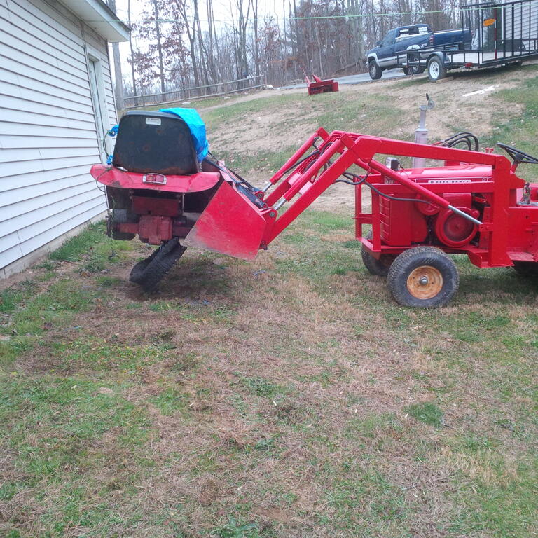

cschannuth 3,821 #16 Posted June 21, 2021 (edited) I have inside wheel weights, ethanol glycol loaded rear tires, and 300 lbs out back and it has been very stable. The first test lift is with about 520 pounds of boys in the video. IMG_5662.MOV Edited June 21, 2021 by cschannuth 1 Share this post Link to post Share on other sites
