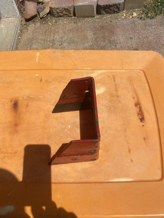

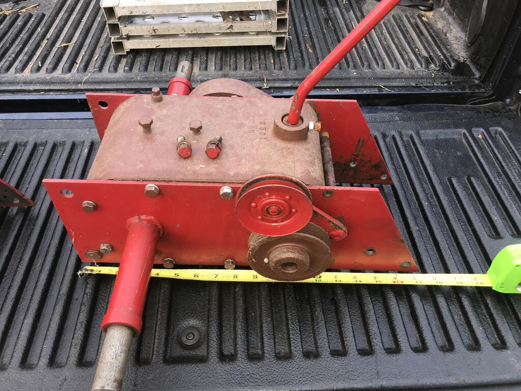

Lane Ranger 12,161 #1 Posted June 19, 2021 (edited) Rodney Burger and I have an RJ transmission we will be rebuilding during the Big Show under our infield canopies! Plus we will have an interesting homemade two piece to three piece transmission conversion plate to look at! Edited June 19, 2021 by Lane Ranger 7 8 Share this post Link to post Share on other sites

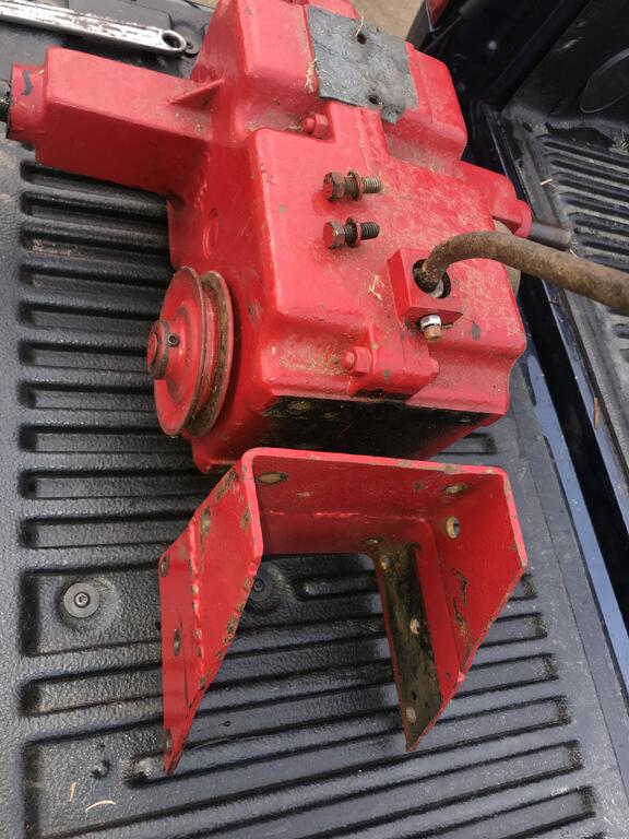

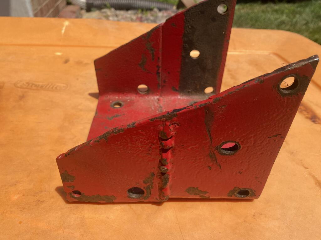

Lane Ranger 12,161 #6 Posted June 19, 2021 (edited) 4 hours ago, stevasaurus said: Out standing Lane. i am going to bring this to show you Steve! The two piece to three piece transmission tractor conversion plate! Should start some conversation in the Red Square guru’s tent! Edited June 19, 2021 by Lane Ranger 1 2 Share this post Link to post Share on other sites

Lane Ranger 12,161 #11 Posted June 19, 2021 (edited) 2 hours ago, AMC RULES said: Would like to make a template of that trans adapter Lane. yes I would like to see someone do a cad drawing with information for others to use this idea on a redo. Good 5003/5010 mushroom/brake gears are starting to to rare! Not remade yet and using a three speed two piece is an alternative. I believe the clutch idler from rj/suburbans can be reused on conversion. The brake to rj/suburban rod would have to be worked out. Probably a suburban idler link and suburban brake to idler rod would do as the brake tab on a two piece transmission is in the same place as a three piece suburban brake side panel. Edited June 20, 2021 by Lane Ranger 1 Share this post Link to post Share on other sites

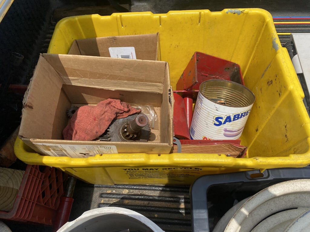

Lane Ranger 12,161 #14 Posted June 27, 2021 Sorry we were unable to do this as parts were missing from the rebuild gears, bear and seals. 1 Share this post Link to post Share on other sites
