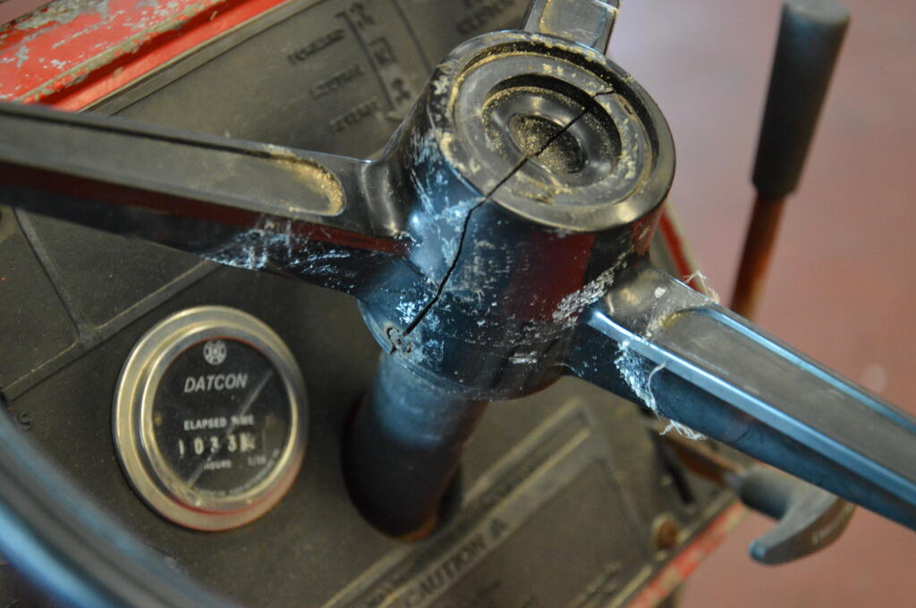

Maxwell-8 4,371 #7 Posted June 14, 2021 Be careful, to not end up with this: Share this post Link to post Share on other sites

chev0545 238 #10 Posted June 14, 2021 7 hours ago, Maxwell-8 said: Be careful, to not end up with this: not good Share this post Link to post Share on other sites
