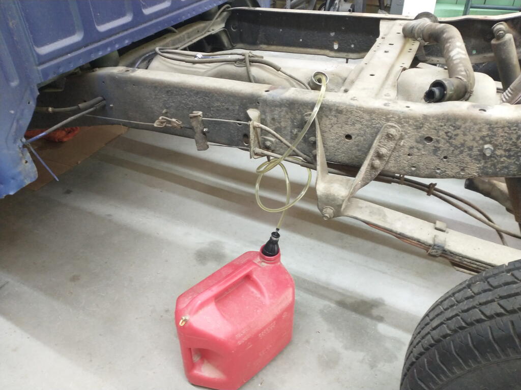

kpinnc 18,960 #102 Posted May 25 You might wanna bungee that tank somewhere. 1 4 Share this post Link to post Share on other sites
ebinmaine 80,694 #103 Posted May 25 21 minutes ago, kpinnc said: You might wanna bungee that tank somewhere. I can't help if you ain't got no sense of adventure. 1 3 Share this post Link to post Share on other sites
MainelyWheelhorse 3,133 #104 Posted May 26 (edited) Just kidding @ebinmaine You did want a HOT rod.... 1 hour ago, kpinnc said: You might wanna bungee that tank somewhere. 1 hour ago, ebinmaine said: I can't help if you ain't got no sense of adventure. Edited May 26 by MainelyWheelhorse 1 5 Share this post Link to post Share on other sites

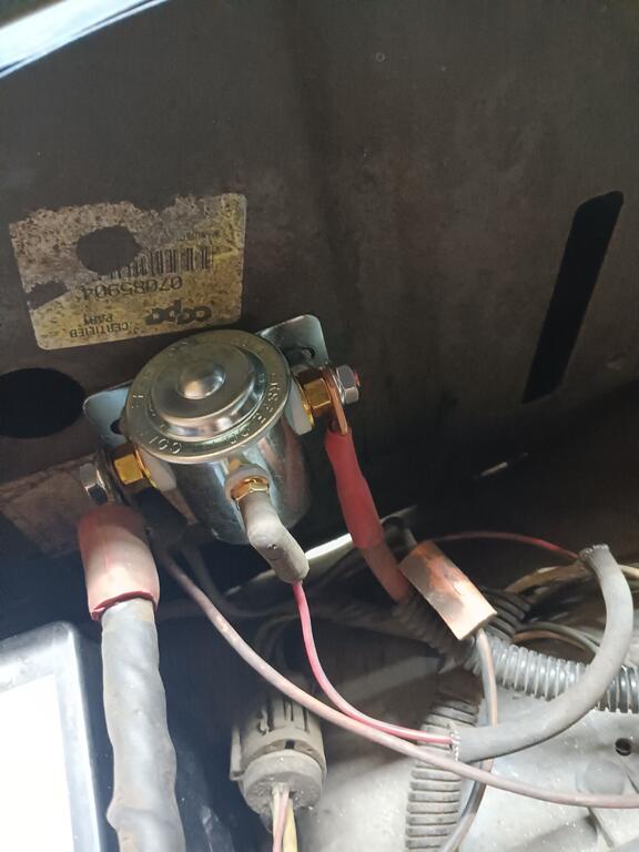

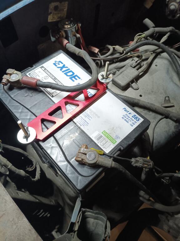

ebinmaine 80,694 #105 Posted May 27 This evening we finished cleaning the cable ends. I built a new positive cable from solenoid to starter. Degreased the starter and engine block where the cables attach. Installed a NOS Cole Hersee solenoid from my parts department. Added a new battery hold down. Used a primer bulb to dump a little gasoline into the carburetor bowl through the upper vent. At that point the ole beast started right up.... and the alternator started smoking. No worries there. I knew that was a high probability. I have a new HD alternator set aside with a new wiring harness. The truck is setting in the front yard waiting to be towed to the repair shop tomorrow. 7 Share this post Link to post Share on other sites

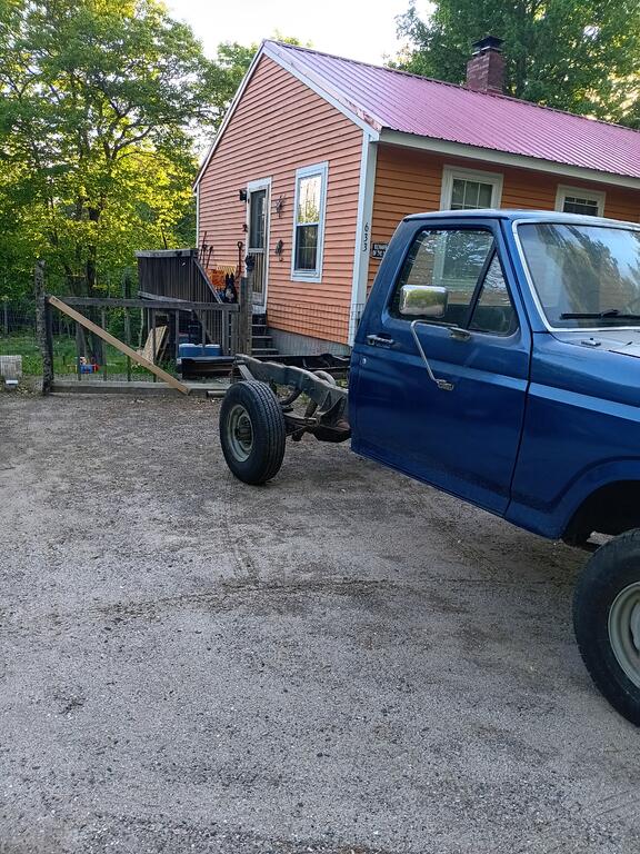

ebinmaine 80,694 #106 Posted June 6 Went to see Libby's Service Station where my truck is... Very positive so far. He's using it as a spare time project in between other things, which is exactly what I hoped he would do. Rick has laid out and organized all the parts, and has some of the initial assembly done. He says it all looks OK so far without having attempted actual installation. I'm bringing them a full set of rear brake shoes, springs, and hardware Monday afternoon. We both figured he might as well go right from wheel to wheel with ALL new parts. 4 Share this post Link to post Share on other sites
ebinmaine 80,694 #107 Posted June 24 Today was another shining example that there are still decent people in this world. While setting for lunch I got a phonecall from Rick Libby. Rear axle done. Truck ready to be picked up so I can install rear lamps and splash guards along with whatever other State Inspection work I find it needs. I said, "Do you have the dollar amount?" Now - let's go over what was done. A BUNCH of cleaning and rust removal. ALL NEW PARTS installed in the entire axle. Center carrier. Change from open Ford to Auburn posi. New bearings pressed in. New ring and pinion. All special tools and knowledge type work. Also: New brakes including all hardware. New U joints. Transfer case rear seal. We have no actual information on how much time he put in. I'm 99% sure it was at LEAST 8 to 10 hours over the 4 weeks he had the truck. Honestly... could be double that. Easy! I was seriously figuring on a minimum count of 20 hours. He billed me for FOUR hours. I had to ask twice if he was OK with that. Turns out.... he was using my old Ford as therapy. Nostalgia. Enjoyment. So it's scheduled to be towed back up here tomorrow morning. Next steps will be rear lights and swapping the alternator type. This diagram is for my own notes. 8 1 Share this post Link to post Share on other sites

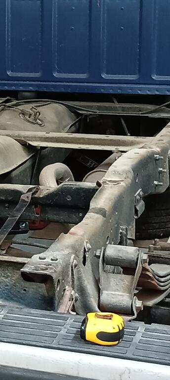

ebinmaine 80,694 #109 Posted June 26 Looking at the end of the rear frame it's basically a C channel. It measures just under 6" tall. Width is maybe 2 inches? I want to extend the length approximately 13", 14". I also want to make the steel wider top and bottom for better support of the trailer hitch. I'm thinking something like this 4 x 6 box steel might work. I can tack it in but I'd have a professional welder do the final attachments. 1 Share this post Link to post Share on other sites
Handy Don 17,474 #110 Posted June 26 I’m no expert, but don’t truck frames get specific treatment for hardness and ductility? I’d want to be sure an “extender” really knows the ins and outs. Share this post Link to post Share on other sites
ebinmaine 80,694 #111 Posted June 26 1 minute ago, Handy Don said: I’m no expert, but don’t truck frames get specific treatment for hardness and ductility? I’d want to be sure an “extender” really knows the ins and outs. Heavy truck frames, yes. They can NOT be welded. This frame is not heat treated so welding is fine. 1 Share this post Link to post Share on other sites
8ntruck 9,296 #112 Posted June 26 4 hours ago, ebinmaine said: Heavy truck frames, yes. They can NOT be welded. This frame is not heat treated so welding is fine. Idle thoughts on this subject: This probably depends on where the weld is on the frame. Welds are stress concentration features. They create hard spots, notches, and divots. If the weld is located in a low stress area of the frame, probably no problems. Truck frames are subjected to unpridictable, varying, and cyclic loads - the sort of loading condition that fatigue cracks can grow in. If the weld is located in a high stress area on the frame, it could provide a spot for a fatigue crack to start. Grinding the weld smooth and/or shot peening it will reduce the chances of a crack initiation site. I've never done any analysis work on frames, so I don't know where the high stress areas are. I'll guess that they are at the attachment points for the suspension and maybe at the attachment points for the cross members. A lot of long box pickup frames have been cut down into short box frames. Maybe something to learn from this process? 1 1 Share this post Link to post Share on other sites
ebinmaine 80,694 #113 Posted June 27 20 hours ago, 8ntruck said: Idle thoughts on this subject: This probably depends on where the weld is on the frame. Welds are stress concentration features. They create hard spots, notches, and divots. If the weld is located in a low stress area of the frame, probably no problems. Truck frames are subjected to unpridictable, varying, and cyclic loads - the sort of loading condition that fatigue cracks can grow in. If the weld is located in a high stress area on the frame, it could provide a spot for a fatigue crack to start. Grinding the weld smooth and/or shot peening it will reduce the chances of a crack initiation site. I've never done any analysis work on frames, so I don't know where the high stress areas are. I'll guess that they are at the attachment points for the suspension and maybe at the attachment points for the cross members. A lot of long box pickup frames have been cut down into short box frames. Maybe something to learn from this process? All good points and your guesses seem to align with other folks' information. To weld two frames together there are of course, methods for grooving the weld by chamfering the edges combined with adding diamond shaped braces inside and out of the vertical parts of the frame. There can also be long thin braces added to the top and bottom of the frame. I'd prefer to avoid the frame stretching. I want to keep the bed build as simple as possible. When I get time next week I'll take some tractor size measurements on the Herd. I'm thinking I can put 3 of Trina's smaller tractors on the truck with an 8 foot long flat bed. That leaves room on the big trailer for six. 1 Share this post Link to post Share on other sites
ebinmaine 80,694 #114 Posted July 1 I've decided to postpone the frame stretch for now. The idea was to have the capability of hauling 3 C series tractors on the bed and I also really liked having the extra length of the 9 foot platform on my '99 F350. Need?.... no not really. I can make an 80" - 84" wide bed and still fit 2 C series tractors sideways or 3 of Trina's mid 1960s short frames. On the trailer hitch, she and I were looking over the mounting surface yesterday evening. We knew there are a couple holed to be welded shut and moved. I got to looking at the existing hitch a few weeks ago. It has a rating of 5000 lbs with no weight distribution, 7500 with. That's actually under rated for the capabilities of the truck so I'm ordering a new Class V hitch. 1 Share this post Link to post Share on other sites

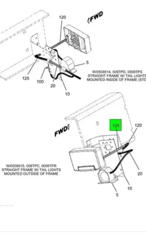

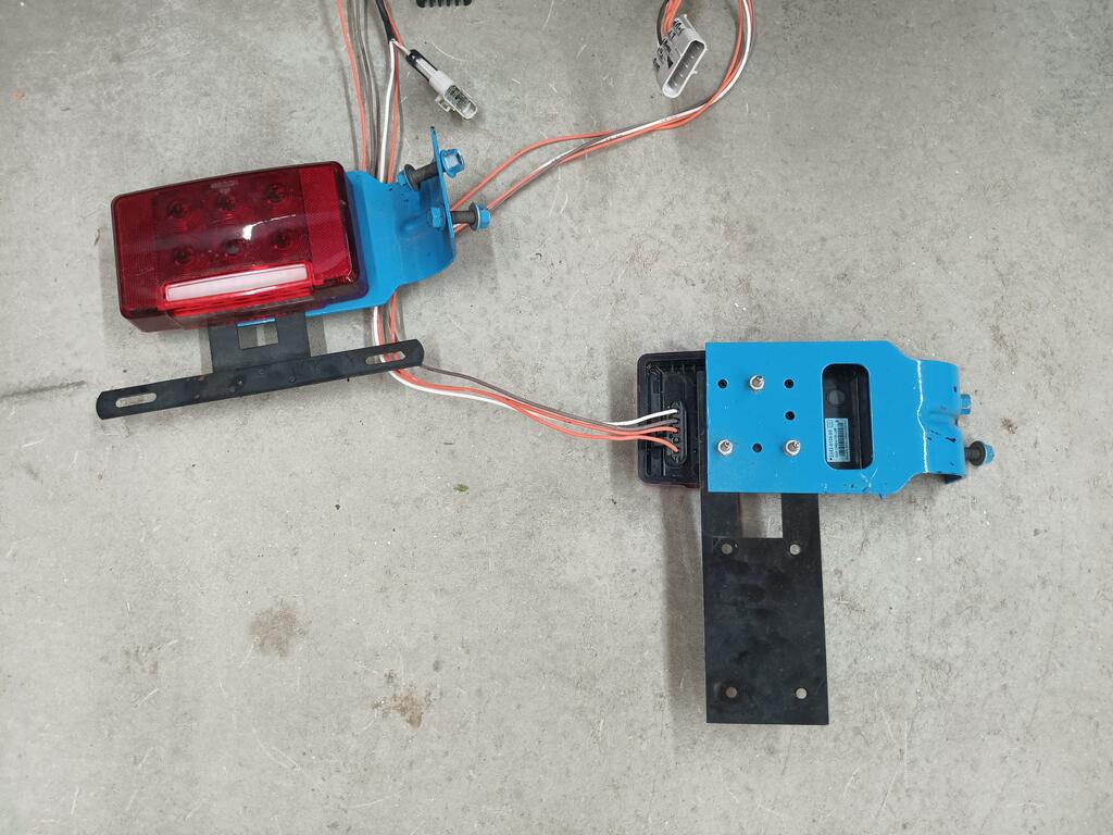

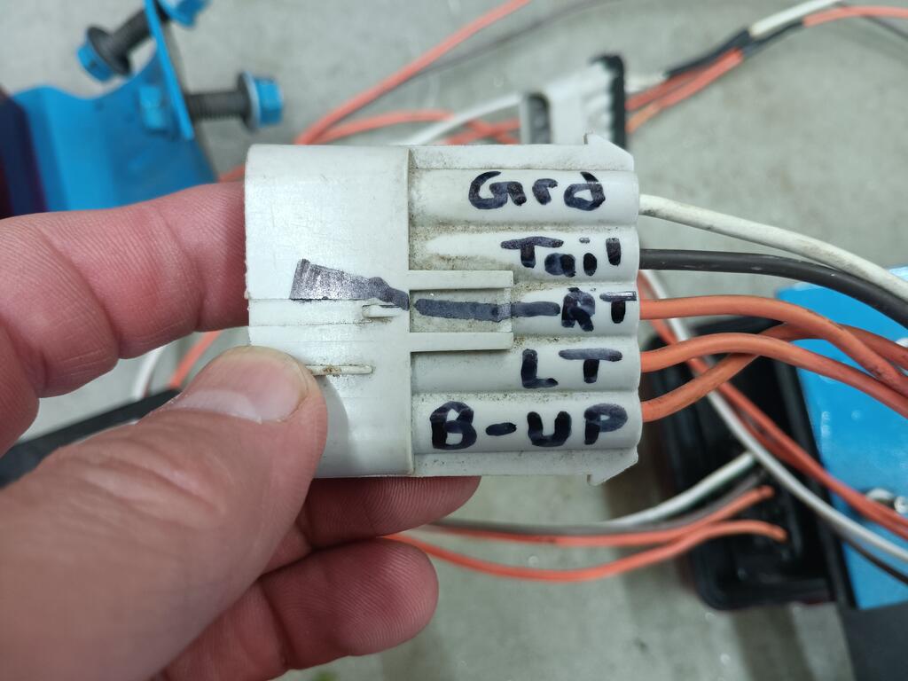

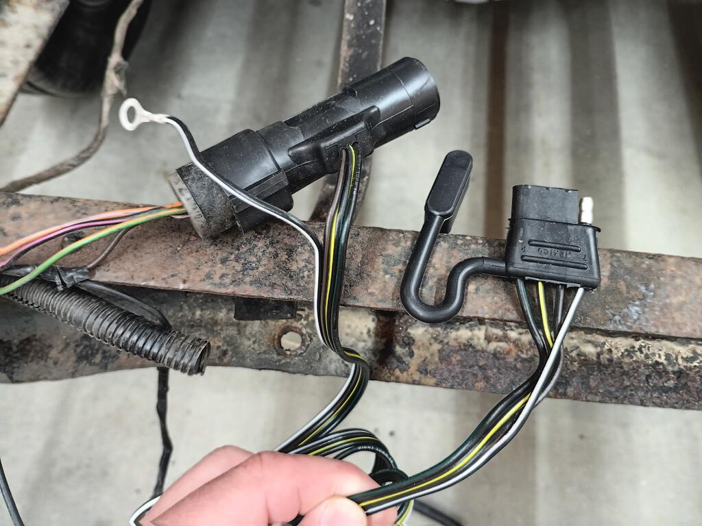

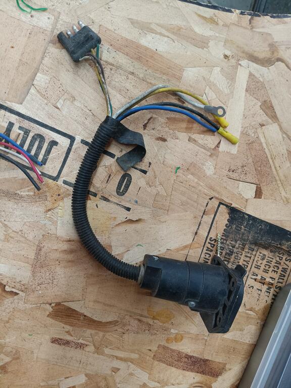

ebinmaine 80,694 #115 Posted July 4 Several years ago I was given a set of new take-off rear lamps from an IHC tractor chassis that was being built into a dump truck. These would have bolted to the frame (inside or outside of) depending on the customer's intentions of use. The dump chassis specs didn't fit the usage so these were removed. Today I used online search info to determine the most likely ground wire color and tested the units. All good. Notated the wires. I'm hoping to keep the original Ford factory wiring harness in place. This Tekonsha plug in adapter should get me the connections I need so I can splice the aftermarket lights in. Also found a 7 way plug and trailer brake controller in the parts box. I need to confirm that the 7 way is the correct style. 2 1 Share this post Link to post Share on other sites

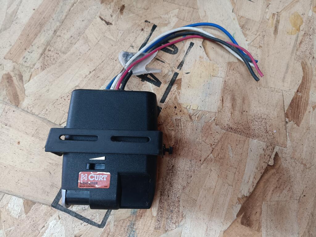

wh500special 2,461 #119 Posted July 15 On 7/4/2026 at 4:14 PM, ebinmaine said: Not to sound too critical or to be too eager to spend your money, but I'd suggest a proportional controller over that time-based unit. Proportional controllers offer more natural and progressive braking and overall a much more pleasant driving experience with a braked trailer. They might be safer too since they can really squeeze the trailer brakes quickly and tighter in a panic stop rather than waiting for them to ramp up over time. Steve 1 Share this post Link to post Share on other sites
ebinmaine 80,694 #120 Posted July 15 6 minutes ago, wh500special said: Not to sound too critical or to be too eager to spend your money, but I'd suggest a proportional controller over that time-based unit. Proportional controllers offer more natural and progressive braking and overall a much more pleasant driving experience with a braked trailer. They might be safer too since they can really squeeze the trailer brakes quickly and tighter in a panic stop rather than waiting for them to ramp up over time. Steve That's good info and I'll definitely consider it. I'll see what I can find online. This is one that I've had for probably 20 years or more. 1 Share this post Link to post Share on other sites

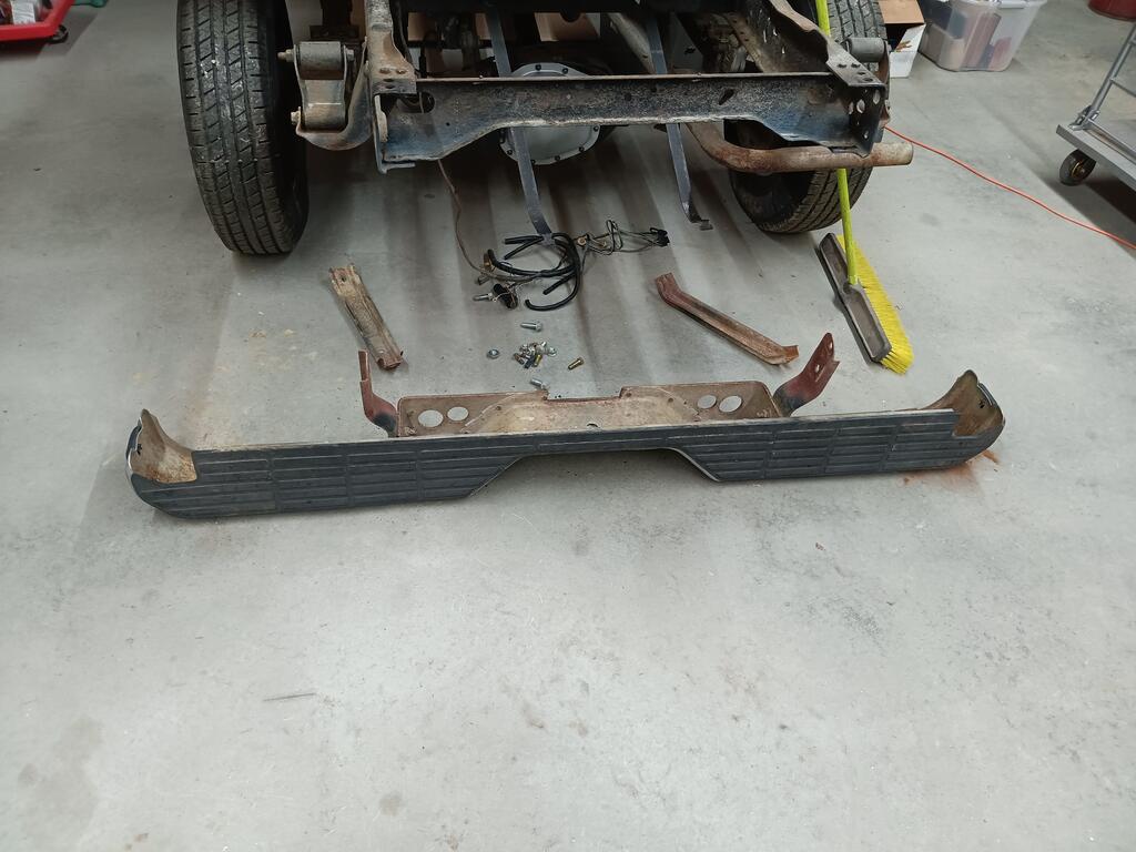

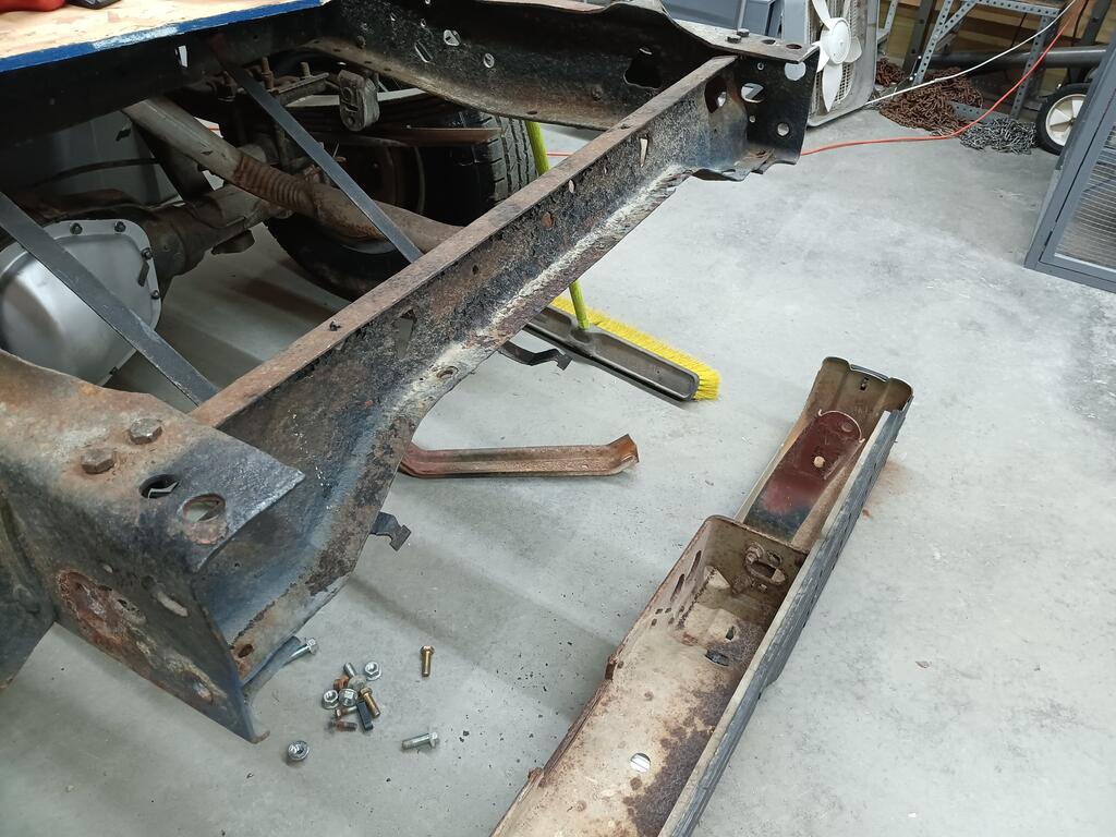

ebinmaine 80,694 #121 Posted August 16 Rear bumper is off. That won't go back on. Rear crossmember is loose. That will be replaced because it's thin but I am leaving it in for now so that the frame spacing stays correct while I install the trailer hitch. Share this post Link to post Share on other sites
adsm08 5,145 #122 Posted August 16 On 7/15/2026 at 1:32 PM, ebinmaine said: That's good info and I'll definitely consider it. I'll see what I can find online. This is one that I've had for probably 20 years or more. I have been using this one in my Explorer for a few years and have been quite happy with it. So far the worst thing I have to say about it is the mounting tape doesn't hold up to summer very well. https://www.easternmarine.com/insight-universal-brake-controller-47297 1 Share this post Link to post Share on other sites

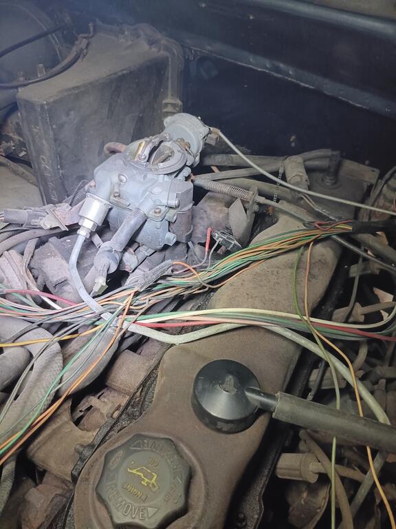

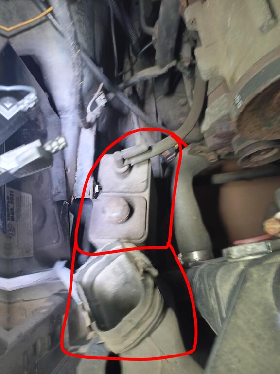

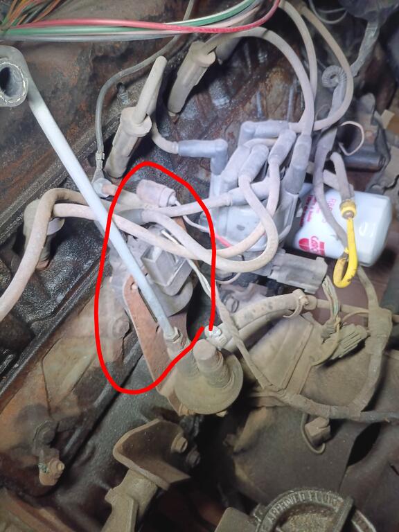

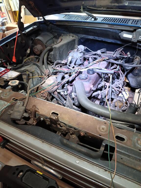

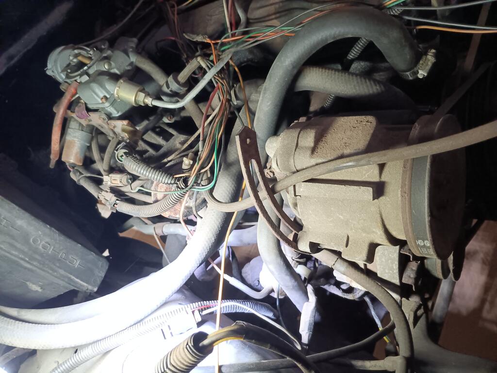

ebinmaine 80,694 #123 Posted August 16 (edited) Major changes coming in the engine compartment as well... over the next few months. Yesterday I started sorting out the needed wires from the future usage. Before - ish. ALL of these wires and vacuum lines will be removed. There's one yellow and one black wire that'll be moved to going across the back of the firewall so they are NOT laying across the engine. Same wires, different view. Also, this Air pump and all it's related hoses, pipes, sensors and wires are coming out. This evaporation canister and air cleaner inlet were already dysfunctional so they're being removed. This distributor is being changed to a GM HEI style. The coil in the red circle will also be removed. The fuel pump is just outside the red circle. I'm not sure if I'll leave that or swap to an electric pump yet. It works OK but they have a high failure rate. Edited August 18 by ebinmaine 2 1 Share this post Link to post Share on other sites
