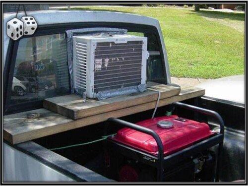

Achto 31,135 #8 Posted June 8, 2021 You could always take the easy route. 3 1 7 1 Share this post Link to post Share on other sites
squonk 45,630 #9 Posted June 8, 2021 25 minutes ago, Achto said: You could always take the easy route. Did Jim let you take that pic? I can't believe he did that to that new truck! 3 Share this post Link to post Share on other sites

ebinmaine 77,554 #14 Posted June 8, 2021 5 hours ago, Achto said: You could always take the easy route. I couldn't possibly be low balled into such primitive behavior. Duct tape??? Oh no no no no no The BBT and I have moved up to black Gorilla tape!!!!! Man... I hate to even write this but it's true: My Ole Man had a (Isuzu??) Cabover truck. 16 foot cargo box. AC worked but just couldn't keep up with that giant cab and window in the sun. He did. Literally. Install a small room AC connected to an inverter. Just. Like. Above. Right where there was a back window. Have to admit it worked some kinda better than the truck AC. 1 1 1 Share this post Link to post Share on other sites
elcamino/wheelhorse 9,363 #15 Posted June 8, 2021 Why you all making fun of the AC unit truck window. Redneck engineering , plus you don't have to clean the rear window. 3 1 1 Share this post Link to post Share on other sites
squonk 45,630 #16 Posted June 8, 2021 11 minutes ago, elcamino/wheelhorse said: Why you all making fun of the AC unit truck window. Redneck engineering , plus you don't have to clean the rear window. You silly goose! If he was to do it the right way, he would have installed a mini-split! 3 Share this post Link to post Share on other sites
ebinmaine 77,554 #17 Posted June 8, 2021 27 minutes ago, elcamino/wheelhorse said: Why you all making fun of the AC unit truck window. Redneck engineering , plus you don't have to clean the rear window. ^^^^^ ^^^^^ Have to admit the man has a point 1 Share this post Link to post Share on other sites
lynnmor 8,651 #18 Posted June 8, 2021 47 minutes ago, ebinmaine said: I couldn't possibly be low balled into such primitive behavior. That is actually a high end unit, apparently you haven't priced 2 x 10s lately. 3 1 Share this post Link to post Share on other sites
ebinmaine 77,554 #19 Posted June 8, 2021 26 minutes ago, lynnmor said: That is actually a high end unit, apparently you haven't priced 2 x 10s lately. Okay. Okay. You're right. I hadn't even given consideration to the price of the dimensional lumber involved. 1 Share this post Link to post Share on other sites

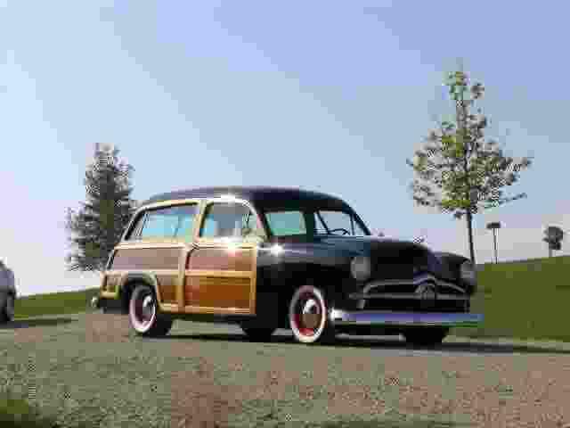

305 380 #20 Posted June 8, 2021 back when i was building hot rods professionally i always used Vintage Air and had very good luck 1 Share this post Link to post Share on other sites

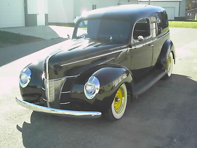

305 380 #22 Posted June 8, 2021 both of these cars i installed Vintage Air 1 4 Share this post Link to post Share on other sites
