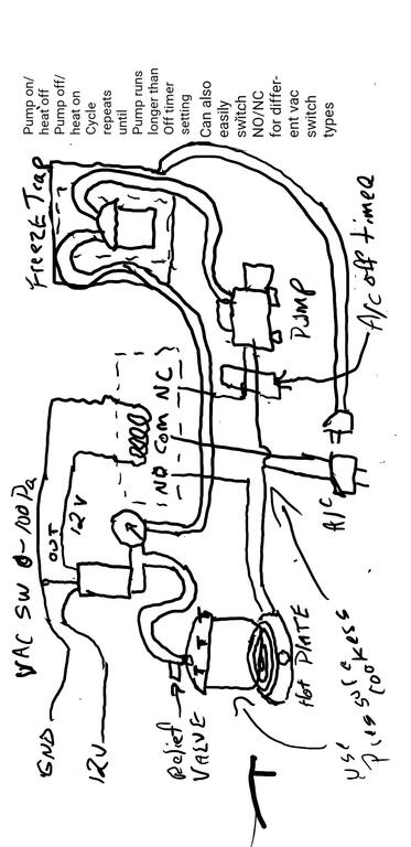

Wheel Horse 3D 3,822 #27 Posted May 11, 2021 (edited) Heres a schematic i did up at one point for the general layout and control circuits for the freeze dry system. The text at the side should be corrected"untill pump stays OFF longer than off timer setting" the hot plate should have been on for an hour or 2 without the pump kicking on. Thats when the timer should kick the system A/C off and signal DONE! Edited May 11, 2021 by Wheel Horse 3D Share this post Link to post Share on other sites
