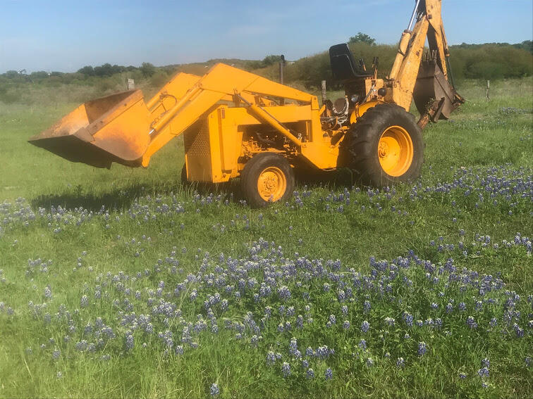

oliver2-44 11,718 #9 Posted June 7, 2021 @seuadr I appreciate if you would post or message me the contact information about the Texas place that has parts. I have an Oliver 2-44 loader backhoe that essentially is a Oliver 550 with an industrial front end. I need some power steering cylinders. Due to the design I can't find a hydraulic shop that will cut, rebuild them and weld them up. PS would love to see your Oliver! Share this post Link to post Share on other sites

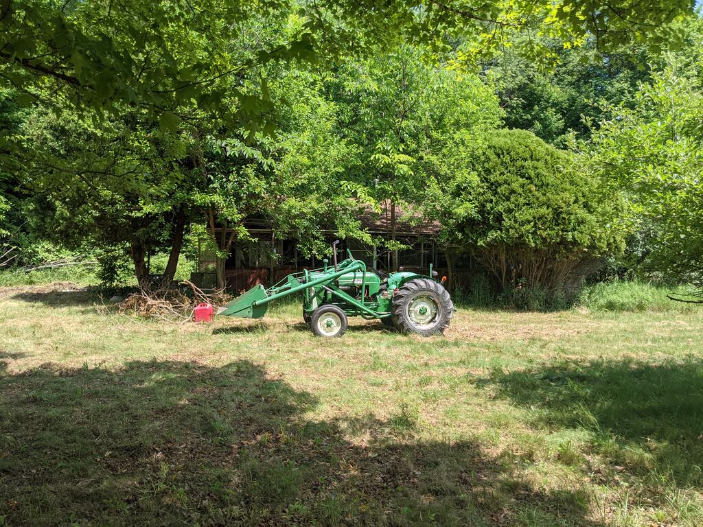

seuadr 490 #12 Posted June 7, 2021 this is from a couple of years ago, because it is POURING rain right now - looks just like this though, just with less snow and and currently no steering wheel. 3 1 Share this post Link to post Share on other sites

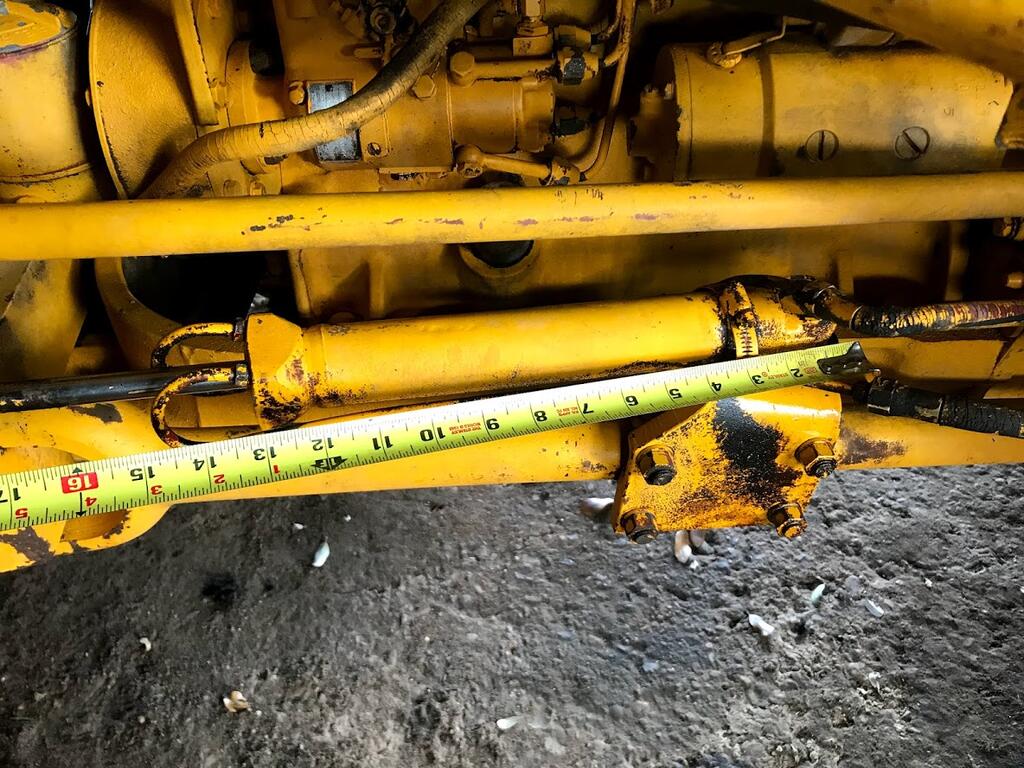

oliver2-44 11,718 #15 Posted June 8, 2021 @seuadr Under the loader industrial front end, my Oliver looks just like yours. Does your 550 have the power Assist steering cylinders like this. While searching for replacements I've read they are the same ones as use don some year corvett. But no one could say what year vet? 2 Share this post Link to post Share on other sites

seuadr 490 #17 Posted June 8, 2021 8 hours ago, oliver2-44 said: @seuadr Under the loader industrial front end, my Oliver looks just like yours. Does your 550 have the power Assist steering cylinders like this. While searching for replacements I've read they are the same ones as use don some year corvett. But no one could say what year vet? no unfortunately (or i guess in the case of the steering components, fortunately) i have manual steering. though, to be fair - i don't use it for anything that really NEEDs power steering, my loader is meant for manure, not actually heavy things when i looked into how complicated/expensive the conversion might be last fall i found some info that said pre 1964 ford tractor power steering rams would also work as they used the same steering components - which i guess i can confirm for the steering box today as that is what is going in it. i also read that New Jacobsen 153233 was the same dimensions. Share this post Link to post Share on other sites
oliver2-44 11,718 #18 Posted June 9, 2021 Thanks I’ll look into the Ford parts option 1 Share this post Link to post Share on other sites

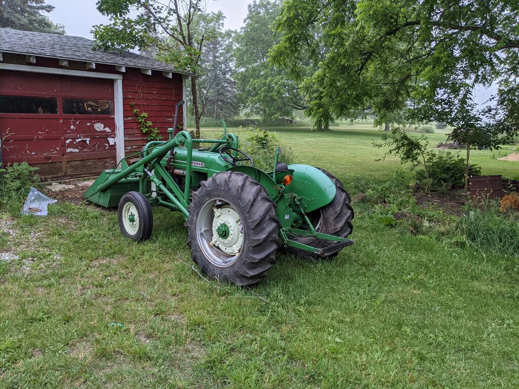

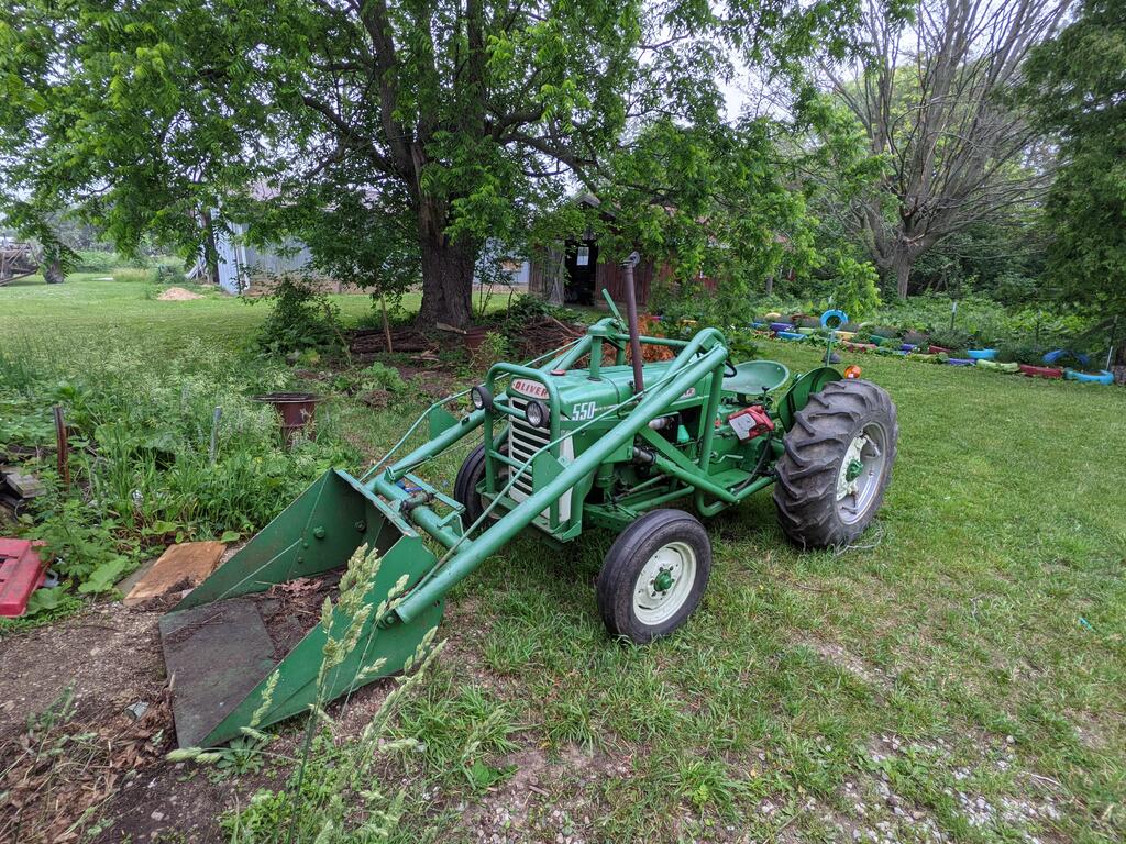

seuadr 490 #21 Posted June 12, 2021 As requested, here are some pics! Share this post Link to post Share on other sites
seuadr 490 #22 Posted June 12, 2021 Looks good next to my future shop! Share this post Link to post Share on other sites
oliver2-44 11,718 #23 Posted June 13, 2021 @seuadr Thanks for the pictures. Interesting you rear fenders have "Oliver" stamped in them, mine don't. You also have the Ag row crop spin out rims., mine being an Industrial has fixed rims. Of course mine is a few years younger as it has "White Oliver" decals on it. Unfortunately my model/serial number is missing. 1 Share this post Link to post Share on other sites
