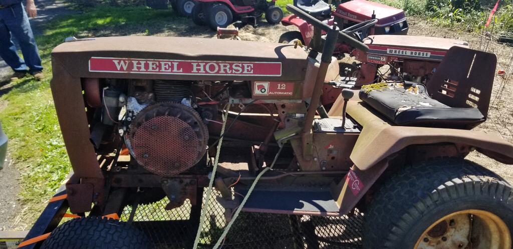

gt14rider 1,275 #1 Posted June 6, 2021 Good afternoon, Started messing with my 73 no name, wiring in rough shape. jumped starter, motor turns over, will not turn over with key. Checked key switch,believe to be wrong , it has a M terminal, not a I (eye ) terminal. Should have been a 92-6785 (101917) having trouble finding , stems doesn't make one, anyone know of a good (cheap) one. Thanks Share this post Link to post Share on other sites

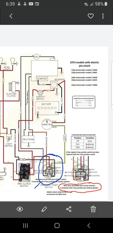

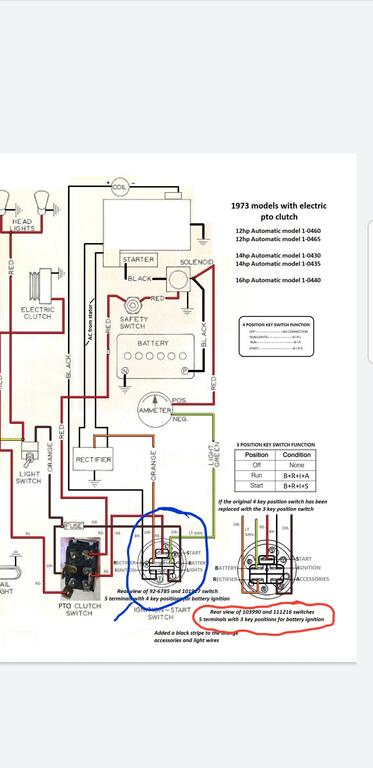

gt14rider 1,275 #4 Posted June 6, 2021 Thanks. 1 hour ago, squonk said: I think the 73 had the extra key position fr lights which you don't need. Toro #103990 should work. I got to get out of this haze. The wiring schematic I have has the switch update with the 103990#. I was looking at pictures not reading. Thanks. EB, found one for 20 bucks, will have to switch some wires around .I don't like cheap switches either but Started looking for a 101917 or 92-6785 some were $30 to $60. Payed under $50 for the tractor. Thanks again for the replys. 2 Share this post Link to post Share on other sites

gt14rider 1,275 #7 Posted October 24, 2021 Yes put in a 103990,got on line for $20. Just wire like schematic circled in red. Had a 4 position new switch is a 3 position, works fine 1 Share this post Link to post Share on other sites
