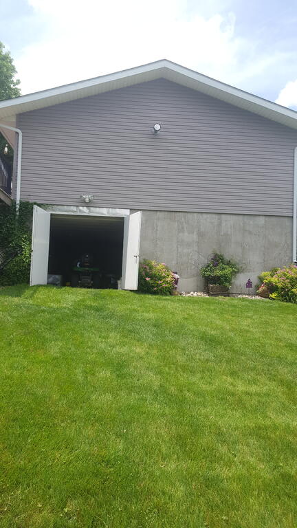

Gregor 4,848 #10 Posted June 6, 2021 I want an AC unit in my garage. I thought this might bee the simplest way. I guess I will go with a unit through the wall. The main trouble is, the best place for the unit is on the gable end, east wall, and that's about 14' up. I have a 6' baker scaffolding, that aint gonna cut it. Share this post Link to post Share on other sites

clueless 3,406 #16 Posted June 6, 2021 1 hour ago, Gregor said: I know there are a lot of factors to consider, but how many BTU is required for 770 sq. ft.? I have no windows. 1 walk in door w/window. 3 1/2" insulated walls, Insulated garage door. 12" fiberglass in ceiling. With no windows and one door with the insulation you have a 12000 to 14000 btu would probably work, but even the largest portable would not work. The next problem is, you say the best place to put one is at the gable end 14' up. Now your not just cooling 770 sf but 770 sf with a height of 14', that's a lot of cubic feet of hot air to cool and keep cool. Since hot air rises the unit would be working hard just to keep the air up there cool much less the air down where you want it. My neighbor's shop (man cave), is a little over 350 sf with a 9' ceiling and well insulated. We installed a 7000 btu unit through the wall about 2.5' above the floor, it stays cool even during Dog Days down here. Share this post Link to post Share on other sites
Gregor 4,848 #17 Posted June 6, 2021 (edited) 1 hour ago, clueless said: Now your not just cooling 770 sf but 770 sf with a height of 14', No, my ceiling is still only 8" high. My garage is 8" off the ground. My lot is sloped. The "Barn" Edited June 6, 2021 by Gregor Share this post Link to post Share on other sites

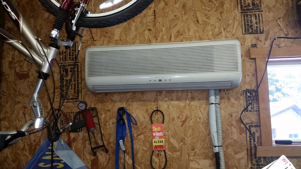

WHX?? 56,853 #23 Posted June 9, 2021 (edited) What's in my shop ..... this was a tear out that was too small in a waste water treatment plant office. It was a cheapy and not real efficient. 1 ton or 12,000 btu and more than adequate for my 768 sq ft. I also did some Tim Taylor mods to it to make help it run better. Before I retire a better one is goin to "fall off" a truck. Edited June 9, 2021 by WHX24 2 2 Share this post Link to post Share on other sites
