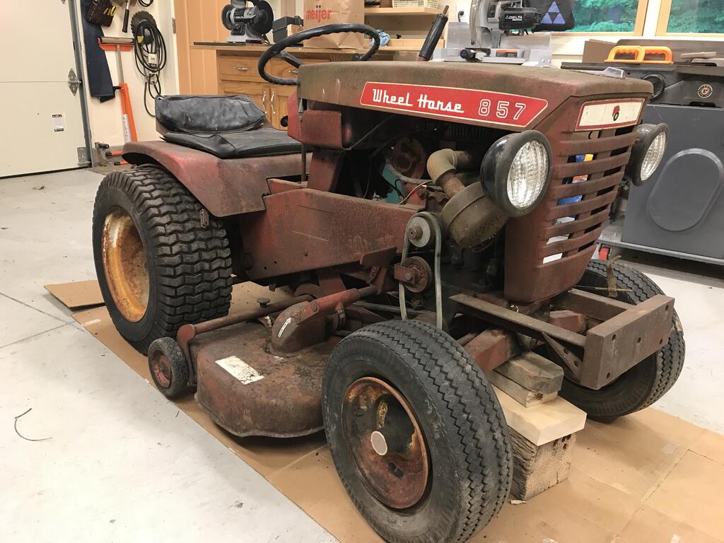

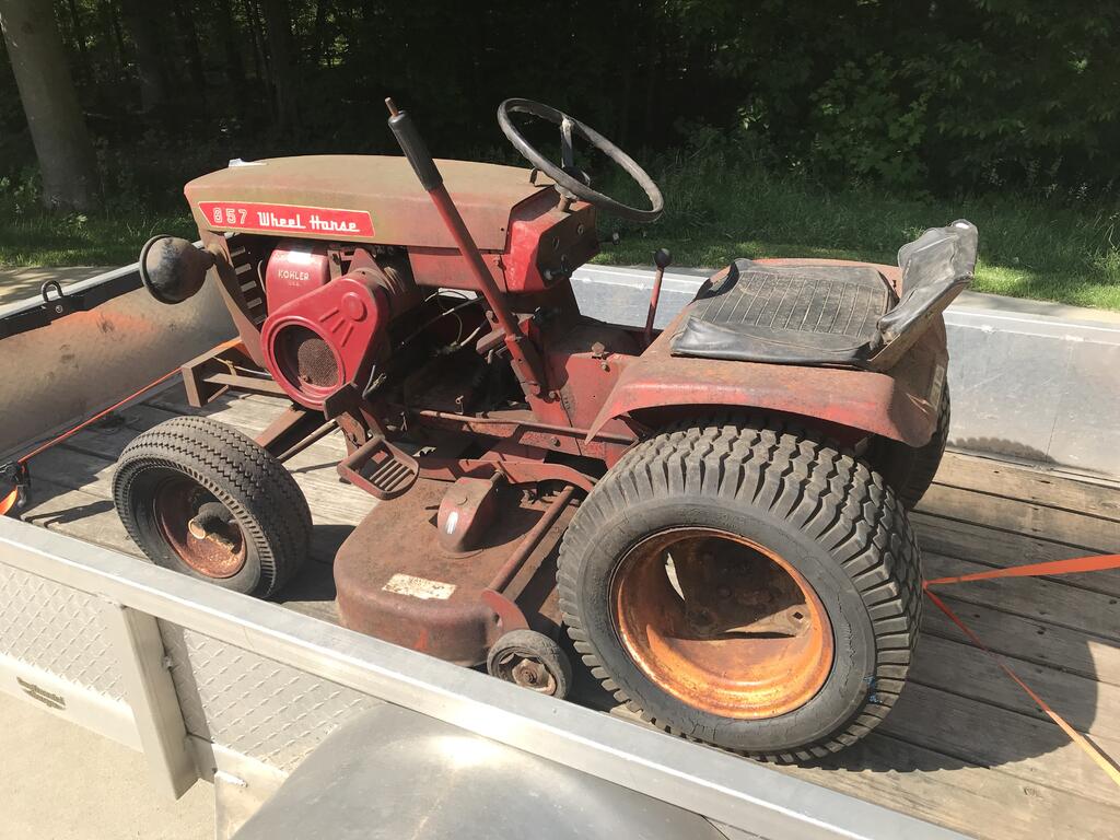

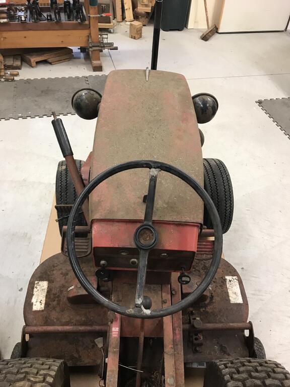

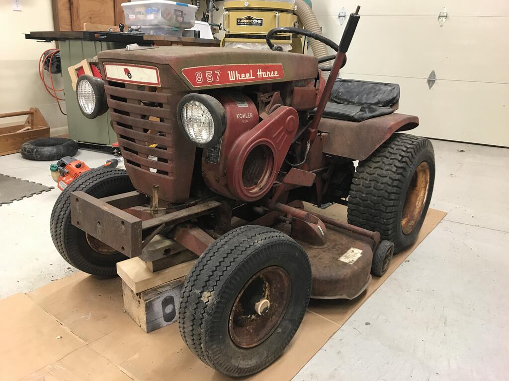

Bentoolong 94 #1 Posted June 2, 2021 I just picked up this little jewel yesterday. I like the looks of the 857 and have been looking for one for a bit. It seems quite complete. It has the original lighter still in the dash (missing in the pics). The deck has some rust issues and it is frozen solid. I have not heard this run so that will be a priority along with the tire issues. All of the tires seem like original. All have "Wheel Horse" molded into the tire. I think 3 have tubes. I may be at a point in my tractor work that it might be good to find a solution for removing tires. I have previously done two tires with just tools I have around (screwdriver and such). These tires are rather brittle and cracked and I doubt I could get a tire place to look at them. There seems to be a lot of rust in the tire that I'd like to get out so I'd like to remove the tire and tube from the rims. What do people do to remove tires? I see HF has a bead tire tool for $40. Maybe get some tire spoons? Recommendation? The steering wheel is barely attached. I be those are hard to find. Any repair suggestions? I'm sure I'll have more questions as I go through this. Tell me about the lights. They are not connected but look great. They kinda grow on your and couple those with the home made bumper and this little tractor shows some "attitude". Interesting story. I pulled out a lot of the mouse crap from under the seat. After getting most of it by hand I got the vacuum going in there. At one point I heard a loud crack that you hear when something solid hits the little baffle in the vacuum. I thought I better check it out so I shut the vacuum off and opened it up, there laid the center pice for the steering wheel. 8 Share this post Link to post Share on other sites

Maxwell-8 4,371 #3 Posted June 2, 2021 30 minutes ago, Bentoolong said: What do people do to remove tires? I see HF has a bead tire tool for $40. Maybe get some tire spoons? You got yourself a nice project. Something about it I really like, certain charm. The 12 inch rears will fit on most car tire machines and that is what I use. And for the 6 and 8 inch rims.... two pry-bars. Going to buy myself such a bead tire tool. Share this post Link to post Share on other sites
Achto 32,633 #4 Posted June 2, 2021 38 minutes ago, Bentoolong said: What do people do to remove tires? I see HF has a bead tire tool for $40. Maybe get some tire spoons? Recommendation? For $40 Harbor Freight has this complete tire changer that works great for the rear tires. The bead breaker on it will work for the fronts but you will probably need spoons to change the tires. This changer is handy to have around for trailer tires, car tires, etc. At $40 you only need to change a few tires for it to pay for it's self. https://www.harborfreight.com/manual-tire-changer-69686.html 1 Share this post Link to post Share on other sites

OldWorkHorse 3,156 #6 Posted June 2, 2021 I use the HF mini tire changer for the fronts and the large HF changer for the rears with sum tire spoons. Makes easy change. If I have the money and I'm lazy I toss my budy a few bones to do them at his work on a car tire machine. That way is really easy haha 4 Share this post Link to post Share on other sites
ebinmaine 80,638 #7 Posted June 2, 2021 (edited) 18 minutes ago, Achto said: For $40 Harbor Freight has this complete tire changer that works great for the rear tires. The bead breaker on it will work for the fronts but you will probably need spoons to change the tires. This changer is handy to have around for trailer tires, car tires, etc. At $40 you only need to change a few tires for it to pay for it's self. https://www.harborfreight.com/manual-tire-changer-69686.html That's all of what I was going to recommend right there. At the recommendation of someone else on this site I picked up a 3/4" bolt about 10" long. Got a pile of washers, nuts and wing nuts with it. That can be used to hold the front wheel in place if you have a vise handy. I agree with you on the lights. I like the look. That front bumper looks like it was put there specifically to add weight. A good idea. Edited June 2, 2021 by ebinmaine Share this post Link to post Share on other sites
ACman 7,741 #8 Posted June 2, 2021 (edited) Great score there Mark . Oh no the dreaded steering wheel . Lots of threads on that subject . Some closeup pictures would help us out with a fix or replacement . Place a wanted ad and in the big show buy sell thread of your wants . I’m sure there’s someone who can get your stuff back to you . There’s also A&Z tractor who’s a vendor here . What’s the plan for your seat ? I’ve been trying to get a short back pan for three years . I have one of Bob’s seat covers that needs a home (my 520 Wheel-a-Matic) . The Harbor Freight tire changer will work and the do have tire irons too . I prefer a tire spoon with drop center . Used this style for years at the dealership . https://www.fleetfarm.com/detail/ken-tool-single-end-tire-spoon-drop-center/0000000047546;jsessionid=1nbND6MVZbfWkOCZZ_MMAa0Z3SfZto2IsjOlhJ-bMq_zDB39ee36!544383313?bc=12937|12939|13077|13219 Edited June 2, 2021 by ACman 2 Share this post Link to post Share on other sites

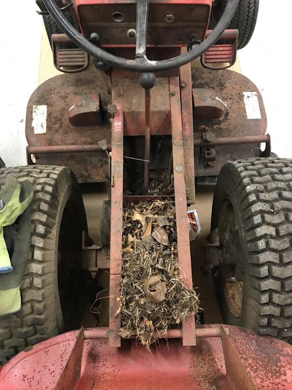

Bentoolong 94 #10 Posted June 2, 2021 Thanks Everyone! I spent a little time with it today and found out a few things. I got the deck and hood off. On the plus side it spins over nicely and seems to have decent compression (finger test). No spark present and I cracked the fuel line at the input of the carb and no fuel comes out when I turn it over. Checked the oil and it smells old but it is "on the stick" and I don't see any big engine leaks. No tires hold any air. The back tires are pretty cracked and I'm not sure they will respond to having any prying done on them. How much abuse do 50 year old tires take? The biggest issue I have seen is the transmission. The hubs seem loose on the axles and the axles are loose in the tranny case. I can't imagine any seal would hold back tranny fluid so I'm thinking the tranny is low on lube. I may try to tighten the hub screws to see if they can be tightened but that doesn't;t solve the bigger issue of bearings/seals etc. I don't see a place to check the tranny fluid. Where would I look? At this point I may put new tubes in the front tires since the bead is already broke loose. I'm concentrating on the engine to see if I can get it running. If I can get it running and moving under its own power, I'll reaches and go from there. I don't plan on using this machine although I would like to have a tractor I could use for its intended purpose( work). After seeing the condition of the deck, I don't think this is that tractor. To sum up I am encouraged by the engine. A little discouraged by the tranny although it didn't just happen over night. I'm sure this machine ran for a long time with this issue. ACman, I'll PM you on the seat. The steering wheel is not on my radar yet. Share this post Link to post Share on other sites

stevasaurus 23,848 #15 Posted June 2, 2021 On the left, rear of the transmission, you will find a fill/check plug. There is a drain plug on the bottom. Pull out the fill plug, if no oil runs out, the trans is low. You can stick a screwdriver in the hole to see how low it is. To fill, take off the seat and fenders, 2 bolts on top of the trans. Put a funnel in one of those bolt holes and add your oil until it starts to run out that fill plug...replace plug. If the trans is empty, it will take 1 1/2 to 2 qts of 90 wt gear oil. It sounds like you are going to open the trans case. The axles will have in and out of about 1/8"...normal. You should not have any up/down or side to side. 1 Share this post Link to post Share on other sites

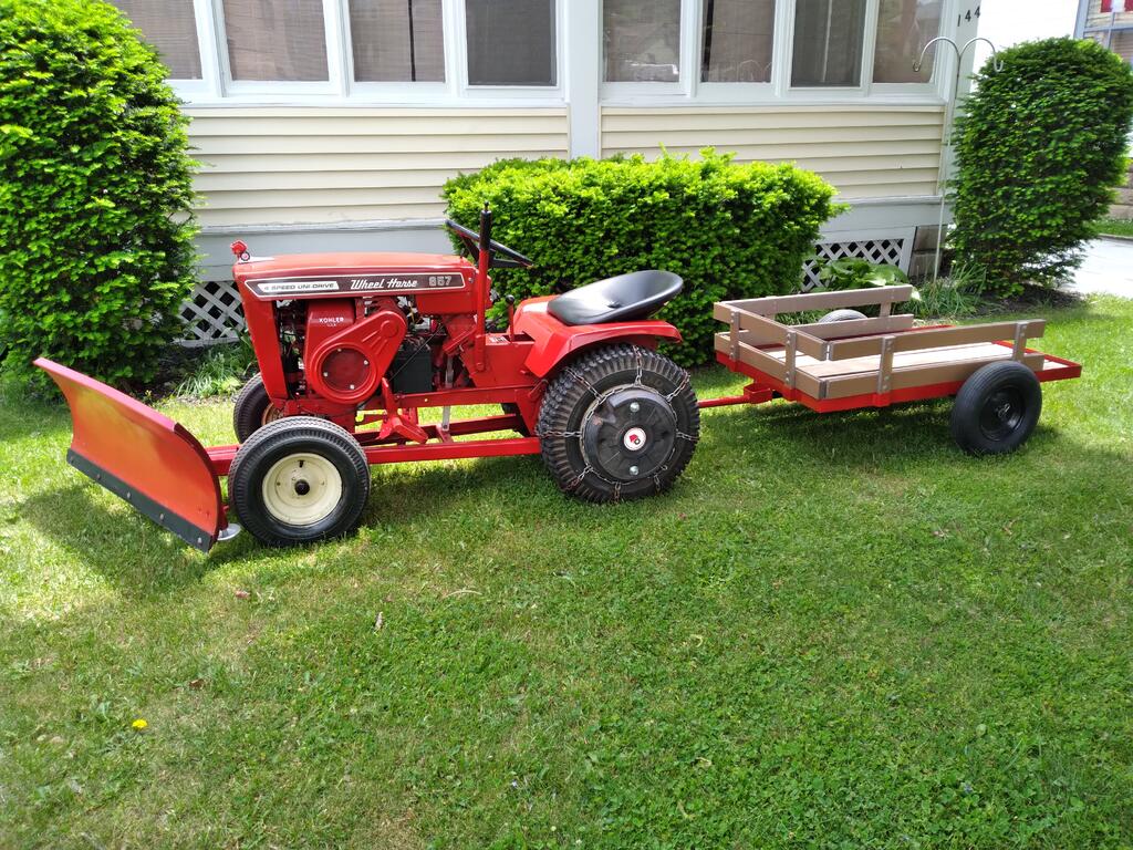

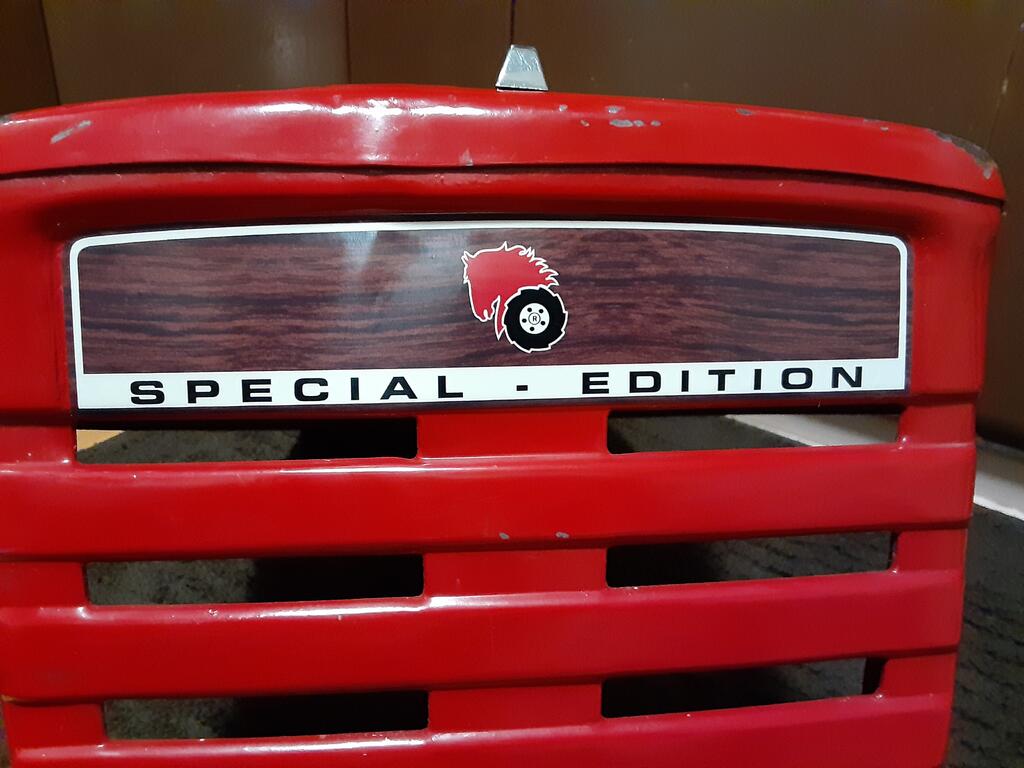

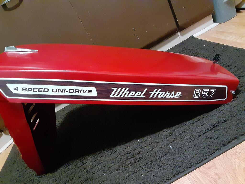

D_Mac 9,339 #21 Posted June 3, 2021 Those 857 grow on ya. When I first got mine I wasnt sure if I would like it. Grew on me fast. Have I mentioned lately how much I like that tractor? I liked it so much I made mine into a " Special Edition" Its special because I said it was and @Vinylguy made me some custom decals to prove it ! Good luck with it, hope you enjoy yours as much as I do mine. 2 Share this post Link to post Share on other sites
