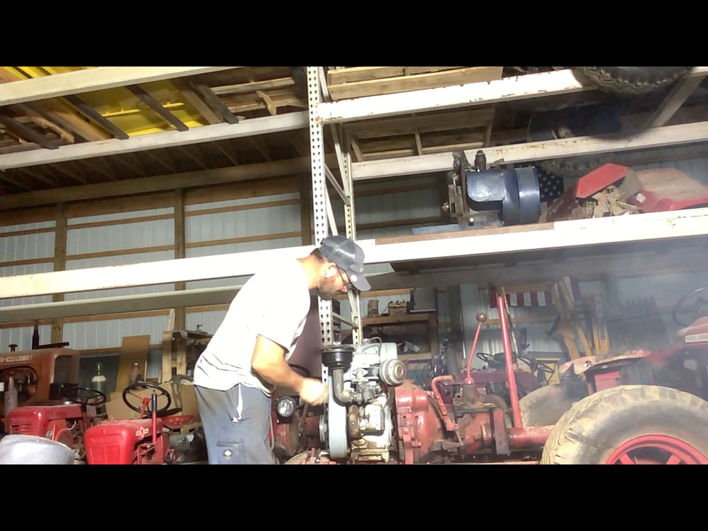

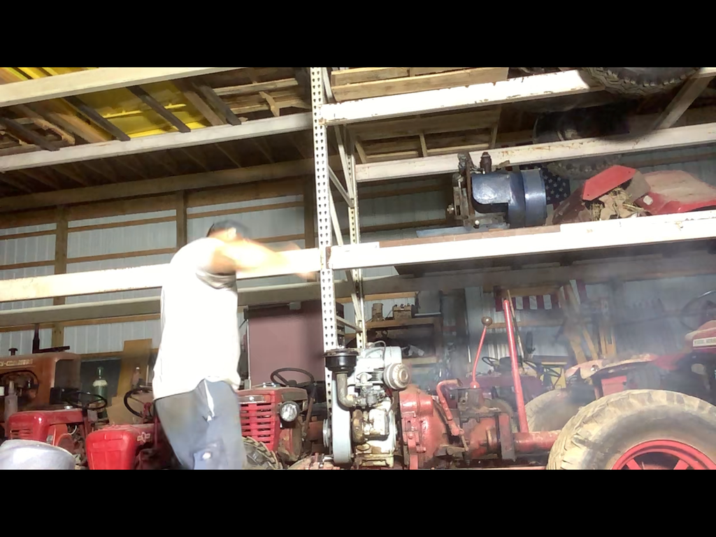

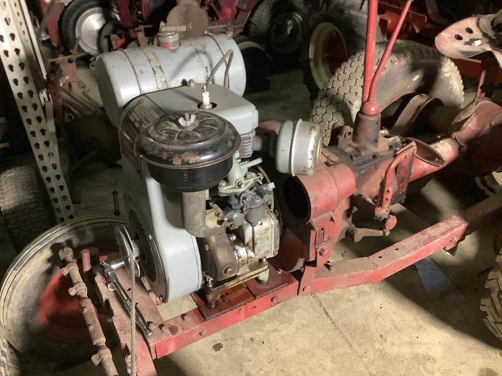

Pullstart 71,004 #26 Posted June 3, 2021 I’ve got spark, I’ve got fuel, I’ve got a tiny puff out the muffler. It must be a points gap thing. I’ll play with the points some more and hear it run soon! But not tonight. 5 4 Share this post Link to post Share on other sites

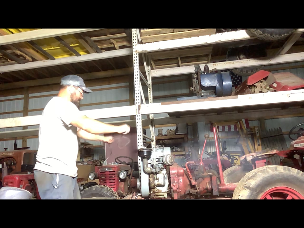

Pullstart 71,004 #28 Posted June 3, 2021 I got it running! I drove it 4 feet! There’s a noise when I press the clutch in, but I’ll figure that out tomorrow. 6 9 Share this post Link to post Share on other sites

Pullstart 71,004 #30 Posted June 3, 2021 8 hours ago, pullstart said: It must be a points gap thing. It was actually a not enough fuel thing. I kept toying with stuff until in popped to life! 4 Share this post Link to post Share on other sites

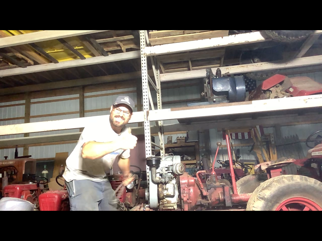

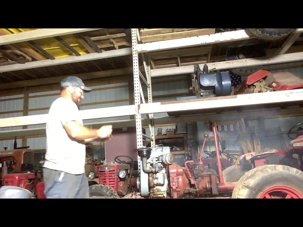

Pullstart 71,004 #33 Posted June 3, 2021 Part one of my day to get Jackie running... 1 1 Share this post Link to post Share on other sites
Pullstart 71,004 #34 Posted June 3, 2021 A new D-16 spark plug will do you wonders on an old Wisconsin! Jackie Purrs! Time to get working on a hauler now... 4 Share this post Link to post Share on other sites

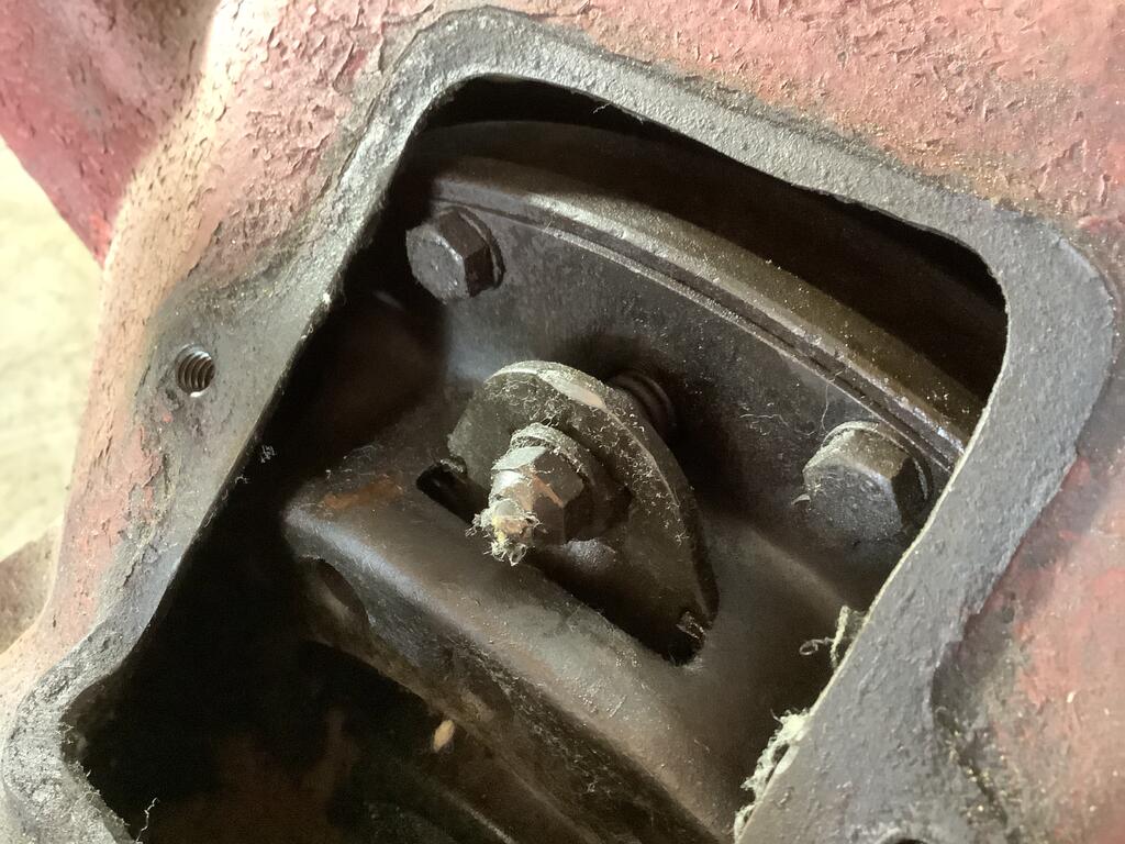

Pullstart 71,004 #35 Posted June 3, 2021 3 hours ago, 953 nut said: Throughout bearing? It’s part of the pressure plate fingers. I’m torn whether to grind the material away for clearance and risk the material tearing up the clutch disc, or just let it find it’s own way... but I suppose it will throw metal pieces that way too. 2 Share this post Link to post Share on other sites
19richie66 17,932 #36 Posted June 3, 2021 Take just a hair off and should be good. 2 1 Share this post Link to post Share on other sites

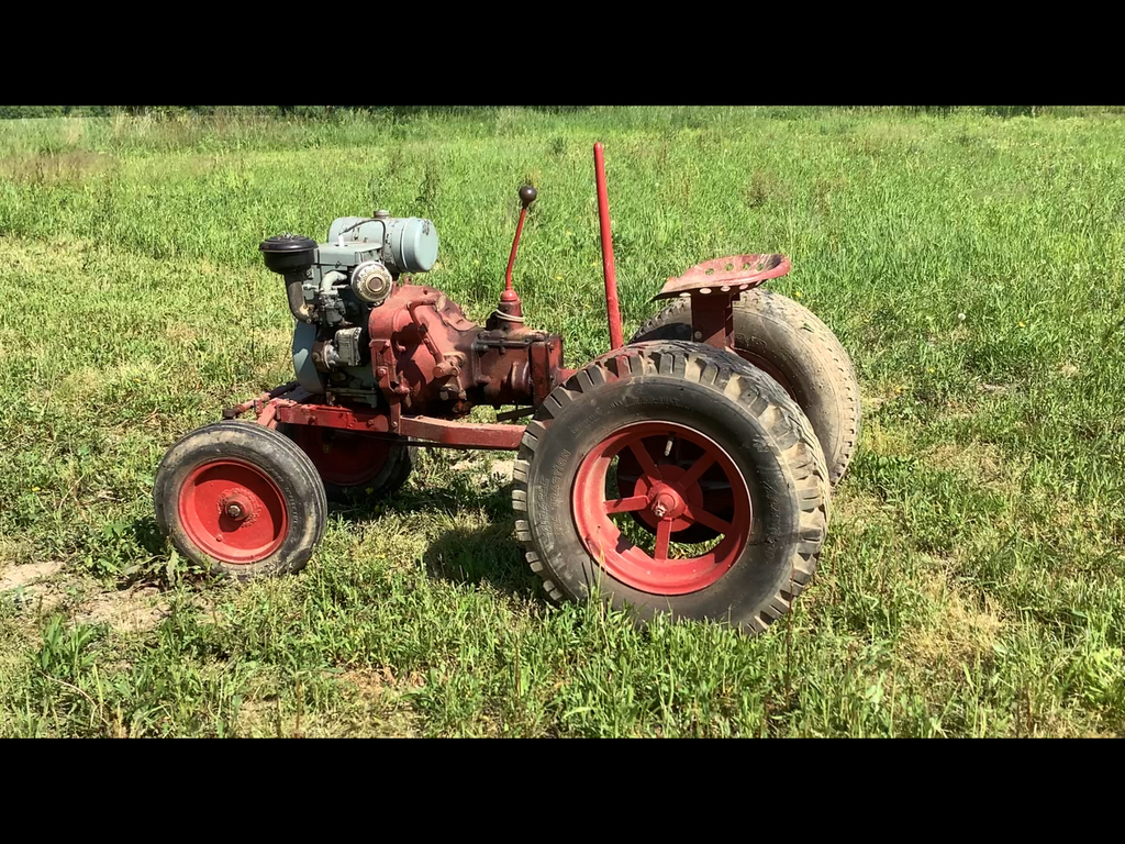

Pullstart 71,004 #38 Posted June 3, 2021 Getting close... 1 Share this post Link to post Share on other sites
Pullstart 71,004 #39 Posted June 3, 2021 And finally, a video of it running and driving! 2 4 Share this post Link to post Share on other sites
D_Mac 9,337 #40 Posted June 3, 2021 The Whiskey's a Go-Go !!! Nice 1 1 Share this post Link to post Share on other sites

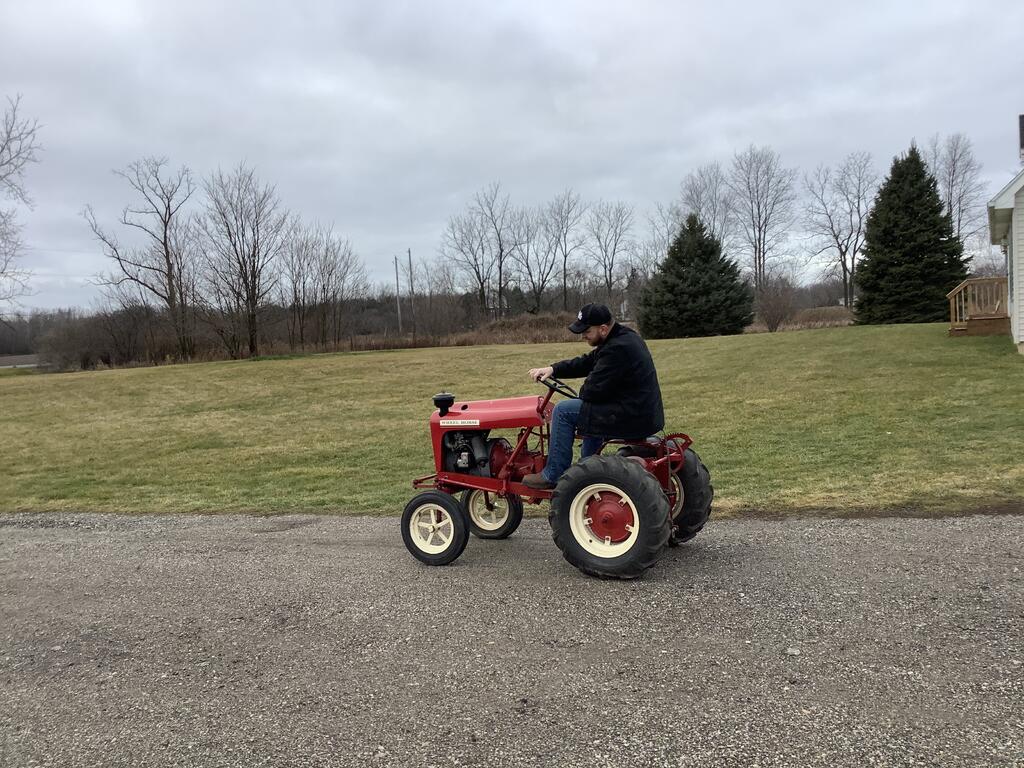

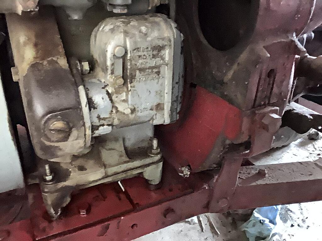

Pullstart 71,004 #44 Posted June 4, 2021 I added a kill button to the magneto and ground the fingers and studs on the pressure plate. No noise in the bellhousing! I have some T-posts to drive today. I suppose I have a reason to drive Jackie around the property! Shucks! 2 Share this post Link to post Share on other sites
Achto 32,253 #45 Posted June 4, 2021 11 minutes ago, pullstart said: I added a kill button to the magneto On the magneto tractors that we have, I ran a wire from the mag to a switch that could be accessed from he seat. I know it's not original but I did this as a safety feature. If the need arises you can shut the tractor off without leaving the drivers seat. Thought it important, specially when driving around a crowd of people at a show. 1 4 Share this post Link to post Share on other sites
