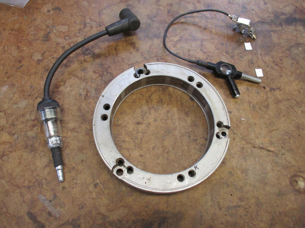

pfrederi 20,993 #1 Posted May 30, 2021 (edited) I did a refresh on a K301 that was running but leaked like a sieve. She had a breakerless ignition. This is the engne that i showed on here with the cracked flywheel. Put on a replacement and finished her up. No start not even a pop on carb cleaner. Harbor freight spark plug tester was flashing. ??? Replaced plug no change pulled the plug to look at the spark. Barely visible. Put the Briggs & Stratton tester on it and would not jump the gap. The thing had started easily before i tore her down Only change was the flywheel. There is no solid test for magnets that I am aware of so I pulled the magnetic ring out of the cracked flywheel and put it in. (incidentally I was concerned about alignment issues but it is idiot proof. There are three screws two are bigger and holes in the ring are different 2 big one small.) Bottom line she popped right off on carb cleaner and the B&S tester jumps the gap. Never had a bad magnet ring before... I have several Beakerless and I rather like them. Bottom line Harbor Freight testers are not always to be believed/... Edited May 30, 2021 by pfrederi 1 Share this post Link to post Share on other sites
ebinmaine 80,085 #2 Posted May 30, 2021 8 minutes ago, pfrederi said: Bottom line Harbor Freight testers are not always to be believed I've read/ heard that before. Not sure which type you have but there are cheap spark testers on the market that put a bulb in a parallel circuit to the actual plug wire. It'll tell you if there's power going through the wire but not show a weak output. 1 Share this post Link to post Share on other sites
squonk 47,741 #3 Posted May 30, 2021 Yup you're flashing a bulb as opposed to jumping a gap. 2 Share this post Link to post Share on other sites
JoeM 10,121 #4 Posted May 30, 2021 Yep that old gap tester is pretty much foolproof. I do use those bulb testers on running engines that have intermittent misses. Seemed like a carb issue at first. The videos are before and after repairing a wire. 1 Share this post Link to post Share on other sites
squonk 47,741 #5 Posted May 30, 2021 Don't forget. Cylinder pressure increases the voltage needed to jump the gap. (Ask @elcamino/wheelhorse about this and plumbing issues!) 1 Share this post Link to post Share on other sites
