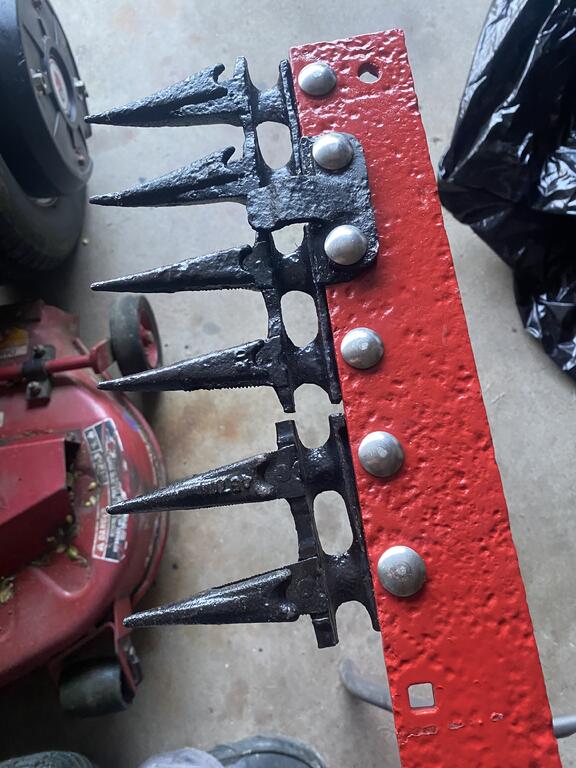

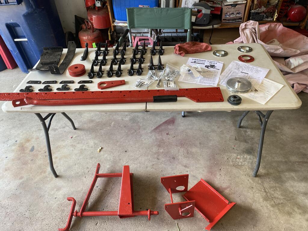

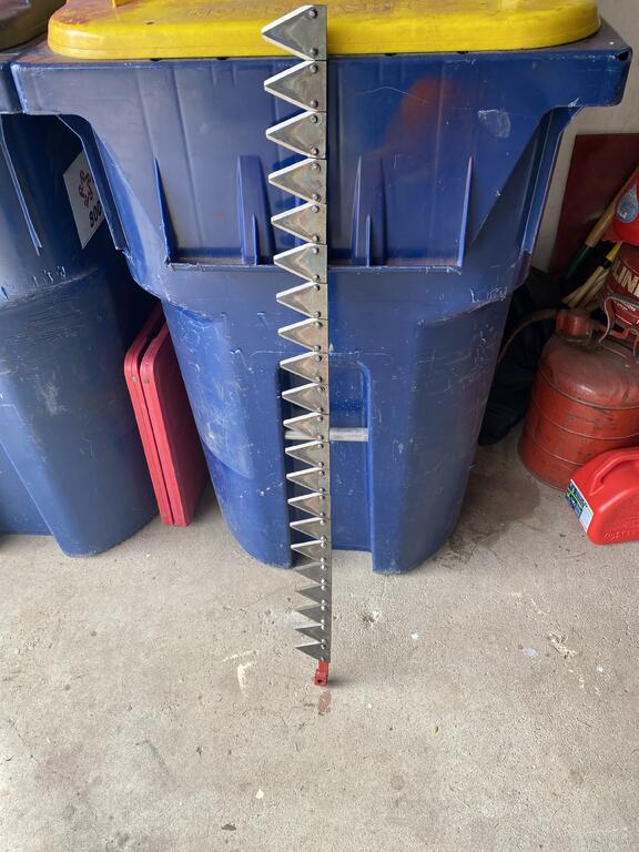

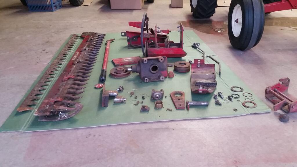

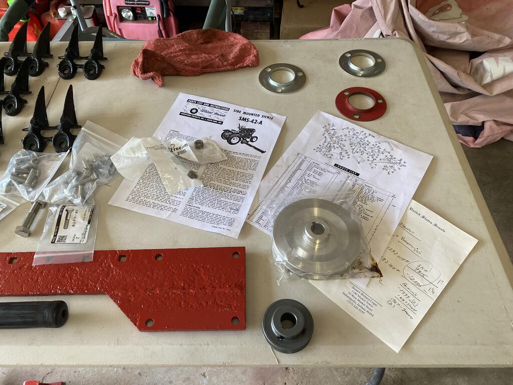

Lane Ranger 12,114 #1 Posted May 30, 2021 Well I am done with the rust removing, priming and painting for this old 42 Wheel Horse Sickle Bar Mower. Now time to reassemble ! The knife bar with new blades and rivets was finished a couple weeks ago. Also a new oil seal was installed in the wobble box behind the drive pulley. This wobble box is the best I have ever seen on a Wheel Horse sickle but the rest of the sickle was a real rust bucket. All new hardware going on this redo. Most of it stainless steel. Here are some pics of the parts ready for reassembly. I can not believe how many parts are actually in these sickle mowers. It is going to be slow going but some progress today. You have to refer to the manual drawing for almost every bolt on the guard assembly . I will post more photos as I progress on this project. This is fourth one of these I have done but maybe the last. 5 4 1 Share this post Link to post Share on other sites

c-series don 12,484 #5 Posted May 30, 2021 Looks great Lane, when restoring something I always refer to this as the fun part. I like the way you laid everything out before assembly. Please keep the pictures coming!! 1 Share this post Link to post Share on other sites

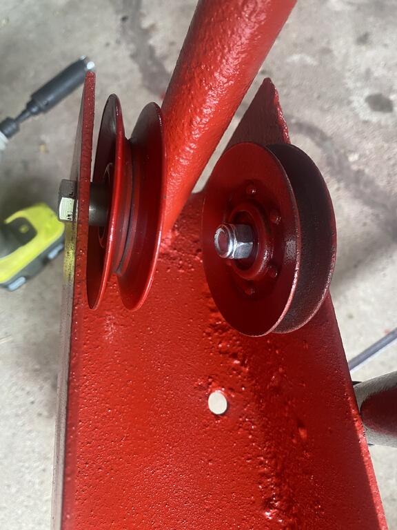

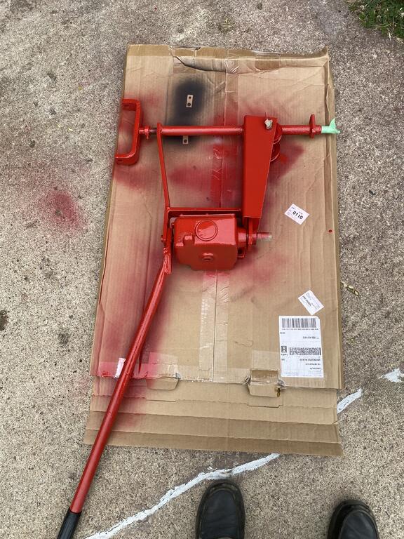

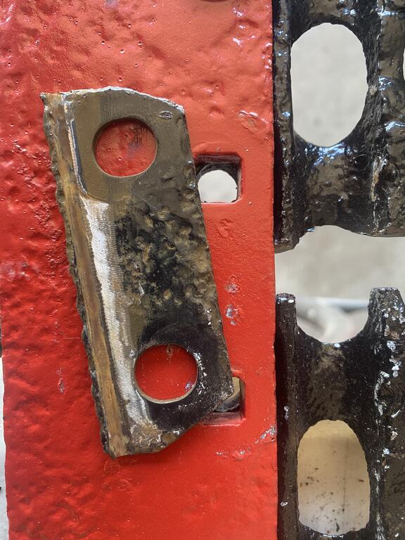

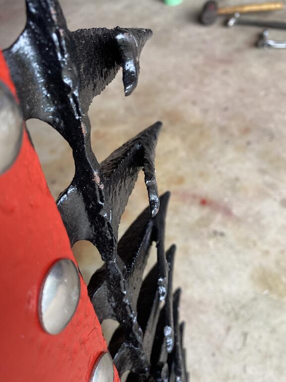

Lane Ranger 12,114 #9 Posted June 1, 2021 Put the 42 inch sickle mower lift bar and wobble box back together. Next big project is the center frame plate and drive pulley. 2 Share this post Link to post Share on other sites

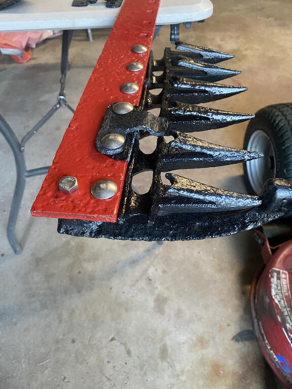

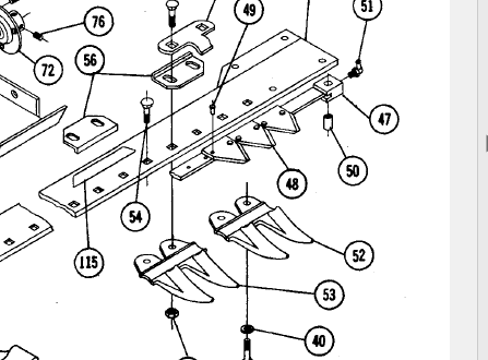

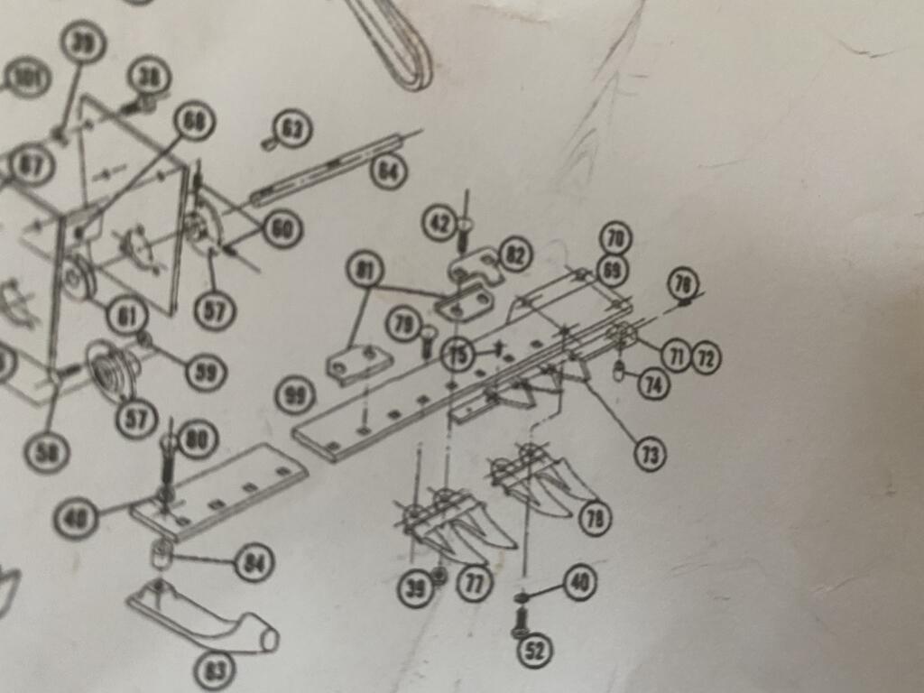

Lane Ranger 12,114 #10 Posted June 1, 2021 One of the interesting and unusual aspected of the Wheel Horse sickle bar mower is that one of the four clip plates on the sickle is turned around. Item #81 in drawing . The plate closest to the wobble box is reversed to allow the edge to align the knife bar in the guards. The weight of the 42 inch knife section and cutter bar with guards weighs a lot. I think the edge on the plate assists in keeping the knife blade section ‘true’ in the cutter bar guards. Due to rust dirt and debris from years on the sickle mower I also had to clean the inside ends of each guard tooth to make sure the individual blades would clear on the cutter bar. 1 Share this post Link to post Share on other sites
WHX?? 58,221 #11 Posted June 1, 2021 Following with interest here Lane as I have a 7-1311 to finish one of these days. What lube did you end up with in the wobble box? I was considering corn head grease? My IPL also shows those plates flipped I'll have to double check mine to see if I assembled it that way. Thanks for the tip. 1 Share this post Link to post Share on other sites
