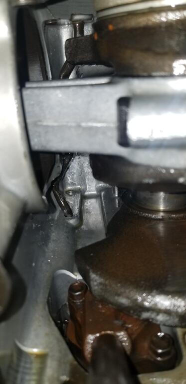

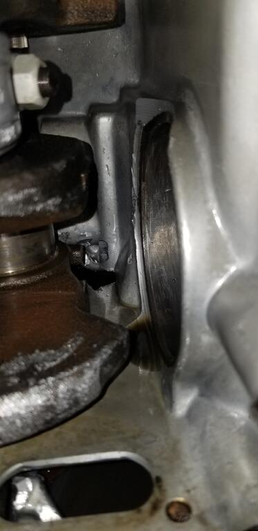

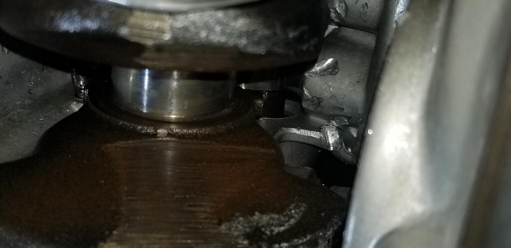

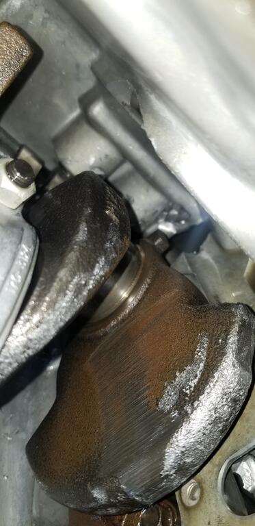

xstang77 2 #29 Posted June 12, 2021 Update pictures with pan off does the damage to whatever that tube is and Mark's in the block seem ok to use? Appears I have the old style pistons and rods too unfortunately.. 1 Share this post Link to post Share on other sites
lynnmor 8,841 #30 Posted June 12, 2021 When you get the crank out we will have a picture of the damage. That oil tube normally has some weird bends but yours is likely beyond saving. Share this post Link to post Share on other sites
