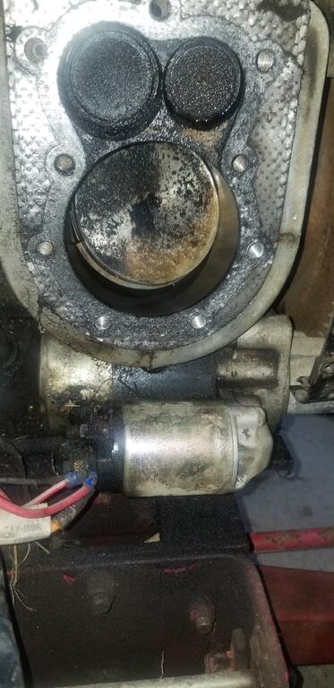

xstang77 2 #21 Posted May 30, 2021 Update,plug was soaked checked compression,rear cylinder 120lbs,front cylinder absolutely nothing... Share this post Link to post Share on other sites
lynnmor 8,915 #22 Posted May 30, 2021 58 minutes ago, xstang77 said: Update,plug was soaked checked compression,rear cylinder 120lbs,front cylinder absolutely nothing... Pull the head, it is an easy job. Take a photo of the damage. 2 Share this post Link to post Share on other sites

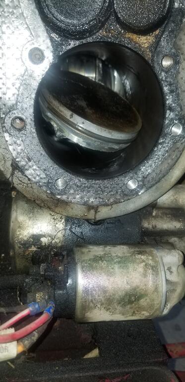

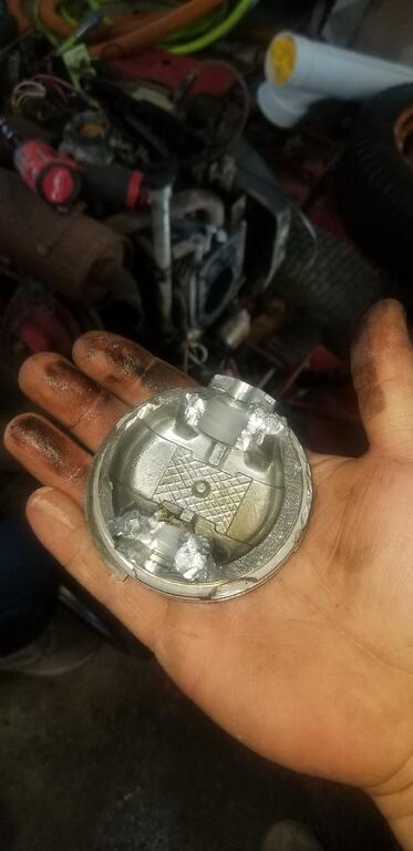

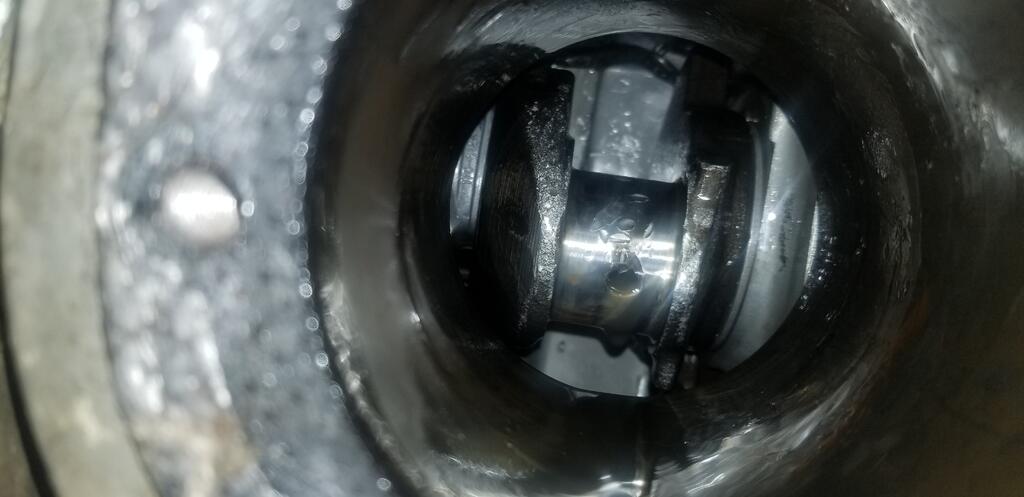

xstang77 2 #23 Posted June 1, 2021 Well I'm really impressed it ran at all,enjoy the carnage fellas. Ps if anyone has any parts please let me know,thanks. 1 Share this post Link to post Share on other sites
kpinnc 18,756 #24 Posted June 1, 2021 Whew that is rough! Still might be salvageable. Gonna take some new stuff, but if the block is good I would rebuild it. First time I've seen a 216 like that. 1 Share this post Link to post Share on other sites
Crazyredhorse 296 #25 Posted June 1, 2021 wow looks like that rod smacked that piston couple 100 times after it let loose 1 Share this post Link to post Share on other sites
