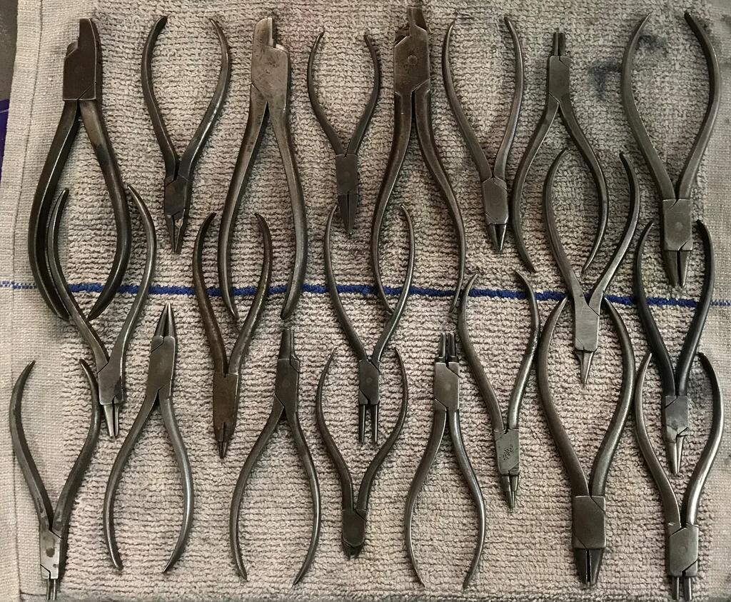

roadapples 6,987 #13 Posted May 28, 2021 I herd tell that people use them for roach clips 6 Share this post Link to post Share on other sites
lynnmor 9,010 #14 Posted May 28, 2021 You really need the full set of pliers to work on these. Share this post Link to post Share on other sites

clueless 3,436 #17 Posted May 28, 2021 3 hours ago, lynnmor said: You really need the full set of pliers to work on these. Damn! Share this post Link to post Share on other sites
