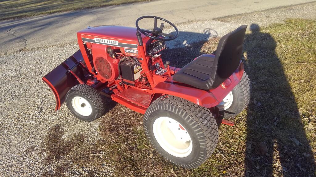

Rusty Tinsnips 477 #7 Posted May 27, 2021 Krylon Cherry Red on the Raider 10 and Rustyoleum Regal Red on the Raider 14 1 Share this post Link to post Share on other sites
