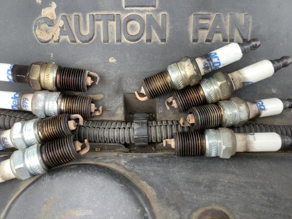

Pullstart 71,467 #52 Posted May 27, 2021 Anyone see anything odd about these old plugs? I can’t tell if they are just right or a little lean... Share this post Link to post Share on other sites
BHunter 1,702 #53 Posted May 27, 2021 31 minutes ago, pullstart said: Anyone see anything odd about these old plugs? I can’t tell if they are just right or a little lean... Hey Kev. Light tan/ grey means it’s normal. I put E3 plugs in my gmc and had a gain in fuel mileage. 1 Share this post Link to post Share on other sites

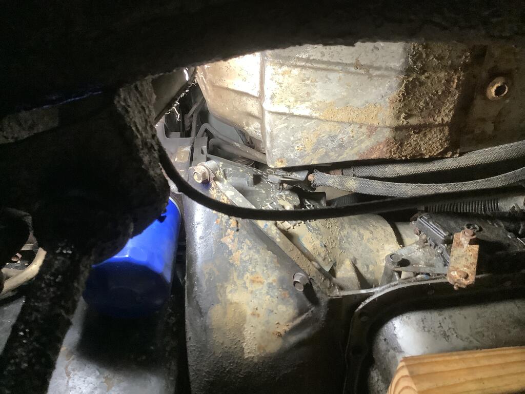

Pullstart 71,467 #59 Posted May 28, 2021 Here is the serious matter on the to-do list. I have the exhaust y-pipe and transmission crossmember out and can see the gap between the block and bell housing! 1 Share this post Link to post Share on other sites

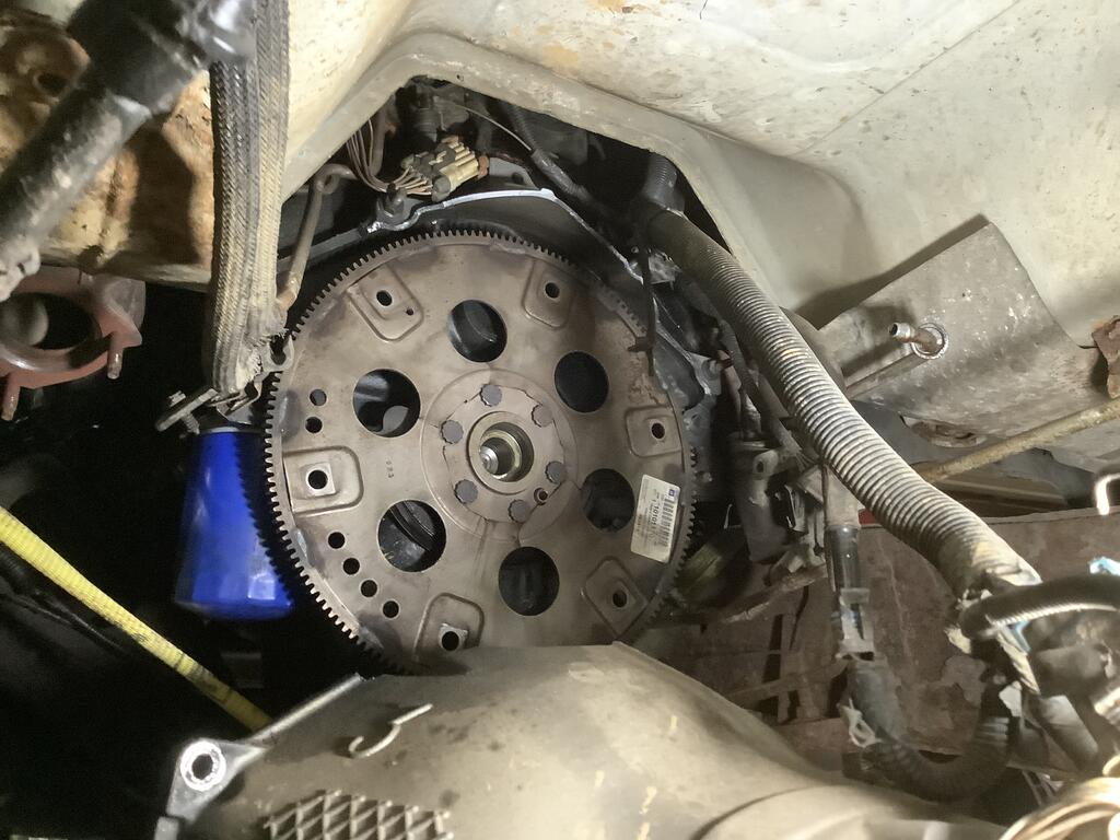

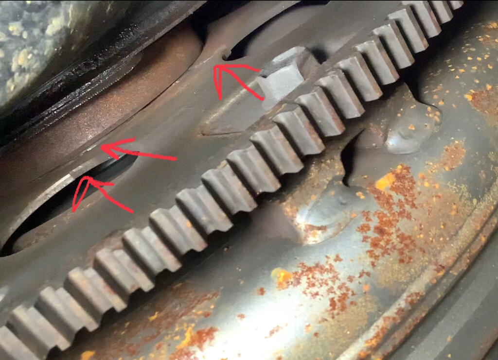

Pullstart 71,467 #60 Posted May 28, 2021 And my suspicion is confirmed. Broken flex plate. When this happened on my old plow truck, the center hub fell out of the flex plate when I pulled it apart. This could have been detrimental on some mountain pass in PeeAaah in less than a month! 1 2 Share this post Link to post Share on other sites

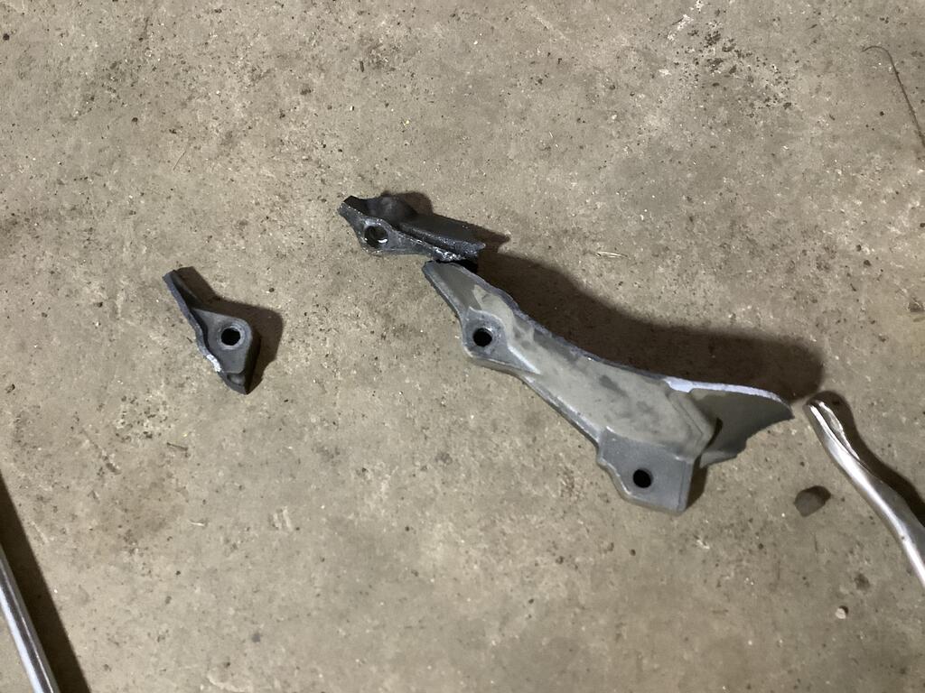

Pullstart 71,467 #62 Posted June 1, 2021 The loose transmission problem just got a bit worse... the transmission bellhousing is cracked pretty bad. I have TIG welded an ear back on before, but not half the holes! 3 Share this post Link to post Share on other sites

Pullstart 71,467 #68 Posted June 2, 2021 I grabbed the bellhousing off an SM465 I have laying next to the shop. I’ll dowel that in place and bolt all the pieces together, hoping that they weld back together true. I’ll be sure to make the side (intact) bolt holes the first to be snuggled up and the last to be removed, if this transmission ever needs to be pulled again. The parts store will have extra long dowels in tomorrow morning for me. 2 Share this post Link to post Share on other sites
WHX?? 58,308 #69 Posted June 2, 2021 Wouldn't it have been easier to find a housing in a bone yard? 1 Share this post Link to post Share on other sites
Pullstart 71,467 #70 Posted June 2, 2021 46 minutes ago, WHX24 said: Wouldn't it have been easier to find a housing in a bone yard? probably. Share this post Link to post Share on other sites
squonk 48,255 #71 Posted June 3, 2021 Wondering how that trans broke BEFORE pullstart got his hands on it? 1 Share this post Link to post Share on other sites
