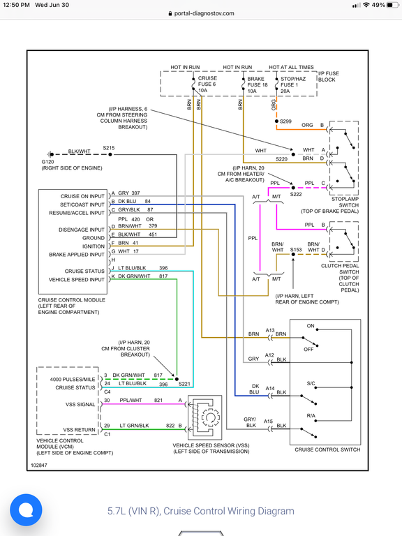

Pullstart 71,119 #229 Posted June 30, 2021 Momma’s right knee started to get sore after leaving PA. Time to troubleshoot the cruise control! So far, I’ve found no power from the brake switch without brakes applied. Time to dig into that. This video and schematic is pretty helpful so far! https://youtu.be/bJFCi1W0K1w 2 Share this post Link to post Share on other sites
Pullstart 71,119 #230 Posted June 30, 2021 Looking at the schematic, I’ll check the brake fuse before attacking the switch under the dash! 2 Share this post Link to post Share on other sites

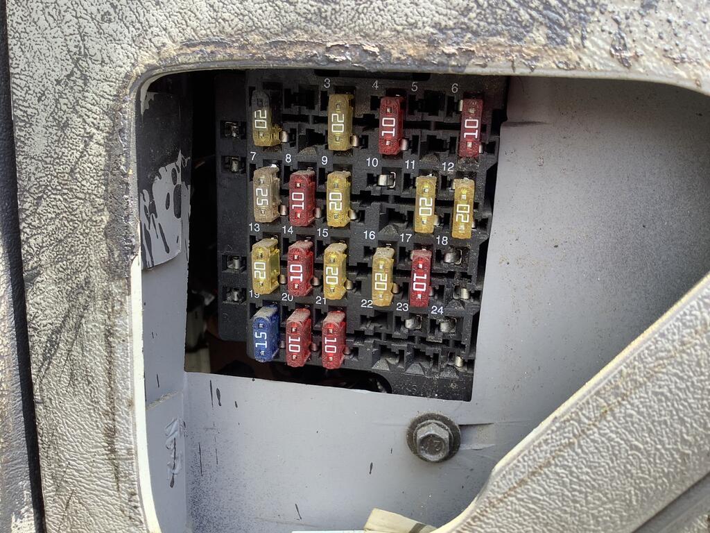

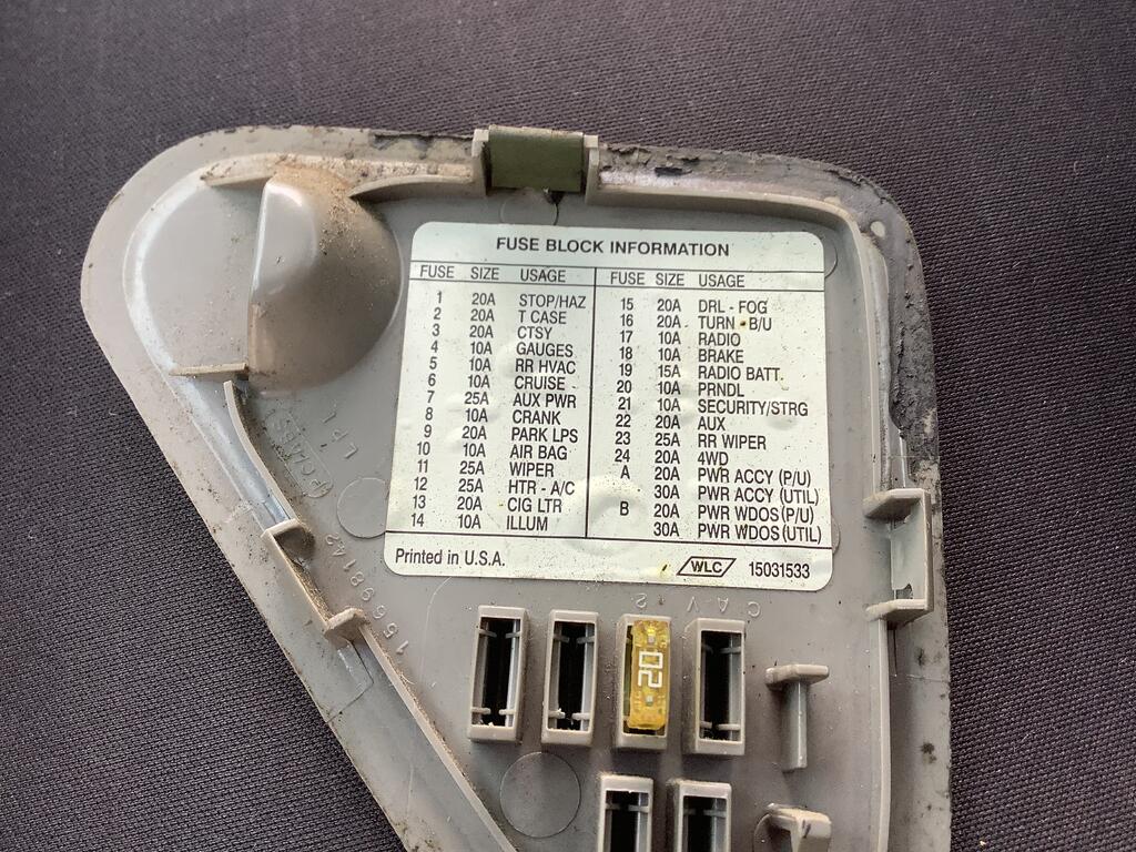

Pullstart 71,119 #231 Posted June 30, 2021 12 minutes ago, pullstart said: Looking at the schematic, I’ll check the brake fuse before attacking the switch under the dash! WHAT brake fuse???? #18 is blank. Huh. 1 1 Share this post Link to post Share on other sites
Pullstart 71,119 #232 Posted June 30, 2021 All better. Barely any dash lights work, but at least the module functions correctly! Share this post Link to post Share on other sites

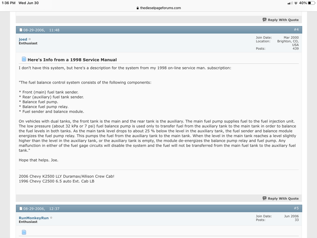

Pullstart 71,119 #234 Posted June 30, 2021 Found this on the fuel transfer system. After looking around, there is no sending unit at all in the rear tank, simply an empty hole. With that said, we just have a 130-140 mile range and that’s that. Share this post Link to post Share on other sites

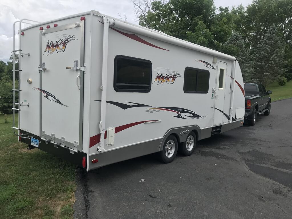

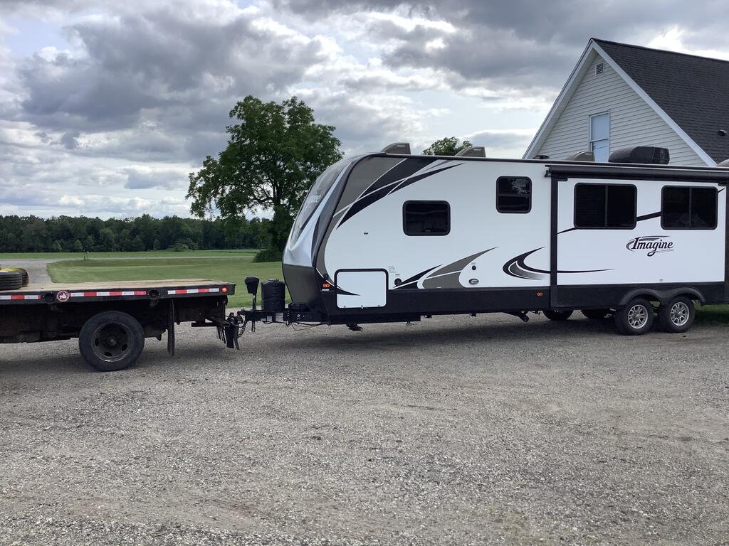

Pullstart 71,119 #235 Posted July 2, 2021 Another Farm Truck test.... It’s stable without load bars... but it sure ain’t Norman! 3 Share this post Link to post Share on other sites
Pullstart 71,119 #236 Posted July 2, 2021 It takes forever + 3 miles to get up to 50 mph... but it handles so well. Needs a Duramax! Happy Camping, Happy Independence Day Weekend! 2 Share this post Link to post Share on other sites

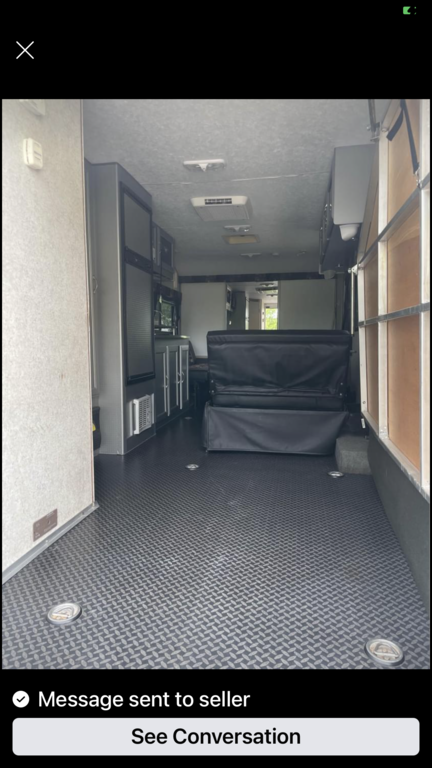

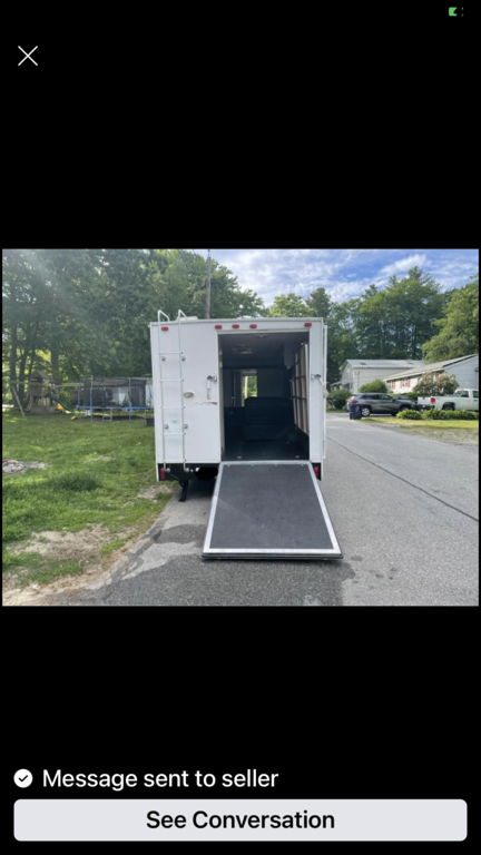

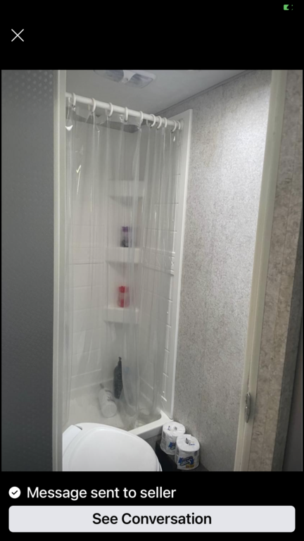

stevebo-(Moderator) 8,742 #241 Posted July 3, 2021 I decided to upgrade. We have an 8x24’ with ac but no water, toilet or shower. Big show is fine as Facilites are there however we used the trailer mostly for multiple day dirt bike (Mx) events. For the difference in price to upgrade ours it made much more sense to buy this one. Planning on swapping over wheels ans tires and electric lift. Once die I will be selling the old one. 4 3 Share this post Link to post Share on other sites

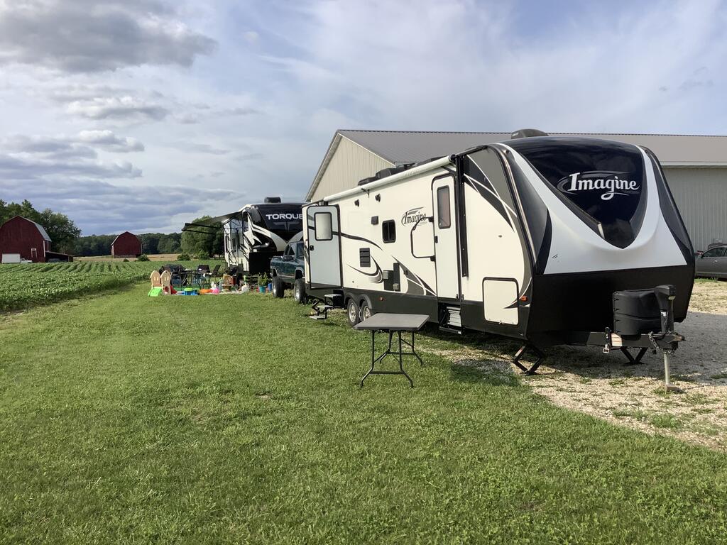

Pullstart 71,119 #243 Posted July 3, 2021 3 hours ago, WHX24 said: See you next weekend Bro! @pullstart Yeah man! After hauling 3 miles with the Farm Truck, we’re hauling the camper and some tractors with Norman, 5 tractors with the Farm Truck. Gotta save room for the infamous auction... 1 Share this post Link to post Share on other sites
