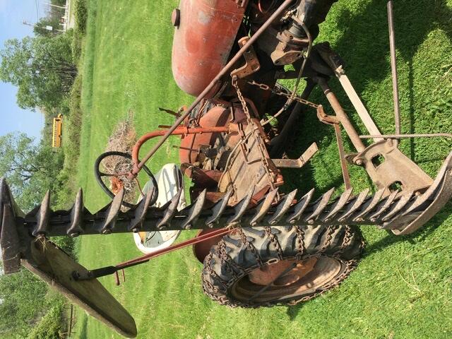

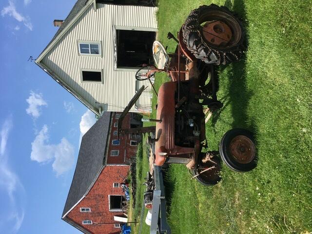

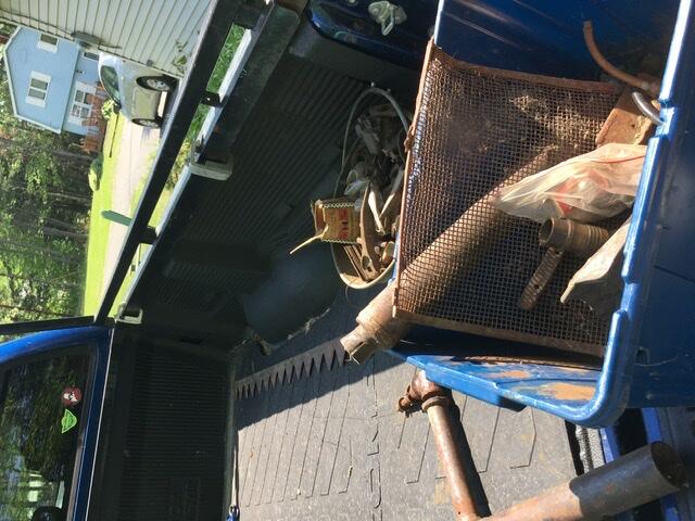

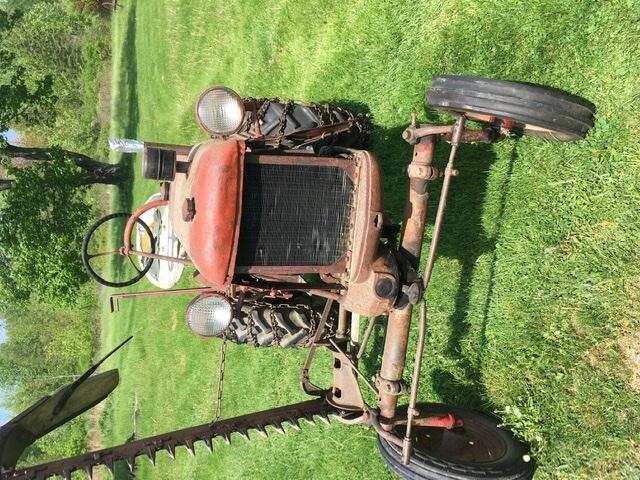

AHS 1,642 #1 Posted May 26, 2021 About 8 miles from me is my late great grandparents farm. My great grandfather, George, died in 1989. I always knew that his Farmall Cub was still a part of the farm. As I have been told the tractor has not left the farm in the past 50 to 55 years!! The tractor has been in the barn since 02 or 03, the last time it was ran. Monday the Farmall was sitting right out in the front of the garage; I whipped the truck right into the farm! I kinda know the owner of the farm and he said “the tractors for sale”, I said “how much?”, the owner said $500!!. I OWN IT!😀👍 I couldn’t begin to tell you the the memories I have with that tractor, I was born in 84, so I would have been 5 when George passed. The rides on that tractor, the sound when he used to start it up. It’s has a 6 volt positive ground.... which one goes to the starter? Power or ground? It has a sickle bar with an extra bar, extra zenith carb, the grill I have in the box as well as the muffler... it’s all there just the tractor looks used and put away wet.. it’s a 74 year old tractor😀. What do I use for oil... 10w-30? The owner of the farm said the tractors tired... “it runs great for about 30 minutes, and then she just goes south on you”. I can’t wait to hear it fire off for the first time! 😂tips and tricks for the old Farmall? I’m all ears... 5 5 7 Share this post Link to post Share on other sites

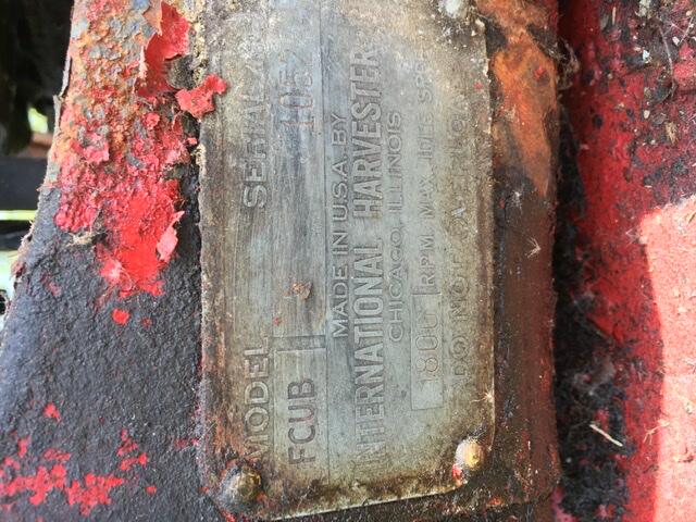

Stepney 2,357 #4 Posted May 26, 2021 They're a fun rig, I own a 1951 model. 1947 had some one year graphics I can't see on yours, and a different grille. Curious to see what your serial number is. Battery POSITIVE goes to the ground near the shifter, battery negative goes up to the starter motor, and a smaller wire off the starter goes to the dash and generator. Use 30wt non detergent oil.. mine was utterly destroyed by using modern oil and having a block full of 70 year old farmer sludge.. DO NOT use detergent oil until you take the valve tappet cover and oil pan off, and are darn sure it's clean in there.. it'll turn into lapping compound.. 7 1 Share this post Link to post Share on other sites

Stepney 2,357 #9 Posted May 26, 2021 2 minutes ago, AHS said: That’s what I thought. Just points, condenser, distributed cap.. ok so the neg goes to the starter and the positive go to ground. Makes sense in an upside down world! Positive ground is an interesting thing.. if it's really a 1947 it hardly even has a voltage regulator. That may be old enough for a cutout relay only.. with the manual charge. If the light switch has 3 positions, you should have a normal regulator. If it has FOUR. Far left is off, first click is 2a charge, second click is full 15a charge, and the next two clicks are headlights 'dim' and headlights 'dimmer'.. ahhh 6v.. If the genny works at all, and it is really that year, it would have that genny and switch. Never ever run it around all day on the high charge setting, your battery will fry.. Yep.. hook up your battery backwards and listen to the Dragging Delco sing it's song.. I-dont---wanna-I---dont-wanna.. 4 Share this post Link to post Share on other sites

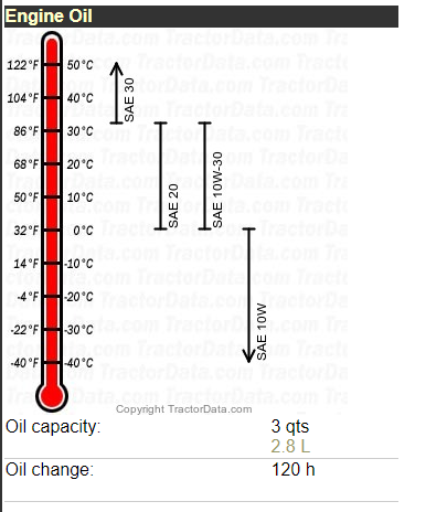

AHS 1,642 #21 Posted June 1, 2021 In the morning, I read the owner’s manual to the Cub, all 66 pages of it... I’m on page 30...and another cup of coffee gone! The manual is beyond excellent in detail! It tells you how to time your engine! There is no water pump, it a thermosyphen system. As simple as it gets! I’m going to change all the fluids. The oil is like the color of coffee, and the thickness! 😳. The amount of oil, flip up cap to oil this and that, (in the bearings and in the air cleaner) and the million grease points.... would make it last 74 years! The lack of maintenance, which has been done to this tractor... will soon be done again! I have taken out all the spark plugs, and looking down in the valve chamber and the spark plugs... they looks clean! I’m hoping for a good compression test! 1 Share this post Link to post Share on other sites
T-Mo-(Moderator) 4,803 #22 Posted June 1, 2021 Be sure you drain the transmission and refill. The PTO shares the same reservoir as the transmission, but it also has a fill port as well as the transmission. The final drives have to be filled separately from each other and from the transmission as well. 1 Share this post Link to post Share on other sites
AHS 1,642 #23 Posted June 2, 2021 20 hours ago, T-Mo said: Be sure you drain the transmission and refill. The PTO shares the same reservoir as the transmission, but it also has a fill port as well as the transmission. The final drives have to be filled separately from each other and from the transmission as well. Ok, the transmission takes 3.5 qu of sae 90... I’m gonna try for sae 90, but may end up with 90w-80. So the PTO shares some of that 3.5 qu that it take to fill up the transmission? The touch control... it says IH touch control fluid/ hy- Tran fluid .. 4 1/4 qu. What do I get? Just hydraulic fluid? Share this post Link to post Share on other sites
T-Mo-(Moderator) 4,803 #24 Posted June 3, 2021 I never had to touch the touch control on my '47, or my '50. It's a good question to ask at the Cub forum site. And yes, the PTO shares the same housing as the transmission, but it does have it's own fill port. When I change my transmission oil, I drained it, and then opened up both fill ports. I added most of the oil to the transmission fill port, but added a bit to the PTO fill port as well to be sure it was lubricated before operation. But, in essence, it shares the same reservoir as the transmission. 1 Share this post Link to post Share on other sites
