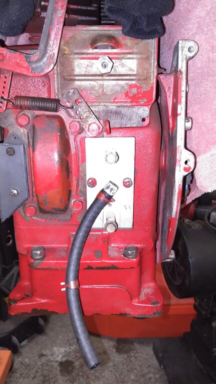

Bill D 2,997 #8 Posted May 27, 2021 Make a plate like this and put a vacuum impulse pump on it. Bill 1 Share this post Link to post Share on other sites
