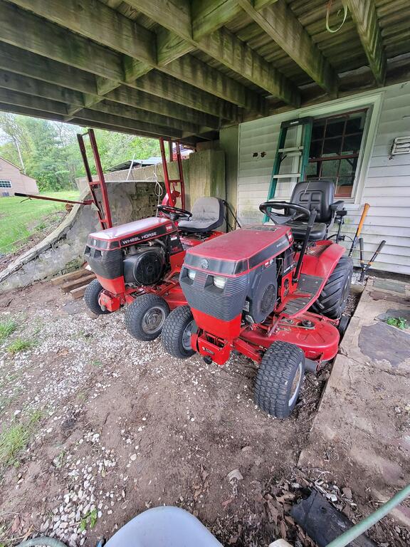

Jhook 849 #30 Posted June 3, 2021 6 hours ago, lynnmor said: If a valve is in need of adjustment, it should not be postponed because a leaking valve can lead to more work and expense. Onan suggests 1000 hours but with the varied usage of a tractor I say 750 hours is plenty. Ok i will look into that. No performance issues at all. Ran great. The only hiccup was if you throttle up too quickly from idle it would sputter and die. Throttle up slowly and itll go nice and smooth to full throttle. Now the question is can the heads be removed and valves adjusted without pulling the engine? Im not against pulling it, but i work on everything outdoors under my deck, unfortunately i dont have a shed or garage right now. Just this small workplace with no protection from the elements other than the sun. Share this post Link to post Share on other sites
