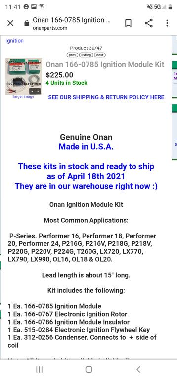

Jhook 849 #13 Posted May 27, 2021 On 5/26/2021 at 12:32 PM, Bill D said: Jack's Small engine has the module for $99. Bill Can you give me a link? Couldnt find it Share this post Link to post Share on other sites
Jhook 849 #14 Posted May 27, 2021 On 5/26/2021 at 3:43 AM, horseyheaven said: Onanparts.com has the ignition module for $179.99 that is genuine Onan. Whats the proper part number i was having trouble with that Share this post Link to post Share on other sites
lynnmor 8,876 #15 Posted May 27, 2021 19 minutes ago, Jhook said: Whats the proper part number i was having trouble with that One source there are more. Share this post Link to post Share on other sites
Bill D 2,976 #16 Posted May 28, 2021 (edited) 1 hour ago, Jhook said: Can you give me a link? Couldnt find it I just searched Onan P216 ignition module on Google and it came up. Jack's had it listed as Onan ignition control. PN 1660785 is $110.95. They also have a PN 1660821 for $99.95. I believe you need the 0785. What does the 0821 fit? It looks the same. Bill Edited May 28, 2021 by Bill D Share this post Link to post Share on other sites
Jhook 849 #17 Posted May 30, 2021 On 5/27/2021 at 9:08 PM, Bill D said: I just searched Onan P216 ignition module on Google and it came up. Jack's had it listed as Onan ignition control. PN 1660785 is $110.95. They also have a PN 1660821 for $99.95. I believe you need the 0785. What does the 0821 fit? It looks the same. Bill Thats what i was confused by the 2 different parts. Also wasnt sure if the onan 20hp and 18hp and 16hp all use the same one Share this post Link to post Share on other sites

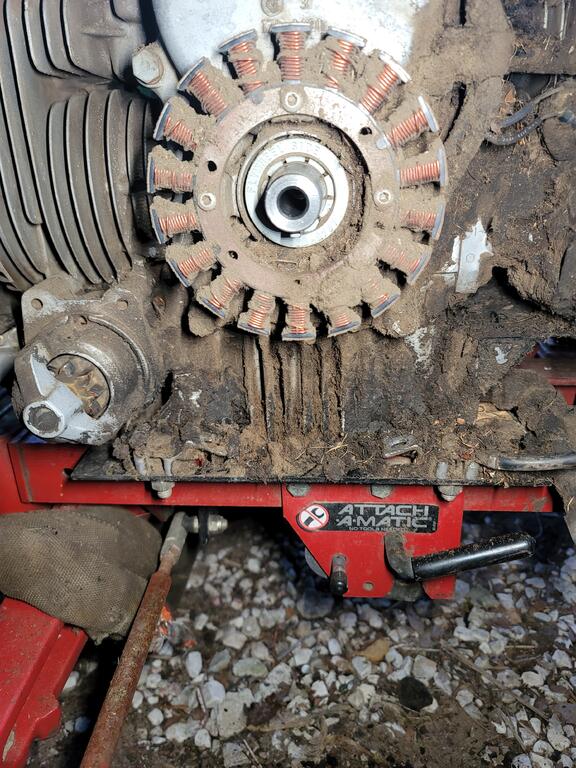

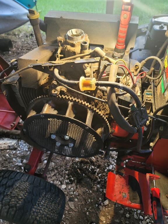

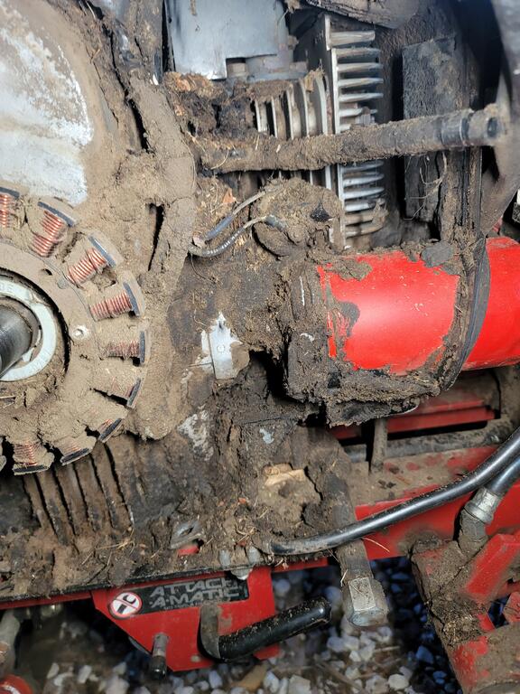

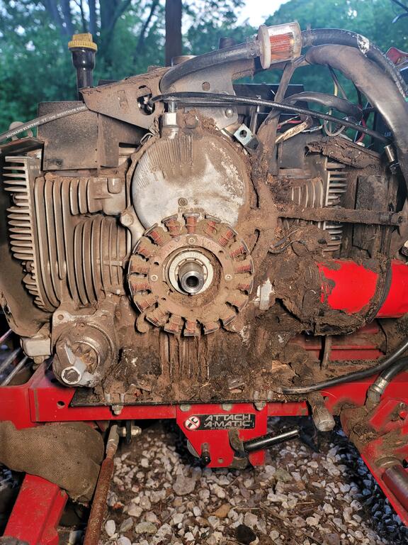

Jhook 849 #18 Posted June 2, 2021 Making some progress today. What a mess 1 Share this post Link to post Share on other sites
Tuneup 1,459 #19 Posted June 2, 2021 A bit of pressure washing appears to be in your near future. 1 Share this post Link to post Share on other sites
Handy Don 16,916 #20 Posted June 2, 2021 12 hours ago, Jhook said: Making some progress today. What a mess Golly, is there an engine under all that oily dirt? Share this post Link to post Share on other sites
Jhook 849 #21 Posted June 2, 2021 1 hour ago, Handy Don said: Golly, is there an engine under all that oily dirt? Theres gotta be one in there somewhere. I used this tractor last week😂 Share this post Link to post Share on other sites
Jhook 849 #22 Posted June 2, 2021 Also is it safe to pressure wash everything shown? Obviously avoiding the carb, and not spraying directly onto electrical components, but as far as getting everything a little wet will it be fine? I plan to do the stator and whatever else is recommended for replacement while its apart Share this post Link to post Share on other sites
Handy Don 16,916 #23 Posted June 2, 2021 19 minutes ago, Jhook said: Also is it safe to pressure wash everything shown? Obviously avoiding the carb, and not spraying directly onto electrical components, but as far as getting everything a little wet will it be fine? I plan to do the stator and whatever else is recommended for replacement while its apart I'm leery of pressure washing anything electrical, fuel-related, fabric, or having seals intended to keep lubes in and/or dirt out. I always worry about forcing water into some place it isn't intended to be. Simple Green (or similar) applied, at concentrations higher than recommended, with a soft, long-bristle brush and then rinsed gently with a hose are my go-toos. I'll also use low-pressure air to clear tough-to-reach places and remove residual moisture. That said, away from the above constraints, or when I am disassembling stuff, pressure washing and high-pressure air get the nod. Share this post Link to post Share on other sites
Jhook 849 #24 Posted June 2, 2021 13 minutes ago, Handy Don said: I'm leery of pressure washing anything electrical, fuel-related, fabric, or having seals intended to keep lubes in and/or dirt out. I always worry about forcing water into some place it isn't intended to be. Simple Green (or similar) applied, at concentrations higher than recommended, with a soft, long-bristle brush and then rinsed gently with a hose are my go-toos. I'll also use low-pressure air to clear tough-to-reach places and remove residual moisture. That said, away from the above constraints, or when I am disassembling stuff, pressure washing and high-pressure air get the nod. Ok. Its been soaking in simple green since last night. Going to soak it all week cause i work til sunday. Going to be installing this kit from onanparts and also a new stator, and new flywheel key. Any other recommended parts to replace while its apart? Share this post Link to post Share on other sites
Jhook 849 #25 Posted June 2, 2021 I also dropped one of the three 5/16 screws that hold the air box on down the throat of the carb. So thats gotta get pulled as well. Unless i can vacuum it out. My fault for rushing of course. Everything else so far is going smoothly. This onan really makes me appreciate the simplicity and reliability of the kohler ch15s command pro thats on my 315. Share this post Link to post Share on other sites
