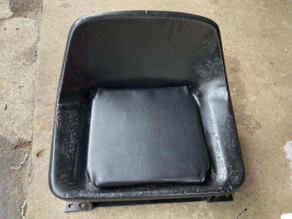

ebinmaine 81,047 #1 Posted May 22, 2021 Where do we get foam to rebuild a seat? Are there options for a denser type? Share this post Link to post Share on other sites
8ntruck 9,368 #2 Posted May 22, 2021 Any upholstery supply house. Sorry, could not resist the smart a$$ answer. Yes, there are different densities to choose from. I've seen blocks of the stuff at places like Hobby Lobby. Don't know how suitable that foam is, though. Try a search of 'upholstery foam' on the interweb. Share this post Link to post Share on other sites
lynnmor 9,064 #3 Posted May 22, 2021 There is all kinds of foam available at an upholstery shop. Google upholstery supplies for online purchases. Share this post Link to post Share on other sites

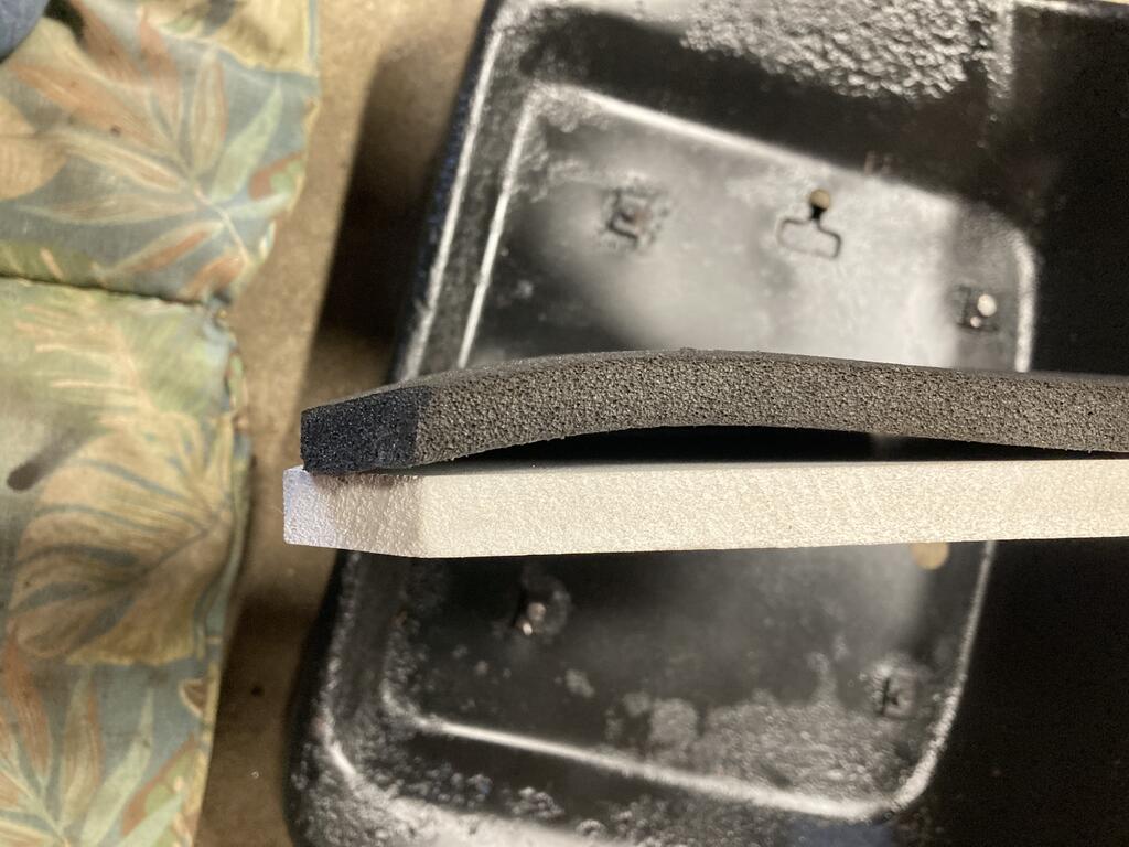

ebinmaine 81,047 #4 Posted May 22, 2021 8 minutes ago, 8ntruck said: Any upholstery supply house. Sorry, could not resist the smart a$$ answer. Yes, there are different densities to choose from. I've seen blocks of the stuff at places like Hobby Lobby. Don't know how suitable that foam is, though. Try a search of 'upholstery foam' on the interweb. 8 minutes ago, lynnmor said: There is all kinds of foam available at an upholstery shop. Google upholstery supplies for online purchases. It's like you were both thinking the same... Can't do upholstery shop.. Ain't any around. We bought some when we built the Cinnamon Horse 2 years ago but it's too thin and "fluffy" I need a much denser type. Share this post Link to post Share on other sites
8ntruck 9,368 #5 Posted May 22, 2021 McMaster Carr also has a selection of industrial foam. Choice of materials and durometer ratings. Most of this stuff is really firm. 1 Share this post Link to post Share on other sites
Stepney 2,356 #6 Posted May 22, 2021 Hit up one of the marine supply places in Portland. They carry various types of boat seat foam that hold up a lot better in the humidity. Wont mold up. 3 Share this post Link to post Share on other sites
oliver2-44 11,791 #7 Posted May 22, 2021 2 hours ago, ebinmaine said: It's like you were both thinking it's too thin and "fluffy" I need a much denser type. Or a lighter horse rider As if I have any room to talk. 1 Share this post Link to post Share on other sites
SylvanLakeWH 32,777 #8 Posted May 22, 2021 (edited) I used an old foam backpackers sleeping pad - ensolite - because I had it on hand so the price was right. Got the vinyl out of the jungle… cheap. Works fine butt, shall we say, my rear would appreciate a wee bit more… Edited May 22, 2021 by SylvanLakeWH 1 Share this post Link to post Share on other sites
Achto 32,891 #9 Posted May 22, 2021 11 hours ago, ebinmaine said: Can't do upholstery shop.. Ain't any around Purchase some carpet padding, use spray adhesive to laminate layers together until you have desired thickness. Carve it to your desired shape, an electric knife works great for shaping foam. 1 Share this post Link to post Share on other sites
roadapples 6,987 #10 Posted May 22, 2021 Those pads for neeling on doing yard work are pretty dense. May need more than one... 1 Share this post Link to post Share on other sites
rmaynard 17,634 #11 Posted May 22, 2021 Ask Bob Ellison where he gets his. 1 Share this post Link to post Share on other sites
peter lena 10,103 #12 Posted May 22, 2021 @ebinmaine , asking for a denser type ? boat seating foam is best for that , that foam is lifesaving specific , use that regularly for my knee exercises , firm yet very compliant . most boat supply shops have a foam scrap bin from left overs , on seats , comes various thicknesses , I have 3" and 1 1/2 ". makes kneeling on a hard floor with artificial knees a non issue . pete 2 Share this post Link to post Share on other sites
Lane Ranger 12,159 #13 Posted May 22, 2021 (edited) If you can get it the best stuff to use is aircraft foam. More dense but still pliable. I used on a couple of seats with new seat covers. Edited May 22, 2021 by Lane Ranger 1 Share this post Link to post Share on other sites
