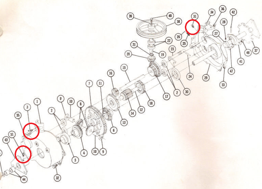

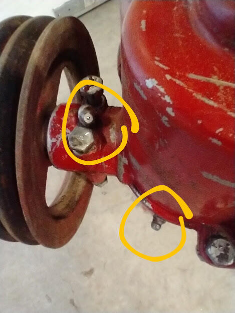

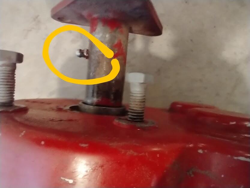

rmaynard 17,562 #1 Posted May 18, 2021 (edited) I've been searching for a definitive answer, but no luck. Does anyone know what type of grease the 5056 transmission uses? There are 3 zerk fittings. This one is on the axle Top one is on the input shaft, and lower one goes into the body of the transmission. Any help would be appreciated. Edited May 18, 2021 by rmaynard Share this post Link to post Share on other sites

stevasaurus 23,828 #7 Posted May 18, 2021 My manual says the transmission was packed at the factory with "special lubricant" , That tells me it is not just regular grease. If you add regular grease, you may run the risk of causing the two lubricants to react unfavorable to each other. Why are you looking into this? Did you open yours up? Pull out one of the grease fittings and see if you can't dig out some of the grease and get it checked out. Share this post Link to post Share on other sites
rmaynard 17,562 #8 Posted May 18, 2021 30 minutes ago, stevasaurus said: My manual says the transmission was packed at the factory with "special lubricant" , That tells me it is not just regular grease. If you add regular grease, you may run the risk of causing the two lubricants to react unfavorable to each other. Why are you looking into this? Did you open yours up? Pull out one of the grease fittings and see if you can't dig out some of the grease and get it checked out. I cleaned the outside of the tranny by soaking it in kerosene and using a scraper and brush to get the hard, crusty grease and dirt off. It was caked on about 1/4" thick in places. By looking at what is visible behind the zerks, I'm thinking that the previous owner or servicing dealer put regular lithium grease in. It's yellow. In the process of cleaning around the recessed axle bearings, I used brake cleaner, not thinking that it would run into the bearings and remove some of the lube. Now the bearings sound dry. Since the bearings get their lubrication from the inside (Bentonite grease) I want to force more in to fill the bearings. Since posting, I have found a 32 ounce container of Tecumseh/Peerless Bentonite grease out in Shiller Park, Illinois. $30 delivered, but at least I know I'm putting the right stuff back in. 3 1 Share this post Link to post Share on other sites
squonk 48,031 #9 Posted May 18, 2021 I was going to say Bentonite grease. I had a Peerless trans apart once when my B-I-L got crazy with a hammer on a wheel. Nasty Nasty Nasty. There wasn't enough Paper towels in Wally World's whare house to clean things up. Share this post Link to post Share on other sites
stevasaurus 23,828 #10 Posted May 18, 2021 There ya go Bob...that is what I was thinking also. Squonk's right, that stuff is nasty and if water gets in it, it really smells terrible. On a side note, if you have ever been to Schiller Park, you would know why THEY have that grease. 1 Share this post Link to post Share on other sites
