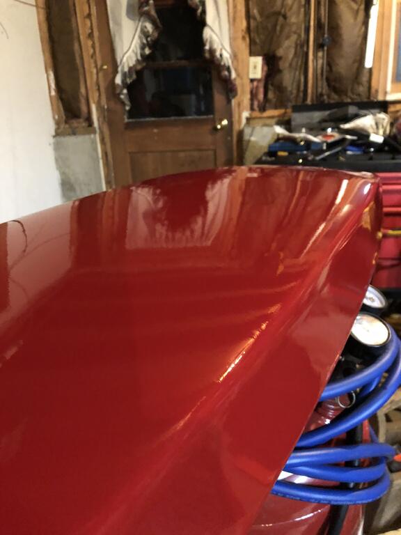

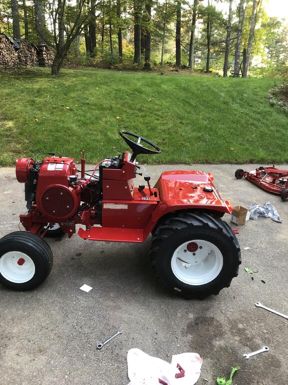

WheelhorseBob 1,550 #103 Posted October 11, 2021 Paint day…I really hate the prep work. I tried sanding my NOS Hood which had 40 years worth of scratching and dings. Primed it and was like this sucks. Down to bare metal with a wheel…ugh. Anyway it came out well. I want this tractor don by the end of this week! 2 Share this post Link to post Share on other sites
ebinmaine 80,388 #104 Posted October 11, 2021 Looks good from here Bob! Many moons ago a pro body repair fella told me painting a car is about 95% prep and the rest actual spraying. 2 Share this post Link to post Share on other sites
WheelhorseBob 1,550 #105 Posted October 12, 2021 18 minutes ago, ebinmaine said: Looks good from here Bob! Many moons ago a pro body repair fella told me painting a car is about 95% prep and the rest actual spraying. I hate body work. I can’t blend anything, nothin, nada! Bare metal is a lot of work without sandblasting but it’s the only thing that works for me…. 2 Share this post Link to post Share on other sites

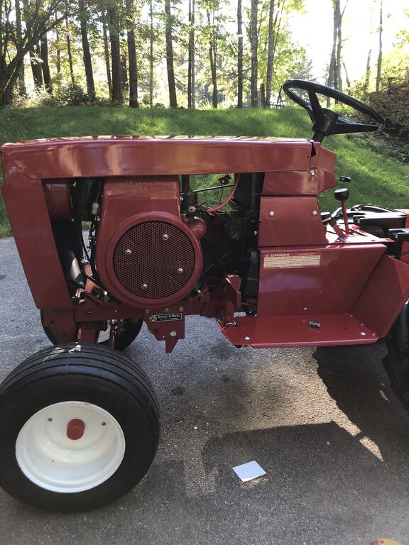

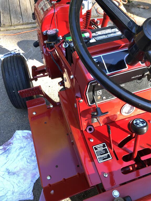

WheelhorseBob 1,550 #107 Posted October 12, 2021 (edited) Coming together, all metal is painted and going back on. Should be interesting to fit the fender pan given the width of the electric lift. Has to fit cause it came apart! Edited October 12, 2021 by WheelhorseBob 2 3 Share this post Link to post Share on other sites

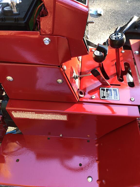

ebinmaine 80,388 #108 Posted October 12, 2021 Bob are you going to put any kind of guards on the edges of the sheet metal where they contact? Kind of like miniature door edge guard... 1 Share this post Link to post Share on other sites
WheelhorseBob 1,550 #109 Posted October 12, 2021 16 minutes ago, ebinmaine said: Bob are you going to put any kind of guards on the edges of the sheet metal where they contact? Kind of like miniature door edge guard... Hadn’t thought of it. None of my others have anything like that. Any pictures? 1 Share this post Link to post Share on other sites

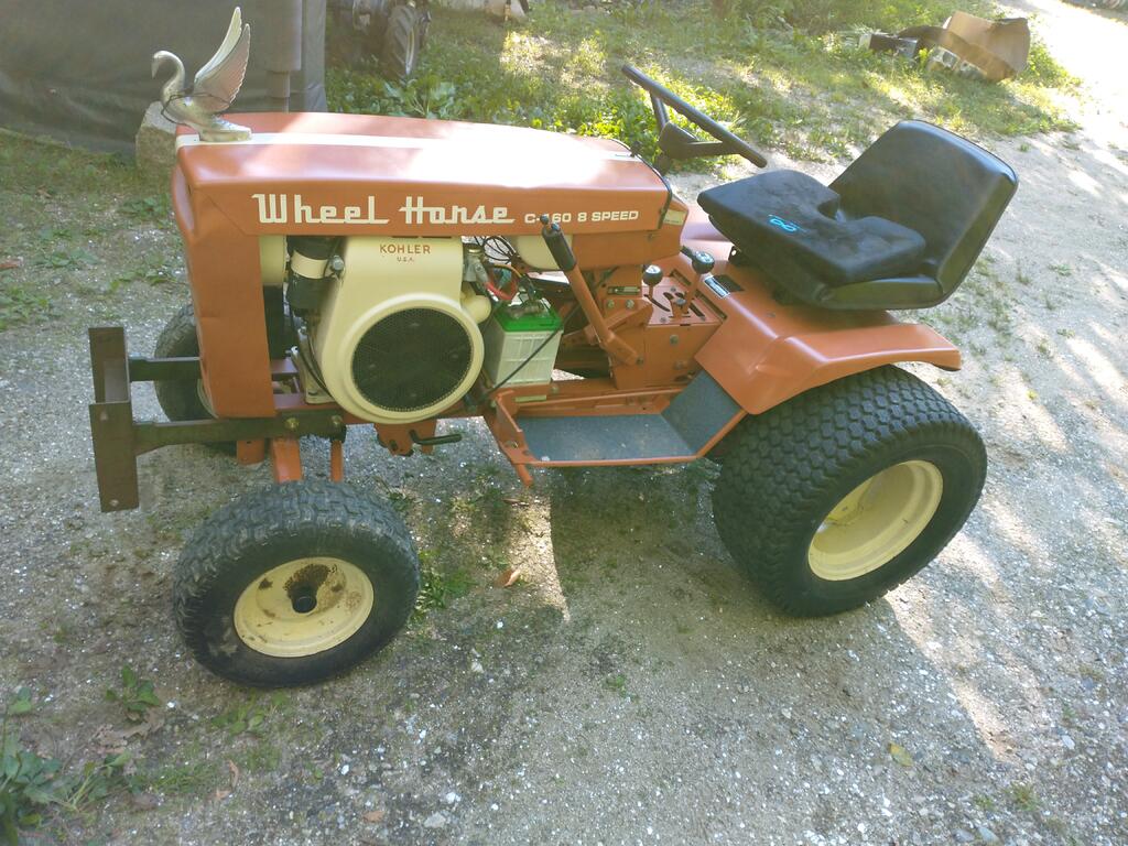

ebinmaine 80,388 #110 Posted October 12, 2021 1 minute ago, WheelhorseBob said: Hadn’t thought of it. None of my others have anything like that. Any pictures? Eehhrrrr. Not a good one of course. Zoom in on the back of the hood by the steering wheel. There's a little black stripe there. It's a U shaped black molding that slides over the edge of the metal. 2 Share this post Link to post Share on other sites
WheelhorseBob 1,550 #111 Posted October 13, 2021 I like it where do you get it? 1 Share this post Link to post Share on other sites

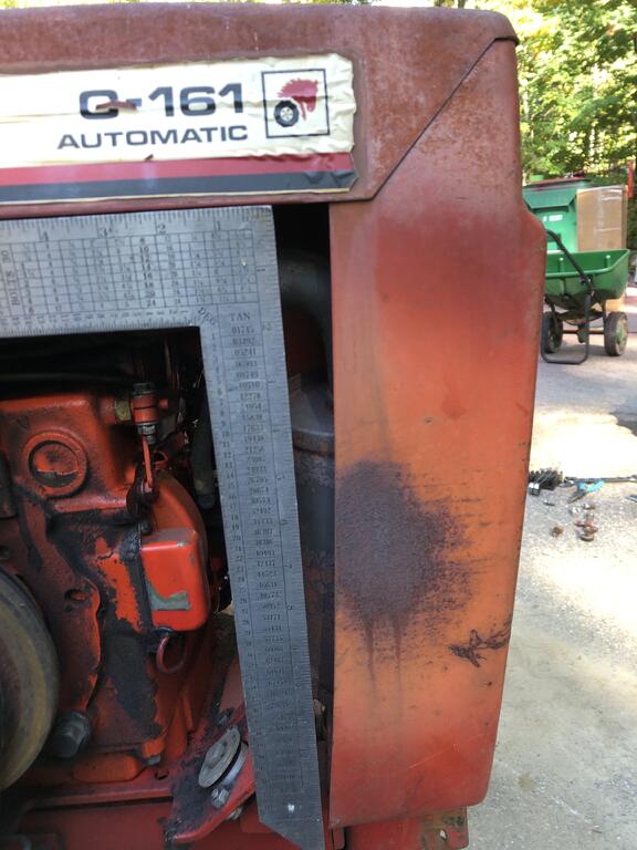

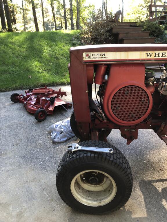

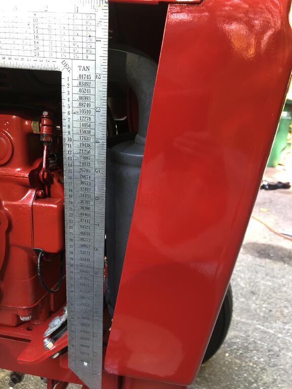

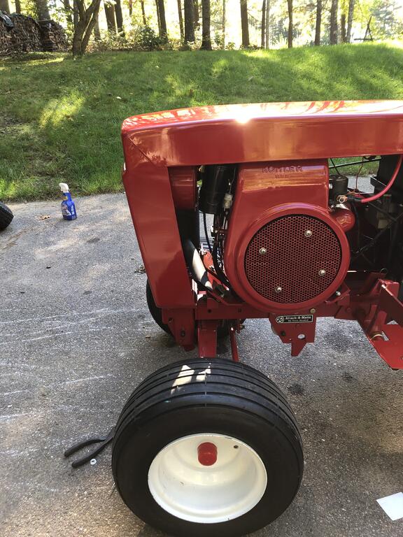

WheelhorseBob 1,550 #116 Posted October 13, 2021 On 9/23/2021 at 6:35 PM, Lee1977 said: The top piece of the hood stand was different on the 78 and 79 models with the old C-series hoods. Winner winner chicken dinner. Lee when you first posted that I went out and measured everything. Everything measured identical. Length, height, width, bolt spacing, all of it. I bolted it up today and well it is too short. But it measures the same. Took me at least 30 minutes with a tape and framing square to figure out what is wrong. Those sneaky Wheel Horse engineers put more angle on the way the front grill mounts effectively pulling the hood forward 1/2-3/4”. I really should just put this thing away till spring. I wanted it done this week but my old hood is rotted through. Wednesday the 13……I feel like the Blackhood gods had it in for me! You live and learn and I’m still learning…. 1 Share this post Link to post Share on other sites

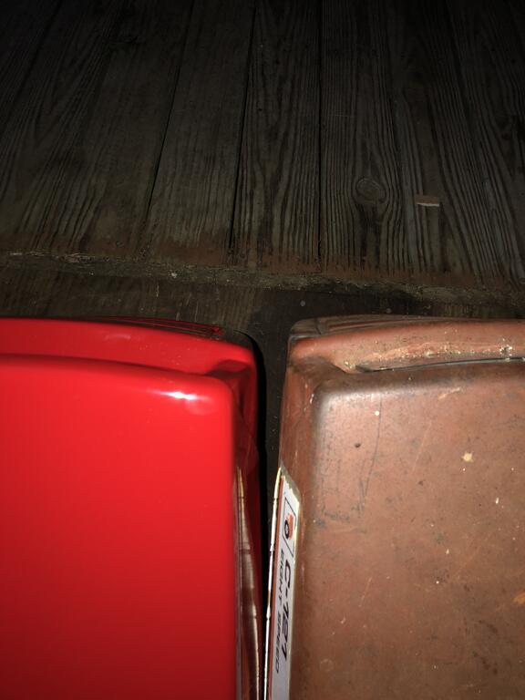

WheelhorseBob 1,550 #117 Posted October 13, 2021 Another perspective…. 2 Share this post Link to post Share on other sites

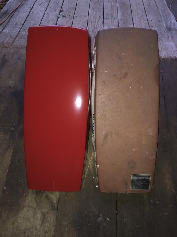

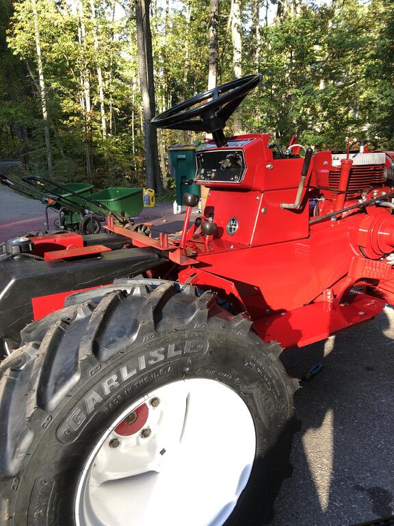

WheelhorseBob 1,550 #120 Posted October 13, 2021 Another shot of the hoods…. 2 Share this post Link to post Share on other sites

Thor27 892 #124 Posted October 15, 2021 (edited) Bob, this may not be so bad. if you take the hinges off the hood and set a rag on the front hitch, can you fit and latch the hood with out interference? There is not much to the hinge, should be able to modify or duplicate . Or, How about moving the hinge pivot rod to the rear hole in the front hitch, then drill a new hole behind it for the stop rod. Maybe even weld up the holes on the (or better yet, another) front hitch, re drill where they need to be, may need to enlarge the angled cut on the front of the hitch slightly. Edited October 15, 2021 by Thor27 not good with werds 2 Share this post Link to post Share on other sites
