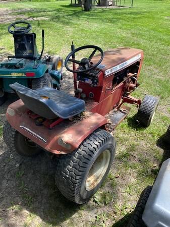

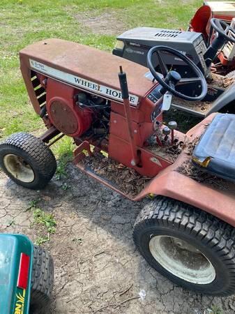

Crazyredhorse 296 #1 Posted May 15, 2021 What do you guys think is this one you guys would bother fixing up or should I find a better model kinda like to have a model to put on blower. no deck tho.guessing it has electric start but could get cheep. Share this post Link to post Share on other sites
Herder 2,356 #2 Posted May 15, 2021 Depends on how cheep. Personally I run a snow thrower on a hydro with a hydraulic lift. The snow throwers are a bit heavy when lifted manually. I also stay away form shaker plate engines. The rubber mounts can allow the engine to move around and cause damage to the drive belt. The rubber mounts can be replace with solid ones. If it runs and doesn't smoke and the transaxle is good, shoot for a good price. Best of luck. 1 Share this post Link to post Share on other sites
stevasaurus 23,884 #3 Posted May 15, 2021 That looks like a solid, complete horse. Plenty of power for a blower, and it looks like it would clean up nicely. If the blower is too heavy, they make helper spring kits for the lift. If it runs, a 10 horse Kohler is a good engine. It is electric start. and a good chance the transmission if OK. Up to you, I don't know what cheap means to you...I know what cheap means to me. How close are you to Elgin, Ill?? 1 Share this post Link to post Share on other sites
Crazyredhorse 296 #4 Posted May 15, 2021 I'm close to 94 and state line.but I wouldn't give him more than a 100 for it without a deck 1 1 Share this post Link to post Share on other sites
clueless 3,440 #5 Posted May 15, 2021 That's a hundred dollar tractor all day long even with out a deck. Hell even if it doesn't run. 5 Share this post Link to post Share on other sites
Herder 2,356 #6 Posted May 15, 2021 Agreed, a hundred is a good price. I've paid more for less!! Share this post Link to post Share on other sites
Pullstart 71,522 #7 Posted May 15, 2021 A good running 10 horse is worth that. For quite some time, a C-101 was the largest in my small herd (back then) and easily tackled chores. Share this post Link to post Share on other sites

Crazyredhorse 296 #9 Posted May 16, 2021 ok didnt realize it wasn't hydro.maybe hold out for somthing a little more beefy.maybe I'll pick it up just for kicks if it's cheap enough. still waiting for him to get back to me.but dont think it's one to dump money into. Share this post Link to post Share on other sites
Pullstart 71,522 #10 Posted May 16, 2021 The one you posted is an 8 speed. Ed suggested looking for a hydro Share this post Link to post Share on other sites
