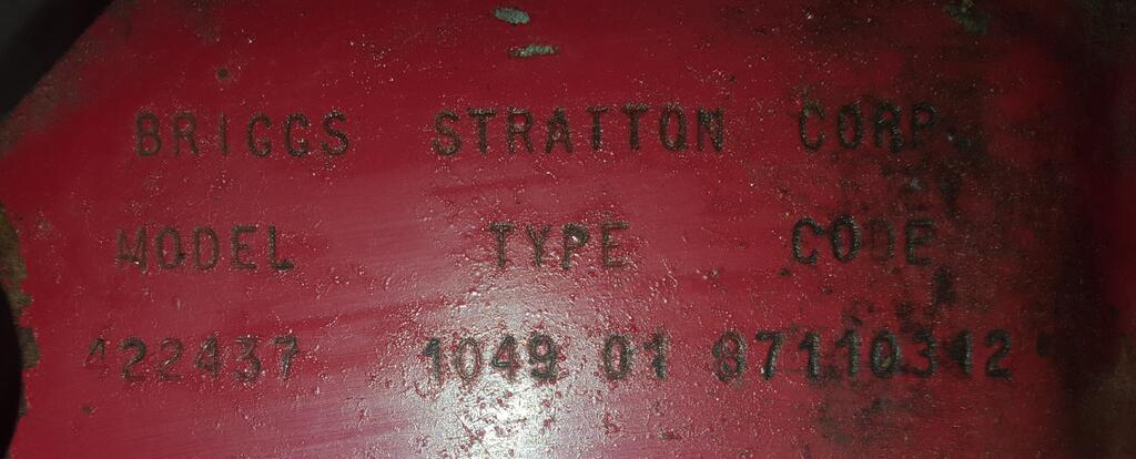

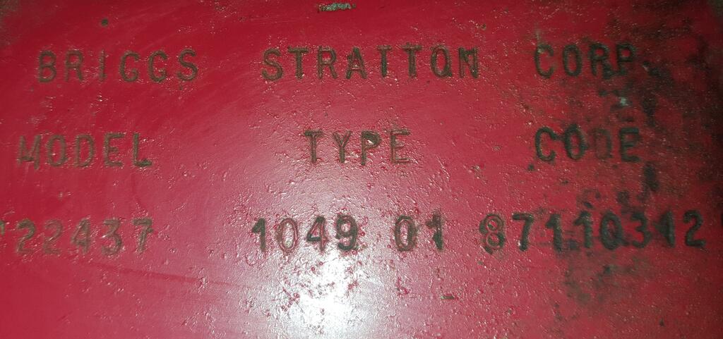

Gregor 4,848 #2 Posted May 9, 2021 Found the numbers. Guess I was looking for a decal or tag somewhere. Share this post Link to post Share on other sites

pfrederi 20,891 #5 Posted May 9, 2021 Your pic cut off the first digit. it is easy to find B&S if you have the complete model# 1 Share this post Link to post Share on other sites
Gregor 4,848 #6 Posted May 9, 2021 20 minutes ago, pfrederi said: Your pic cut off the first digit. Duh You are right. I have the shroud off now, easier to see. Lots of diagrams out there. 1 Share this post Link to post Share on other sites
