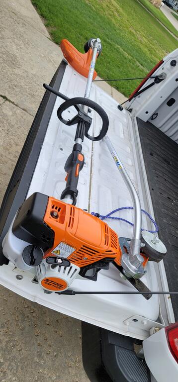

haydendavid380 759 #8 Posted May 9, 2021 (edited) Picked up the KM111r and the string trimmer and edger. I could be wrong, but the gear case looks sealed. I thought I remember them having a bolt on the side to add grease, but this is solid Edited May 9, 2021 by haydendavid380 1 Share this post Link to post Share on other sites

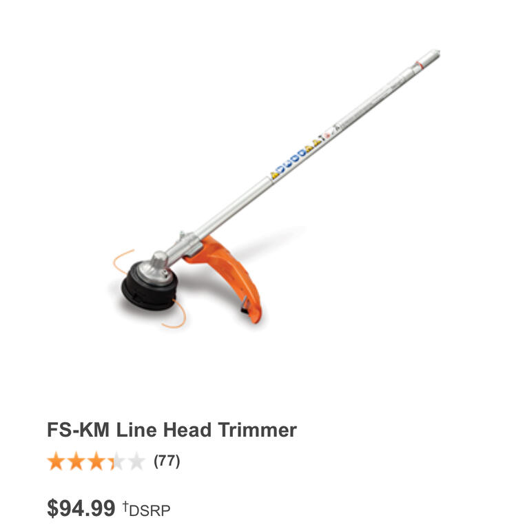

19richie66 17,932 #12 Posted May 11, 2021 Trip to the stihl dealer could fix that. If I remember correctly, it was right at $100 for the straight shaft trimmer or edger heads. Share this post Link to post Share on other sites
Jeff-C175 7,211 #13 Posted May 11, 2021 2 hours ago, 19richie66 said: it was right at $100 for the straight shaft trimmer or edger heads. Was that just for the head? I know those are simple to replace, and so is the entire shaft interchangeable which is what I would need to do. I did ask the dealer last time I was there and they said NO, but I knew he just wanted to sell me a new trimmer. But I just got this one late last year and it's 'like new'. The guy I got it from rarely used it because he didn't like it so much. And then it needed a new carburetor which I took care of. The cheap chinese one I got is working fine. The old one is probably still good, I kept it, if this one craps out I'll clean up the old one and reinstall. It was EXTREMELY hard to start, probably just the primer circuit. Do you know off hand which model I need to get the parts for? I think it's the FS-85 that has the straight shaft? ( I'm going to do some Google-Fu and see what I can find out. ) 1 Share this post Link to post Share on other sites
19richie66 17,932 #14 Posted May 11, 2021 (edited) The curved shaft only has a bearing at the bottom while the straight shaft has a pinion gear setup with a grease port. This is the one I have. Curved shaft is a wound wire shaft and the straight is a solid rod. Edited May 11, 2021 by 19richie66 Share this post Link to post Share on other sites
Jeff-C175 7,211 #15 Posted May 11, 2021 2 hours ago, 19richie66 said: Curved shaft Yeah, I would need the whole thing though, that's just the Kombi part. To change from the curved to the Kombi, or the regular straight, I would need all the way from the motor on down. Share this post Link to post Share on other sites
19richie66 17,932 #16 Posted May 11, 2021 2 hours ago, Jeff-C175 said: Yeah, I would need the whole thing though, that's just the Kombi part. To change from the curved to the Kombi, or the regular straight, I would need all the way from the motor on down. Ok I understand now. Looked back and different poster from original yeah you would need it all. Check local classifieds. May find a decent used one you could swap out the shafts Share this post Link to post Share on other sites
