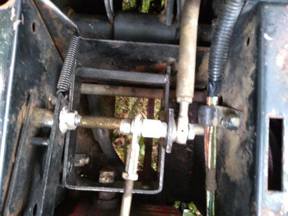

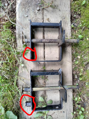

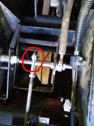

Chestnut 315 #132 Posted October 6, 2021 (edited) Oops- posted this on the wrong thread. meant to post on "what have you done today! Worked on the 520H snowblower tractor again. I started out just planning to adjust the brake because it was so tight park brake wouldn’t engage. Then noticed the drive wasn’t returning to neutral when pushing the brake pedal. Seems the cam bearing and the pin it rides on were missing from the motion control cam. Looks like a bad weld didn't survive. Brake also didn’t seem to be working too well. Got some used parts and dove in. PO seems to have “adjusted” the motion control mechanism by eliminating the lock nut and leaving lots of slack in the pivot bolt and then adjusting the linkage length to make up for the misalignment. It took lots of adjustment but I think I got everything lined up and adjusted correctly. Brake the same thing except it doesn't have a lock nut, Brake still doesn’t feel like it holds very well even though there’s plenty of lining left. Anyone have insight on that? Next up are the charging system (Checking all grounds - charging voltage seems high) and the rear balance weights. Edited October 6, 2021 by Chestnut wrong thread 1 Share this post Link to post Share on other sites

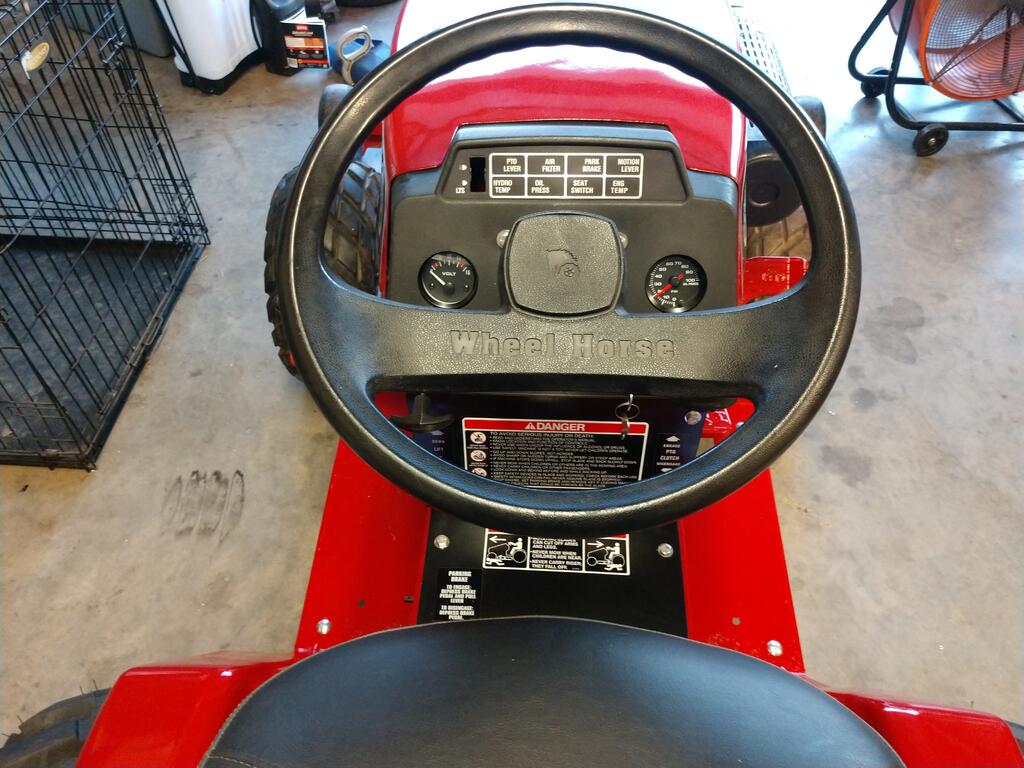

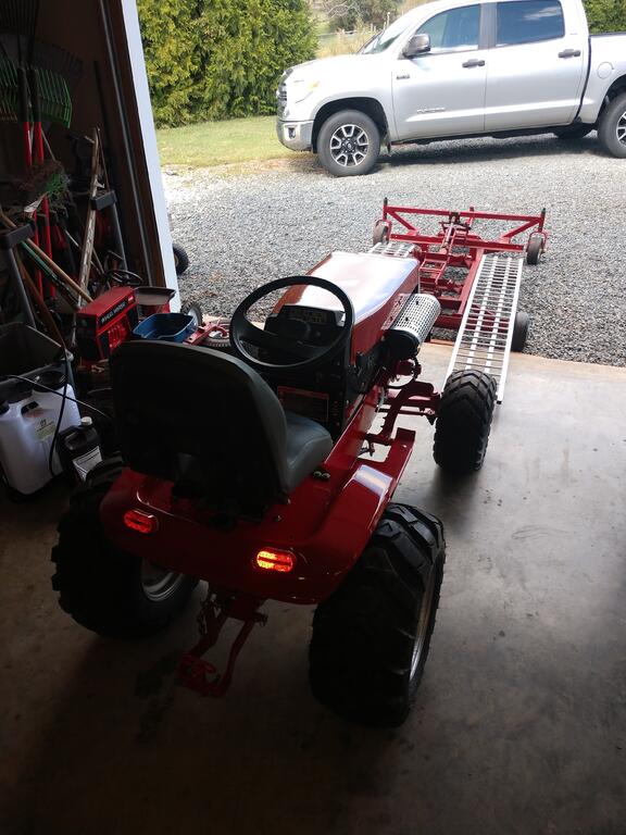

kpinnc 18,963 #133 Posted October 11, 2021 Well I got it down off the stand, but still waiting on a couple parts. Carb needs a throttle shaft, and my hood and fender decals will be here this week. Waiting sucks! One thing I can say is the seat might be the most comfortable one I've ever had on a tractor! 4 Share this post Link to post Share on other sites

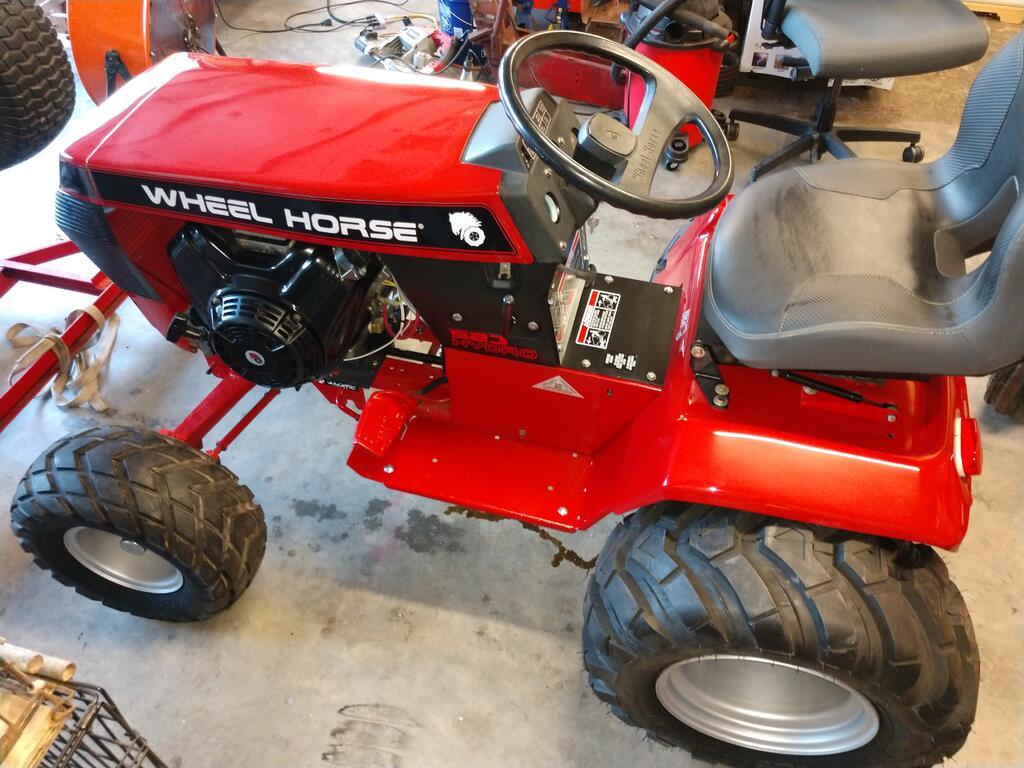

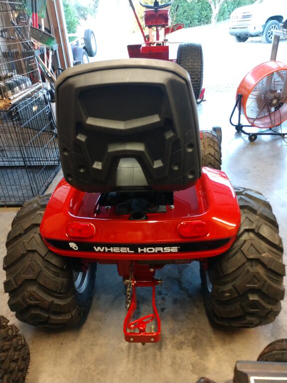

kpinnc 18,963 #134 Posted October 13, 2021 Still waiting for the throttle shaft, probably next week when it comes, but my steeeekers came today! Might name this thing Big Sexy! Also missing my headlight switch.... But nowhere in this machine is the word "Toro"! 2 4 1 3 Share this post Link to post Share on other sites
Bill D 3,156 #135 Posted October 13, 2021 2 hours ago, kpinnc said: Still waiting for the throttle shaft, probably next week when it comes, but my steeeekers came today! Might name this thing Big Sexy! Also missing my headlight switch.... But nowhere in this machine is the word "Toro"! I love everything about that machine. I wish you were closer, I would love to see it in person. 4 Share this post Link to post Share on other sites
kpinnc 18,963 #136 Posted October 13, 2021 (edited) 29 minutes ago, Bill D said: I love everything about that machine. I wish you were closer, I would love to see it in person. Thanks Bill! I'm very pleased with it so far. Definitely one of the better restomods I've done. Pure luck, and letting a bodyshop paint the hood and fender! Edited October 13, 2021 by kpinnc 2 Share this post Link to post Share on other sites

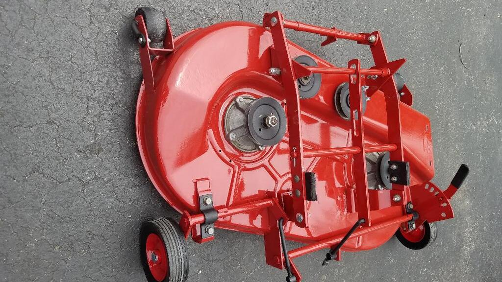

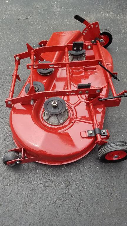

Brockport Bill 2,478 #138 Posted October 13, 2021 i have done a number of deck rehabs myself but for my own original 37 inch SD that goes with my original 312-8, I chose to go to body shop like you did with your hood and fender -- comes back looking considerably better 4 Share this post Link to post Share on other sites
kpinnc 18,963 #139 Posted October 13, 2021 16 minutes ago, Brockport Bill said: i have done a number of deck rehabs myself but for my own original 37 inch SD that goes with my original 312-8, I chose to go to body shop like you did with your hood and fender -- comes back looking considerably better I had a 37 once, and it was probably the best cutting deck of anything WH that I ever had. Take care of it, it's a great one! 2 Share this post Link to post Share on other sites
Brockport Bill 2,478 #140 Posted October 13, 2021 i have a bagger unit witht the 312-8 and the 37 SD -- u r right - great cut -- and especially awesome for fall leaves --- it is a life saver "vacuuming " up the yard leaves over the many weeks from sept to Nov 4 Share this post Link to post Share on other sites

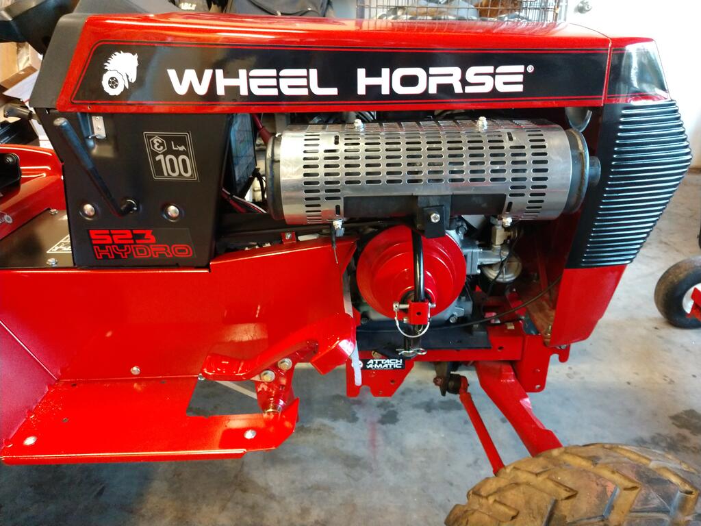

kpinnc 18,963 #142 Posted October 13, 2021 (edited) 2 hours ago, WheelHorse520H said: 10 hours ago, kpinnc said: "Toro"! Atta boy. Stop posting pictures…your making me too jealous! Ok, ok..... I'll get better ones next week when it actually runs. Just one more! Edited October 13, 2021 by kpinnc 1 3 2 Share this post Link to post Share on other sites

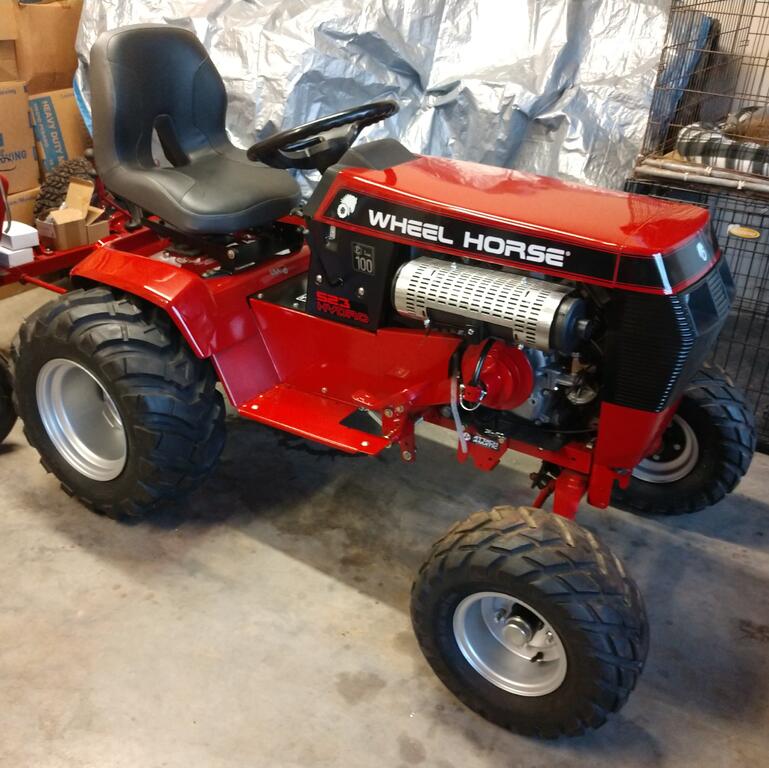

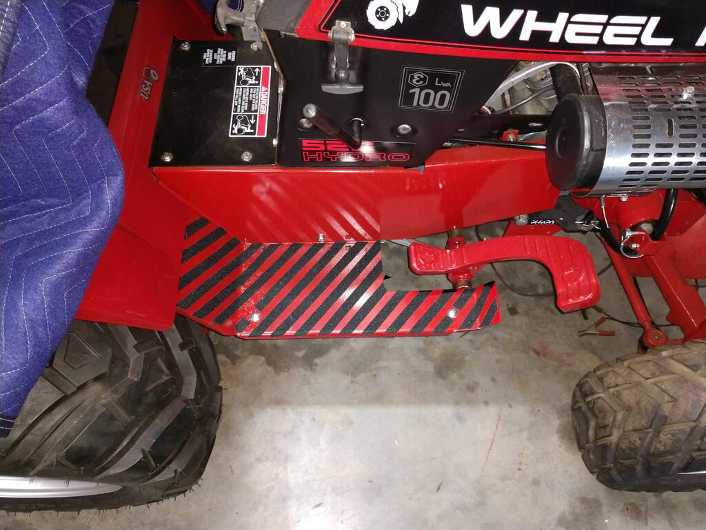

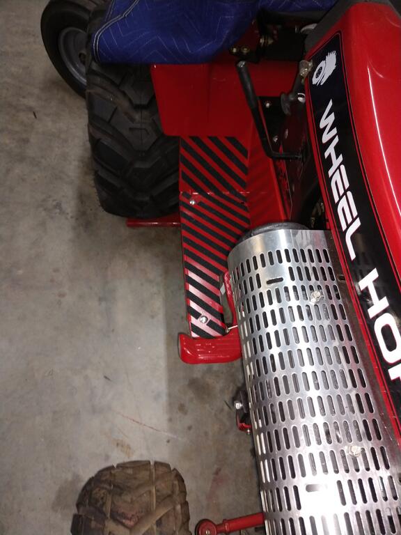

kpinnc 18,963 #148 Posted November 25, 2021 Haven't had much time for this one lately because I'm focused on my FILs Charger. Found some grip tape I forgot I had. Not enough to fully cover the footrests, so I tried what you see in the pics. Haven't made up my mind on it yet, but thought I'd throw up a pic anyway... 4 4 Share this post Link to post Share on other sites
ebinmaine 80,695 #149 Posted November 25, 2021 2 hours ago, kpinnc said: Haven't made up my mind on it yet, I like it because it's different but I'd be concerned about it coming off the steps fairly quickly. Lots of edges to wear off and catch on. 3 Share this post Link to post Share on other sites
wallfish 20,618 #150 Posted November 25, 2021 Looks pretty good. Clear nail polish on the edges? It's tough, hard and won't yellow 3 Share this post Link to post Share on other sites
