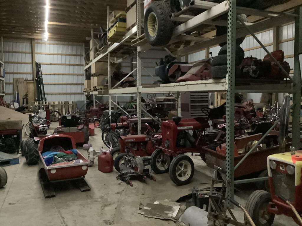

Pullstart 70,103 #2 Posted May 6, 2021 I’ll show you my dumpster about 45 minutes north of ya for the plow and weights! 1 2 2 Share this post Link to post Share on other sites
Pullstart 70,103 #3 Posted May 6, 2021 (edited) C-161 is a beast of a runner too by the way. I don’t think I have a good motion control cam, but I might have a muffler... Is that the Briggs twin or a Kohler single? If it’s the Briggs, I have all the engine related stuff you need Edited May 6, 2021 by pullstart Share this post Link to post Share on other sites

Pullstart 70,103 #14 Posted May 7, 2021 2 minutes ago, jay bee said: My dumpster is a lot closer than @pullstart’s but he has a lot more room than most of us to store all his parts and pieces. not if I don’t tidy the place up soon! 1 2 Share this post Link to post Share on other sites
