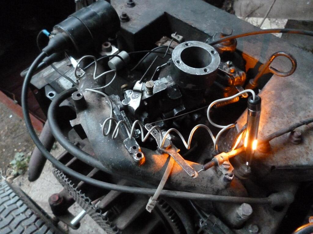

wheeliepower 141 #8 Posted May 5, 2021 yes, it is a kohler kt-17 twin, model one no spark if I connect the + battery withe the + from the coil with a cable directly I have a check stick with a lamp, which I also have connected too between one spark plug and the spark cable, but there is no light too surprising, when I used it 3/4 year ago, everything was still working. now I wanted to mow a meadow, nothing works anymore Unfortunately in Germany wheel horse are very rare and I can't just try a part from a neighbor I have to see if I still have an ignition coil to test I have measured the resistances of the coil, they are OK (primary and secondary) <<< sorry for my bad english, only my friend GOOGLE help me to translate >>> 1 Share this post Link to post Share on other sites

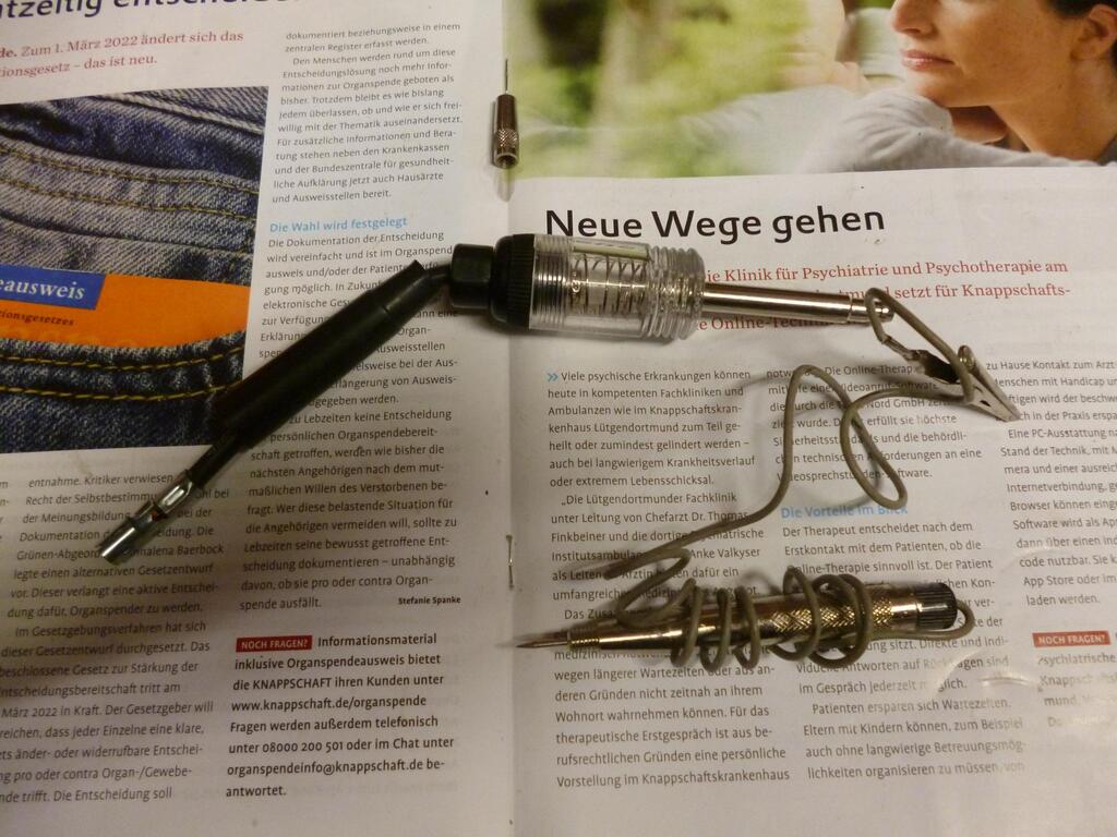

pfrederi 20,533 #11 Posted May 5, 2021 (edited) Have you cleaned your points?? Connect your test light to good ground and touch the other end to the small negative terminal on the coil. When you crank the engine the light should flash on and off. If it doesn't clean and reset the gap on your points....018" Edited May 5, 2021 by pfrederi 1 1 1 Share this post Link to post Share on other sites
wheeliepower 141 #12 Posted May 5, 2021 (edited) yes, I cleaned If I clip on the test lamp (as you wrote ) and try to start the engine, the light stays on forever (see pic) what do you mean with => "...........If it doesn't clean and reset the gap on your points" Edited May 5, 2021 by wheeliepower Share this post Link to post Share on other sites
Jeff-C175 7,207 #13 Posted May 5, 2021 (edited) 10 minutes ago, wheeliepower said: If I clip on the test lamp (as you wrote ) and try to start the engine, the light stays on forever (see pic) If you are actually connected to the NEGATIVE terminal of the coil, which is the same one that the points are connected to, when the points CLOSE the light MUST go out. What this means is that your points are never closing if the light stays lit all the time. Could be: Points still dirty Improper adjustment Broken wire or bad connection from points to coil You don't have to crank the starter for this test, just turn the key to " ON " and turn the flywheel by hand. Edited May 5, 2021 by Jeff-C175 1 Share this post Link to post Share on other sites
wheeliepower 141 #14 Posted May 5, 2021 so I turn off the spark plugs, then I is easier to turn the flywheel from hand I connected the lamp, I turn the key to "on" the lamp shines I turn the flywheel several turns but the lamp always shines 1 Share this post Link to post Share on other sites

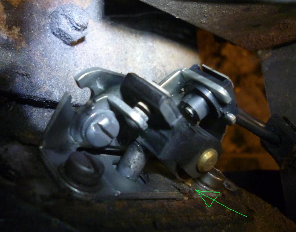

wheeliepower 141 #20 Posted May 5, 2021 (edited) Engine runs the arrow shows a point of contact where a piece of metal was pinched no idea where does that part come from no matter, wheelie is running now adjust the carburetor tomorrow, I also suspected and dismantled completely many thanks all the people here, who tried with me to solve the problem regards from germany manfred Edited May 5, 2021 by wheeliepower 2 Share this post Link to post Share on other sites

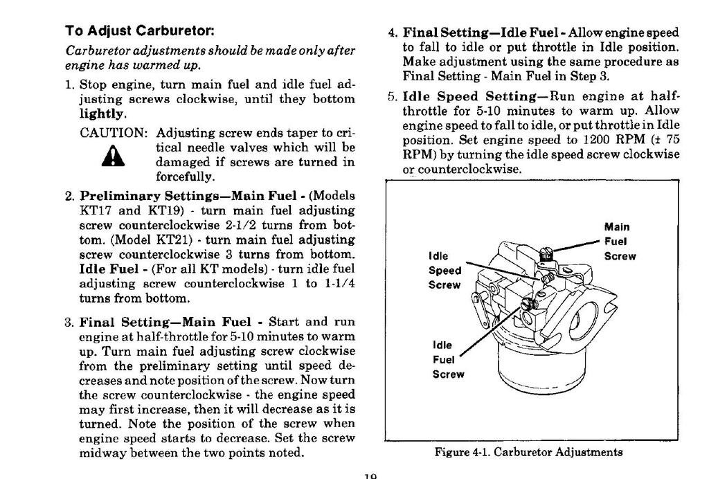

wheeliepower 141 #24 Posted May 5, 2021 (edited) I have download the english manual for kohler engines now i just have to translate with hands and feet and google translate Edited May 5, 2021 by wheeliepower 1 2 Share this post Link to post Share on other sites
