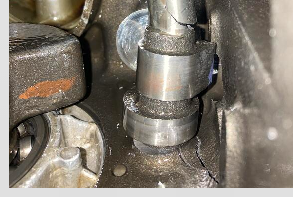

Maxwell-8 4,371 #103 Posted May 27, 2021 (edited) You ain't gone fix that with JB weld. Spun main bearing such a shame, maybe ran with a leaking carburetor before you got it. Gas mixes with the oil, washing of all the oil. Blew a 1971 Briggs 8hp that way. Also the hole the oil has to come trhu was very small on it for a splash lube engine. Could it also be, that the oilsplasher bents over time not giving the right angle? Edited May 27, 2021 by Maxwell-8 1 Share this post Link to post Share on other sites

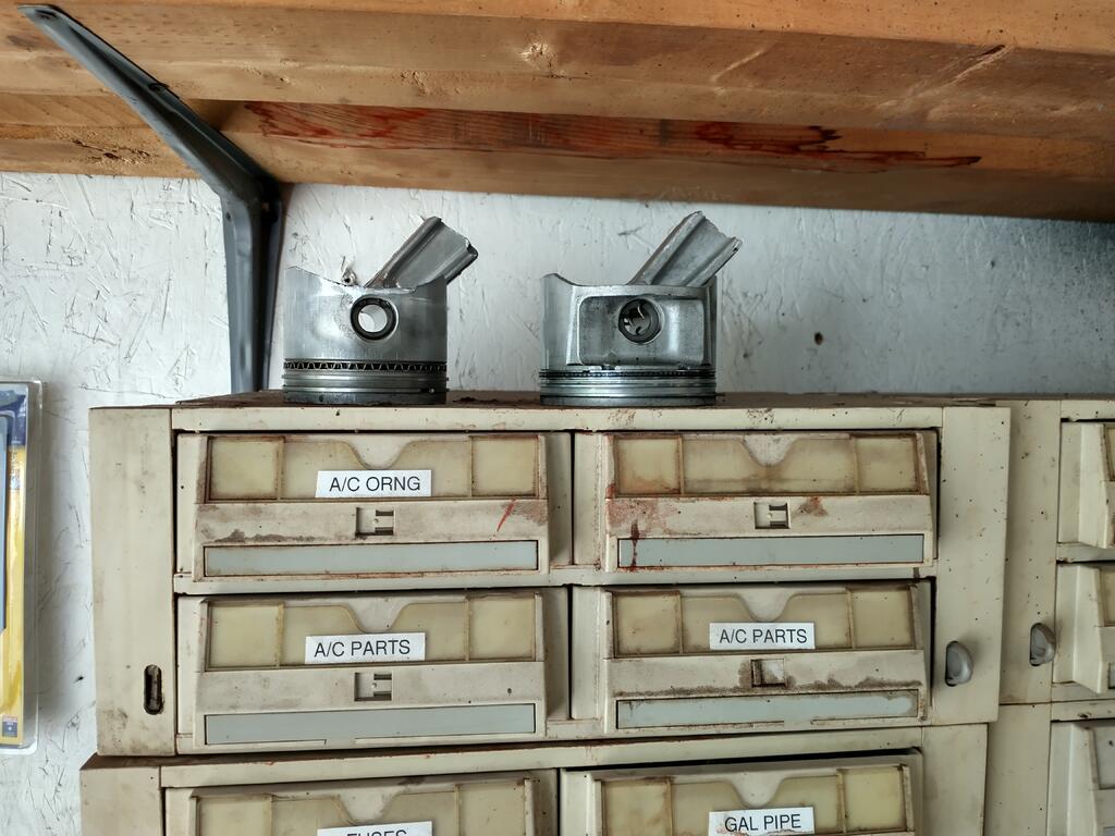

squonk 48,272 #108 Posted May 27, 2021 2 hours ago, SylvanLakeWH said: You win! I’ll send you the pieces for a trophy!!! I've got a "Shelf of Shame " already started. 2 broken rods with pistons attached! 1 Share this post Link to post Share on other sites
Maxwell-8 4,371 #109 Posted May 27, 2021 33 minutes ago, squonk said: I've got a "Shelf of Shame " already started. 2 broken rods with pistons attached! Mine consists out of just one. Not planning on expanding it anytime soon. 1 Share this post Link to post Share on other sites
Handy Don 17,614 #110 Posted May 27, 2021 @squonk, how many drawers say "A/C Parts"? Share this post Link to post Share on other sites
squonk 48,272 #111 Posted May 27, 2021 4 minutes ago, Handy Don said: @squonk, how many drawers say "A/C Parts"? Just those 2 drawers plus the O ring drawer Share this post Link to post Share on other sites
Handy Don 17,614 #112 Posted May 27, 2021 Just now, squonk said: Just those 2 drawers plus the O ring drawer My grandfather had at least 5 coffee cans labeled "nails". Worked with a newbie, wet behind the ears engineer who every time he printed a document he'd been working on he wrote "latest version" on the top. He had several on his desk at any one time. Finally I couldn't help but suggest he start writing "old version" on the one he was working on before picking up the new one. "Hey, that's a good idea!" said he. Turned out to be a crackerjack engineer after he got his feet under him! 1 Share this post Link to post Share on other sites

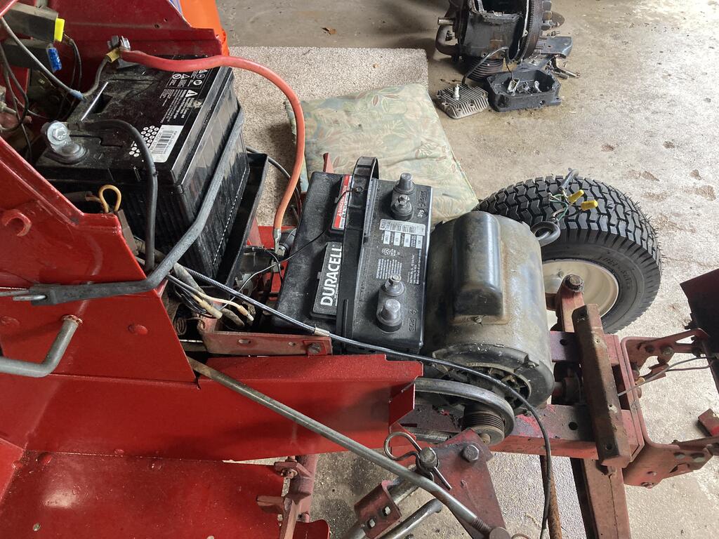

SylvanLakeWH 32,753 #113 Posted May 27, 2021 (edited) Ok folks... Time for crazy... But I am serious with the question. I have two electric motors (1 off a compressor, 1 still in use ancient grinding wheel) that are 1.5 hp and ~1.0 hp respectively (supposedly)... Can I use an inverter and 1 - 3 car batteries to create a very low powered electric tractor with one of the motors to just tool around on? I'm thinking 12 - 36 v on a 1200 - 1500 w inverter (or something like that). I would use the WH standard clutching - so motor would be "on" or "Off". No controller. This would be for fun - not work. Kid rides etc... speed is not needed. Thoughts? Things to consider? Appreciate your ideas cuz this electric stuff is foreign to me... (Including all 's...) Kinda like this: Edited May 27, 2021 by SylvanLakeWH Added pic Share this post Link to post Share on other sites

Handy Don 17,614 #115 Posted May 27, 2021 I'd look to battery powered golf carts as your template. They tend to have 4-6 deep cycle batteries, 24- or 48-volt motors with direct drive (chain or gears) since belts cost energy. The idea is viable on the terms you noted--relatively short range/time between charges and low loading. The inverter is not as efficient as direct drive, and 110v motors vary a lot in efficiency as well. You'll have to do the math on the battery, inverter, math, load equation. Good luck! 1 Share this post Link to post Share on other sites

SylvanLakeWH 32,753 #118 Posted May 28, 2021 1 hour ago, Handy Don said: I'd look to battery powered golf carts as your template. They tend to have 4-6 deep cycle batteries, 24- or 48-volt motors with direct drive (chain or gears) since belts cost energy. The idea is viable on the terms you noted--relatively short range/time between charges and low loading. The inverter is not as efficient as direct drive, and 110v motors vary a lot in efficiency as well. You'll have to do the math on the battery, inverter, math, load equation. Good luck! Appreciate the input! Confirms my thinking. I don’t like math… I tend to and adjust as I go… 1 Share this post Link to post Share on other sites

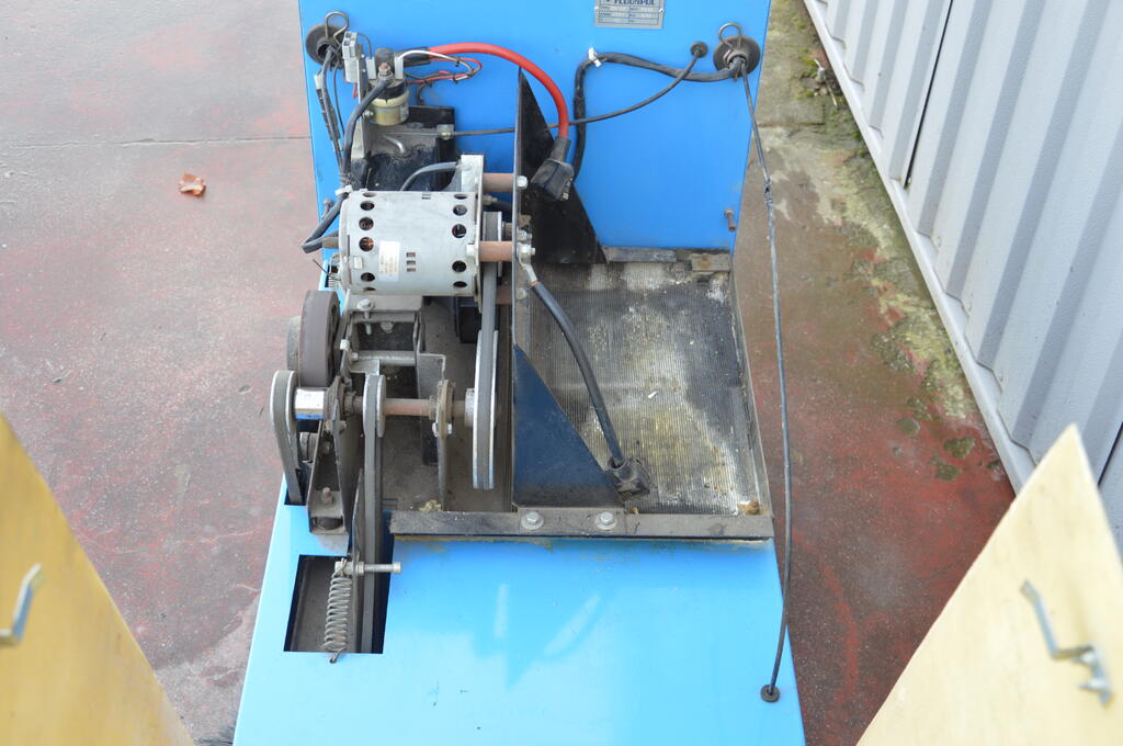

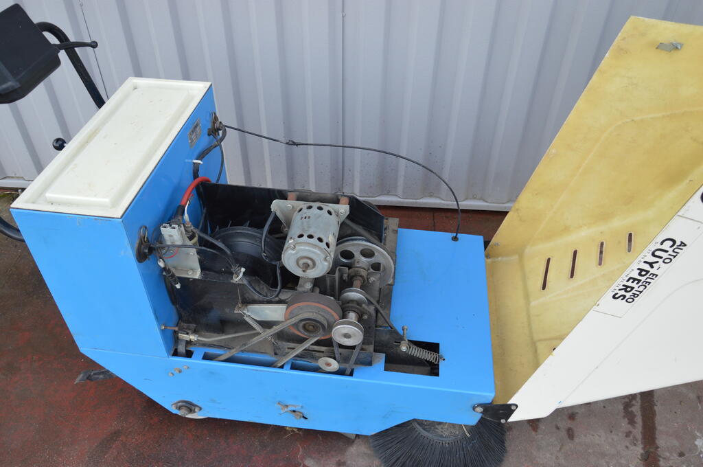

Maxwell-8 4,371 #119 Posted May 28, 2021 (edited) We have a big machine for cleaning the shop/driveway.(self-driven) Uses a 24v motor, the deep cycle battery's went out. so replaced it with 2 car battery's because they are like 4x cheaper. We get well over 1 hour of work out of those 2 car-battery's. And the electric motor is conected with the rest thru..... yup a belt. A car battery is 70A hour 12v, so 840w if it can be drained completly. so 2 battery's can deliver A maximum 1680w or 2.25 hp for an hour. Edited May 28, 2021 by Maxwell-8 1 Share this post Link to post Share on other sites
SylvanLakeWH 32,753 #120 Posted May 28, 2021 @Handy Don and @Maxwell-8 thank you for the input! Do you think a single car battery would be sufficient? Looking at 15-30 minutes max use at a time. Light duty… slow speeds… just up and down street pulling kids… seems like it should be adequate based on the street sweeping example above… With the type motor I’m looking at, can it handle the belt / clutch load? No pto use other than driving… What size inverter would be required? 1500 adequate? Appreciate your input! 1 Share this post Link to post Share on other sites
Maxwell-8 4,371 #121 Posted May 28, 2021 (edited) 10 minutes ago, SylvanLakeWH said: With the type motor I’m looking at, can it handle the belt / clutch load? No pto use other than driving… Normally should not be a problem, they are made for side loads. It has a belt pulley already on it. 10 minutes ago, SylvanLakeWH said: single car battery would be sufficient? Looking at 15-30 minutes max use at a time. I would say, try it, and otherwise, add an extra. But if you go 24v, the wires to the inverter don't need to be that tick. 10 minutes ago, SylvanLakeWH said: What size inverter would be required? 1500 adequate? Would be the smallest you wanne go. is +/- 2hp, but it depends on the watts your motor can put out. Just went back to your first 'electric post. If they are 1.5 hp, you should be good with a 1500w inverter. Edited May 28, 2021 by Maxwell-8 1 Share this post Link to post Share on other sites

Tractorhead 9,218 #123 Posted May 28, 2021 To say it with radio eriwan, in principe yes, but... Instead a 1KW or 1,8KW 24V Motor like ebikes or some E-Scooters using seems to be a much better solution. To have the motor is a option, but to run it via an Inverter is another task. The most cheaper inverters have troubles by starting a bigger E- Motors. that depends also on the phases the motor have. 3 phase motors have a small box aside with 3 jumper rows they be typically described as UVW, where they can be switched with jumperwires on star or triangle connection, depending on the needs. on a 3 phase motor mostly a Start condenser is used to build a missed phase, but this technical clamp have its disadvantages in case of cheap (unstabilized) inverters The starting current can be up to 2-3 times the current the motor needs while it runs. Trapezodial inverters are more worse in Starting e- Motors. A pure Sine inverter is a good base to start, based on a 1 KW motor i would begin with a 2KW Sine inverter as minimum requirements. less Power can run but the reserve is very close this inverter than have to it‘s limit. The inverter with a motor as a load needs a good heat dissipation, because the motor is an inductive load that bring it quick to heat. Some trapezodial inverters dies quick when using with inductive load. That combo under the dashline will be mostly more expensive. The most 24V DC scootermotors i meant runs at 3400RPM, what is similar to an Horizontal Engine, but with just 1-1,8 KW. some also needs 36V ( means three batteries) they should be than charged in parallel and drained in serial. 1 KW is for riding a tractor useful. Because the most Sit on mower drives have sometimes also only 500-1500W as riding Power calculated. That is enough to move a Tractor ( even a wheelhorse) depending on used gear not tooo slow. on a 3 phase Motor i would go also via an frequency converter. So you can regulate even the speed of the motor in a wide rpm band. 1 Share this post Link to post Share on other sites
