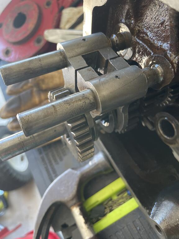

Wellingtontx 69 #129 Posted June 19, 2021 Well this transmission is kicking by rear. Thought I had it but I don’t. Does not appear to want to shift into all gears. Had it all together now back apart. Need some help and advice before I give up. Did install new 2nd/3rd gear and new but in better shape shift forks. New indent balls and spring. The closet fork will not move to the right which would be downward in the case. I guess first of all, should it move downward ? Second, any ideas on how to fix ? The shift fork will move to left, just not right. Share this post Link to post Share on other sites
Wellingtontx 69 #130 Posted June 19, 2021 (edited) Tapping it with hammer won’t get it to move either. back shift fork moved up and down easily Edited June 19, 2021 by Wellingtontx Share this post Link to post Share on other sites
Handy Don 13,810 #131 Posted June 19, 2021 Obstructed. Is the detent ball out of place? 1 Share this post Link to post Share on other sites
Wellingtontx 69 #132 Posted June 19, 2021 I don’t think so since it moves up but I can take it all back apart and see Share this post Link to post Share on other sites
stevasaurus 23,253 #133 Posted June 19, 2021 I would check it. It seems to be the issue. The ball is not in the right place and you are fighting the spring. If the spring is messed up...you should be able to bend it back in shape. 1 Share this post Link to post Share on other sites
Wellingtontx 69 #134 Posted June 19, 2021 Taking all apart now….stay tuned Share this post Link to post Share on other sites
Wellingtontx 69 #135 Posted June 19, 2021 Well done for the day, Frustrated. Messed with the spring and double indent balls about 15 times without success. Whoever designed this system of double indent balls needs to be taken out back and kicked in the shin a 100 times. Idiot engineering. Finally, one of the indent balls shot out and across the garage. Cannot locate and 100 degrees in garage. So done for the day. Might try to reassemble in morning. 1 Share this post Link to post Share on other sites
stevasaurus 23,253 #136 Posted June 19, 2021 Use a 1/8" Allen wrench to push the ball in from the outside hole. The 2nd/3rd shift rail needs to be in neutral in order to push the ball in far enough. Get the 1st/reverse shift rail down onto the Allen wrench and pull the wrench out while pushing down on the shift rail. Watch this video from about the first minute. Share this post Link to post Share on other sites
