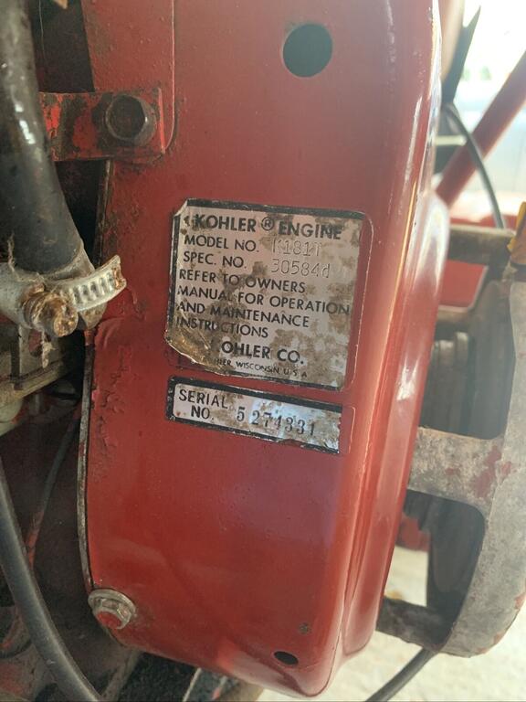

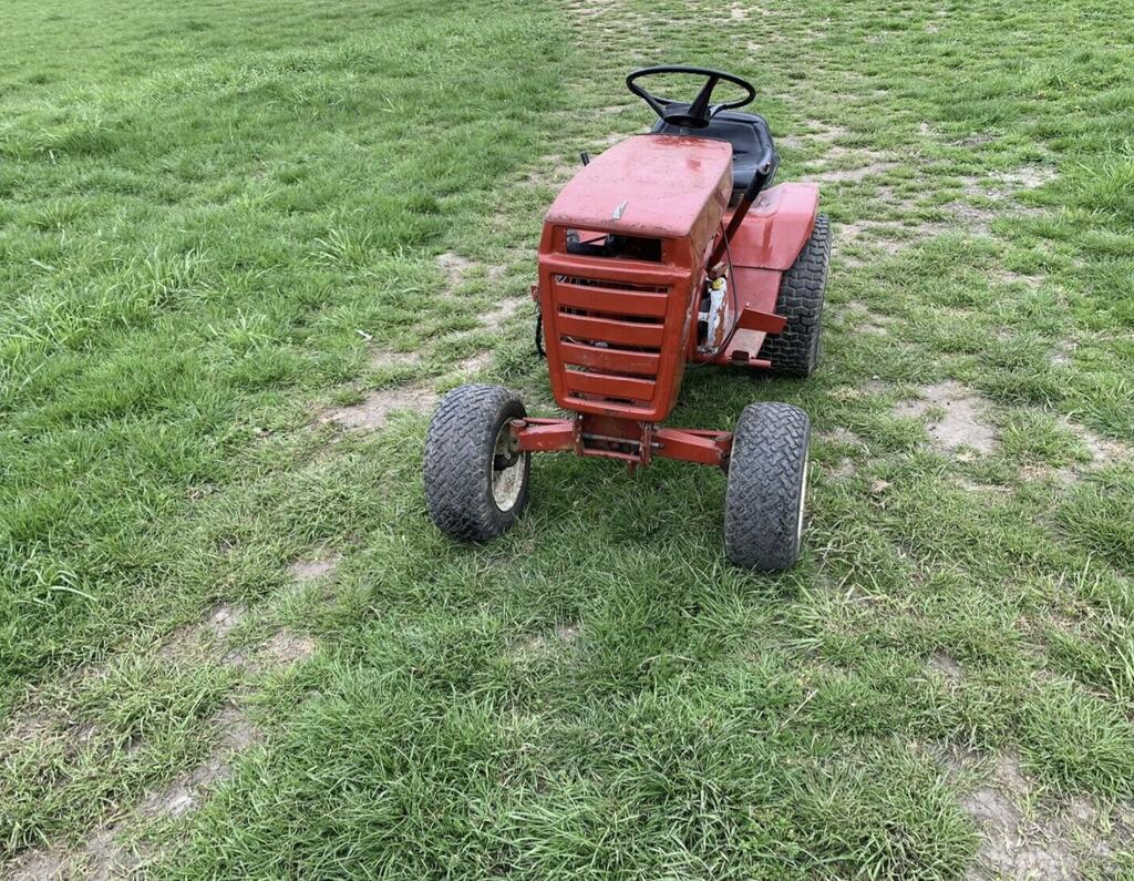

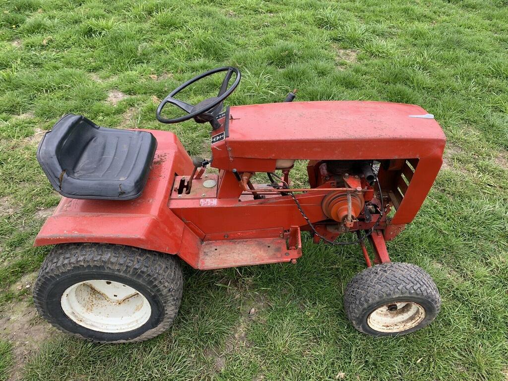

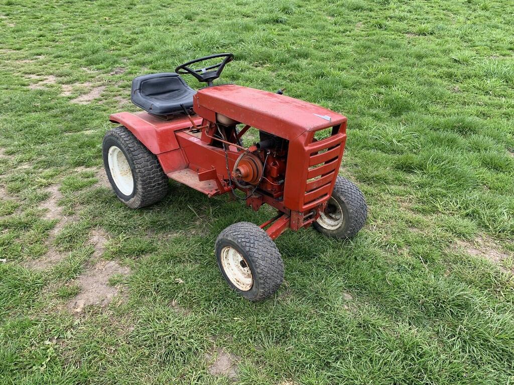

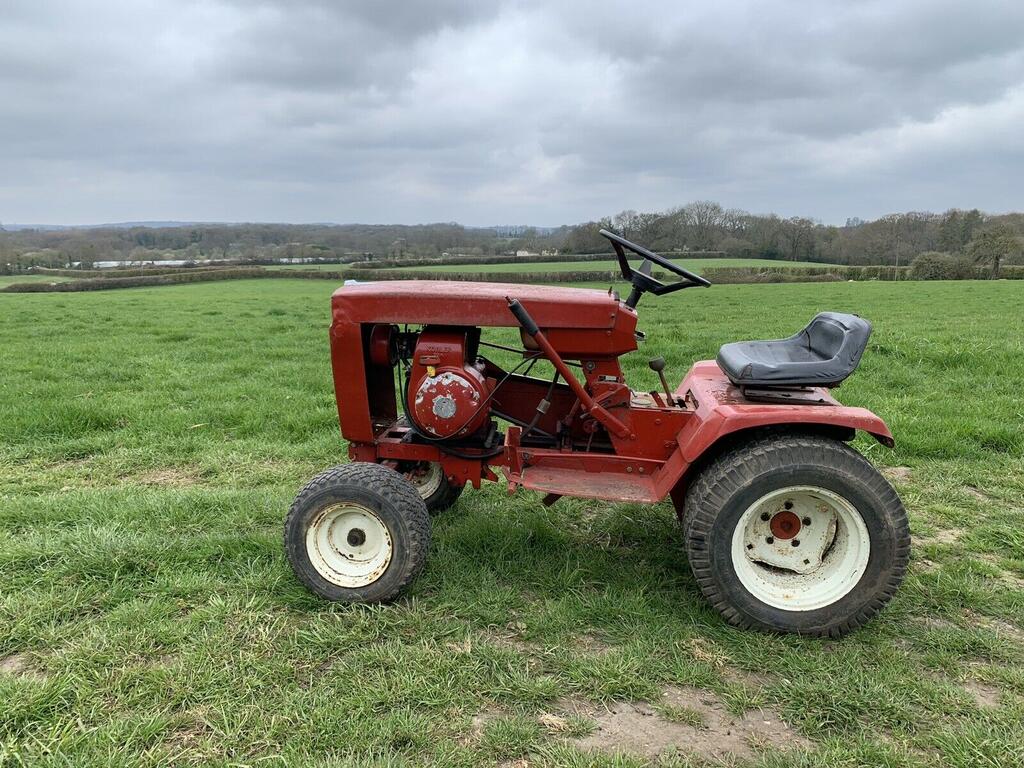

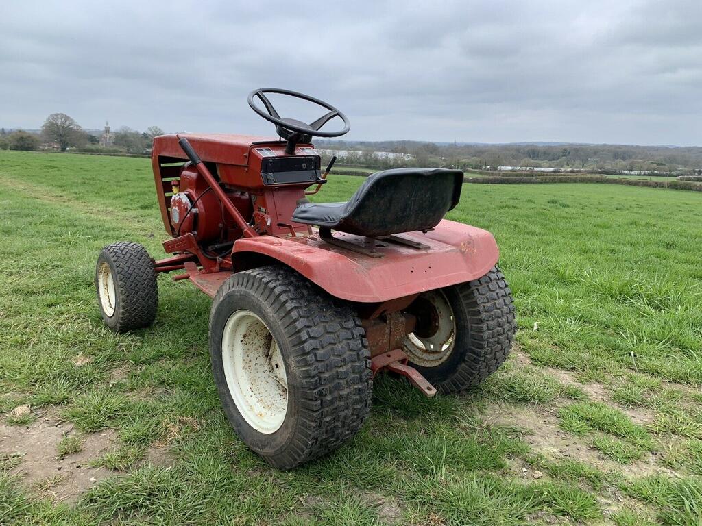

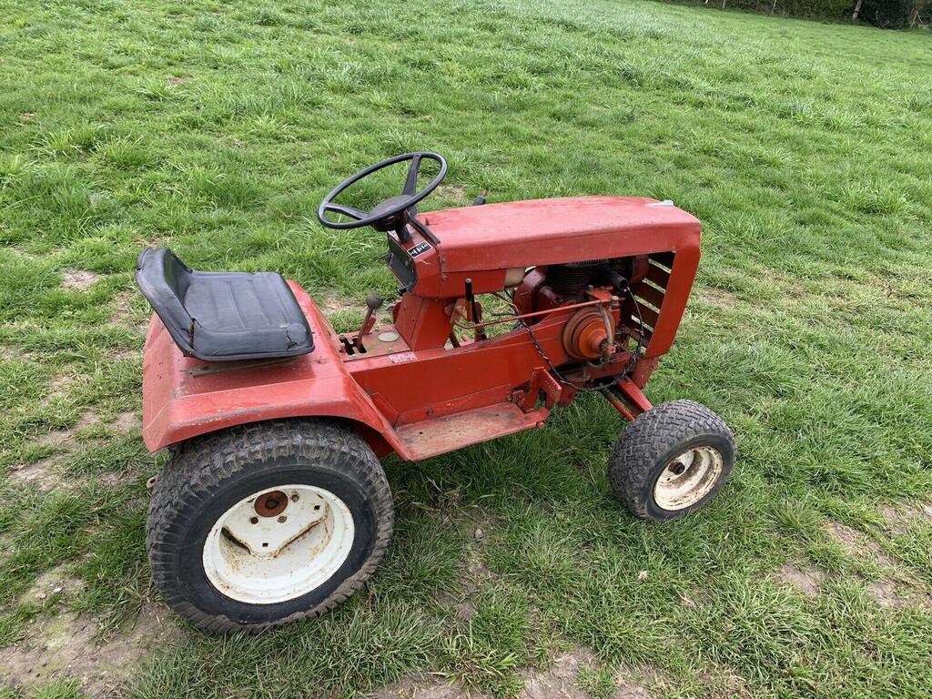

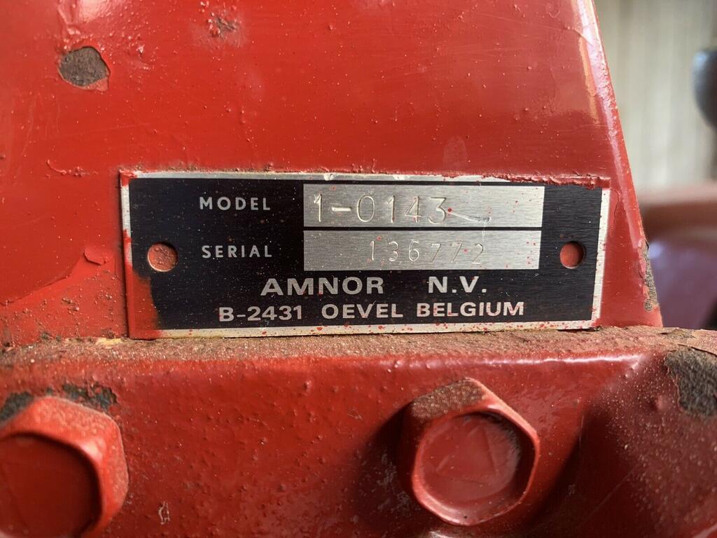

Geoff Cornwall 75 #1 Posted April 24, 2021 Hello all , im new to the site and thought id say hello . My name is Geoff and im from the uk . I have been trying to buy a wheel horse for some time , and thought i would post a few pictures of my new purchase . I have been trying to identify the model and year of manufacture without much luck and was hoping someone may be able to point me in the right direction . Over the coming months I hope to sort a few issues with the transmission , it wont select 3rd gear . The 8 horse kohler engine seems to be good , starts easilly ,and runs without issue . No doubt there are other things i will need help with in the future . Geoff . 6 1 Share this post Link to post Share on other sites

Pullstart 70,105 #4 Posted April 24, 2021 This might be a Commando 800 based on this post: https://www.wheelhorseforum.com/topic/22422-information-on-horses-built-in-belgium/?do=findComment&comment=232458 My daughter has one that’s been slightly modified. They are good runners! Hopefully you can sort out the transmission issue fairly easily. I’d suggest draining it and filling it with diesel fuel or kerosene then running it through all the gears you can... drain, repeat until it frees up some. Lifting the front end as high as possible will ensure the transmission drains completely as there is a hump in the center of the case. Share this post Link to post Share on other sites

gwest_ca-(File Mod) 12,280 #7 Posted April 24, 2021 Suspect these are considered medium frame models with 43-1/2" wheelbase 1974 Commando 800 model 1-0140 Serial numbers that have shown up for the 1-0140 0134631 - Made in Belgium - Located in France 0136814 - Made in Belgium 1974 Commando 800 model 1-0143 - no info available Serial numbers that have shown up for the 1-0143 0136750 - Made in Belgium 0136772 - Made in Belgium - Located in UK with recoil start using Kohler K181T-30584d Serial 5274331 made in 1973 Share this post Link to post Share on other sites
Achto 31,900 #9 Posted April 24, 2021 If the transmission will not stay in 3rd gear, I fear that your gear may be bad. Part # 3523. These are no longer available from Toro but there is a member here that reproduced them. https://wheelhorsepartsandmore.com/product/3523-3rd-gear/ 1 Share this post Link to post Share on other sites
