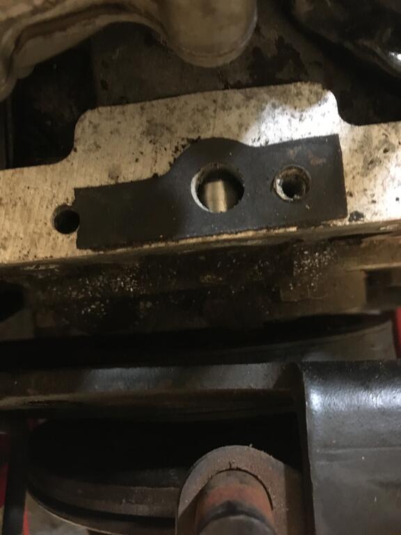

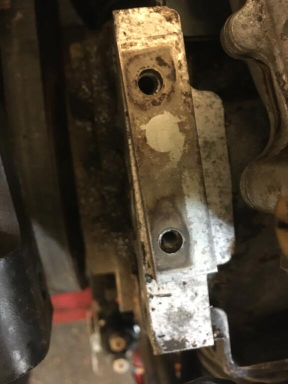

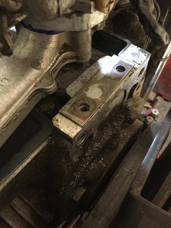

WheelHorse520H 710 #201 Posted August 19, 2021 3 minutes ago, Horse Newbie said: Best of my recollection, my 1194 520H was like this in the area of the PTO engagement linkage... 1. Engine block. 2. muffler mounting bracket 3. PTO linkage bracket/ no spacer such as I see in your pic. I believe it was between #1 and #2 1 Share this post Link to post Share on other sites
Horse Newbie 7,405 #202 Posted August 19, 2021 Just now, WheelHorse520H said: I believe it was between #1 and #2 I guess that is totally possible... I would see how the muffler/ exhaust lines up after hand snugging the bolts in the pipe flanges to the heads, then see if it looks like you have a space to fill between the engine block and muffler bracket. Share this post Link to post Share on other sites
WheelHorse520H 710 #203 Posted August 19, 2021 2 minutes ago, Horse Newbie said: I guess that is totally possible... I would see how the muffler/ exhaust lines up after hand snugging the bolts in the pipe flanges to the heads, then see if it looks like you have a space to fill between the engine block and muffler bracket. I’ll check there, I’ll loosen the PTO bolts and see if there is room. 1 Share this post Link to post Share on other sites
WheelHorse520H 710 #204 Posted August 20, 2021 I found where the piece goes, it’s a little cover over a hole in the engine block. Photos below. I have a ripped gasket for it so I used some gas safe sealant and it seems good. Got it all back together and it has spark but it won’t start. I don’t know what is going on, used an eye dropper and dropped gas into the carb but it still won’t start. PLEASE HELP. Share this post Link to post Share on other sites
