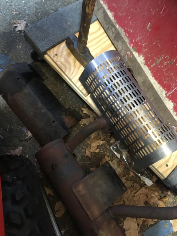

lynnmor 8,915 #16 Posted May 15, 2021 59 minutes ago, WheelHorse520H said: I do not think so, but can you use glass beads on chrome? Is there any way to decarbon the piston and head/valve cover other than a shop vac? If you want to preserve the expensive exhaust, then all rust should be removed. Glass beading is the most thorough without doing too much damage to the thin metal. I use Rust-Oleum High Heat paint to finish. The muffler shield is stainless steel and is removed by taking out the 10-24 screws, of course you have been soaking all fasteners with penetrating oil for weeks now. After removing the head, turn the engine till the piston is all the way up, then apply some grease to seal the gap where the piston meets the cylinder wall, this will hold debris as you scrape the carbon with a plastic scraper. After scraping, move the piston down and up a small amount while wiping things clean. The cylinder head can be cleaned using oven cleaner. There is no good way to remove the debris in the valve cover area besides a vacuum. Blowing will force debris into areas that you want to protect. You must block drain-back holes in the valve box area to keep debris and small parts out. 1 Share this post Link to post Share on other sites
WheelHorse520H 710 #17 Posted May 16, 2021 42 minutes ago, lynnmor said: If you want to preserve the expensive exhaust, then all rust should be removed. Glass beading is the most thorough without doing too much damage to the thin metal. I use Rust-Oleum High Heat paint to finish. The muffler shield is stainless steel and is removed by taking out the 10-24 screws, of course you have been soaking all fasteners with penetrating oil for weeks now. I just wasn’t sure about the stainless steel shield, on the topic of soaking the muffler for weeks I used some good ol’ WD-40 and they all came right out. 50 minutes ago, lynnmor said: After removing the head, turn the engine till the piston is all the way up, then apply some grease to seal the gap where the piston meets the cylinder wall, this will hold debris as you scrape the carbon with a plastic scraper. After scraping, move the piston down and up a small amount while wiping things clean. The cylinder head can be cleaned using oven cleaner. Contrary to my expectation of the inside of the cylinder, it was actually kind of shiny, not like anything was scraping but it was good and clean. Guess what, I HAVE PICTURES!!! Could I use a wire brush to clean the piston and valve cover? 55 minutes ago, lynnmor said: There is no good way to remove the debris in the valve cover area besides a vacuum. Are you referring to where the valves are or on the actual cover? Thanks for the help, Andrew P.S. I apologize for the poor quality in some of the photos, there are a lot of tight spaces. 1 Share this post Link to post Share on other sites

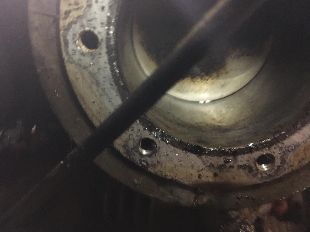

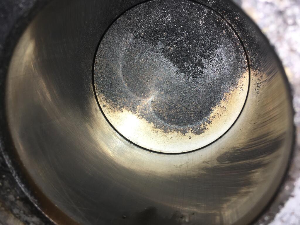

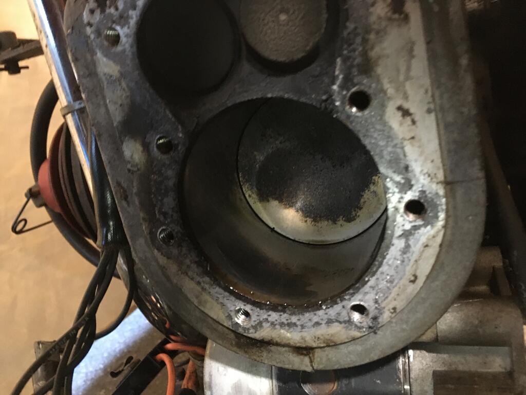

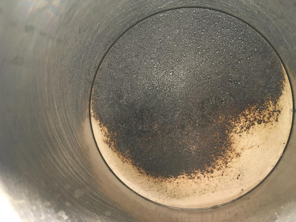

lynnmor 8,915 #18 Posted May 16, 2021 (edited) While some do use a wire wheel or wire brush, I do not. There is risk of scratching surfaces and rounding edges. After going to the trouble of removing the exhaust and intake, it only makes sense to adjust the valves at this time. Cleaning and vacuuming before and after removing the valve covers will keep debris from falling inside the engine. It appears that there is a dark stain on the cylinder wall that is not normal, the rings should have kept the cylinder walls shiny. Perhaps wiping it clean and using a different camera angle will show if there is a real problem. Edited May 16, 2021 by lynnmor 1 Share this post Link to post Share on other sites
WheelHorse520H 710 #19 Posted May 16, 2021 53 minutes ago, lynnmor said: It appears that there is a dark stain on the cylinder wall that is not normal, the rings should have kept the cylinder walls shiny. Perhaps wiping it clean and using a different camera angle will show if there is a real problem. Wiping the stain on the cylinder wall correct? I will send along more pictures later 1 Share this post Link to post Share on other sites
WheelHorse520H 710 #20 Posted May 16, 2021 No stain. Bad camera angle/bad lighting, had me fooled for a second, I wiped it out and it was still there. Then brought over a light and moved it around, I can make the “stain” appear anywhere on the cylinder wall. 2 Share this post Link to post Share on other sites
lynnmor 8,915 #21 Posted May 16, 2021 Looks good, it was the lighting. The hone marks indicate little wear, but there are some straight lines that suggest that oil changes and air filter maintenance was not the best. Share this post Link to post Share on other sites

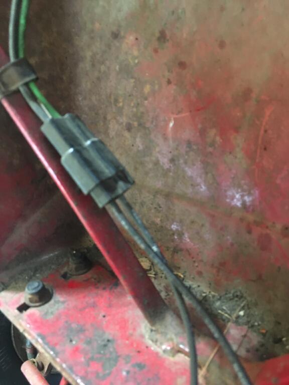

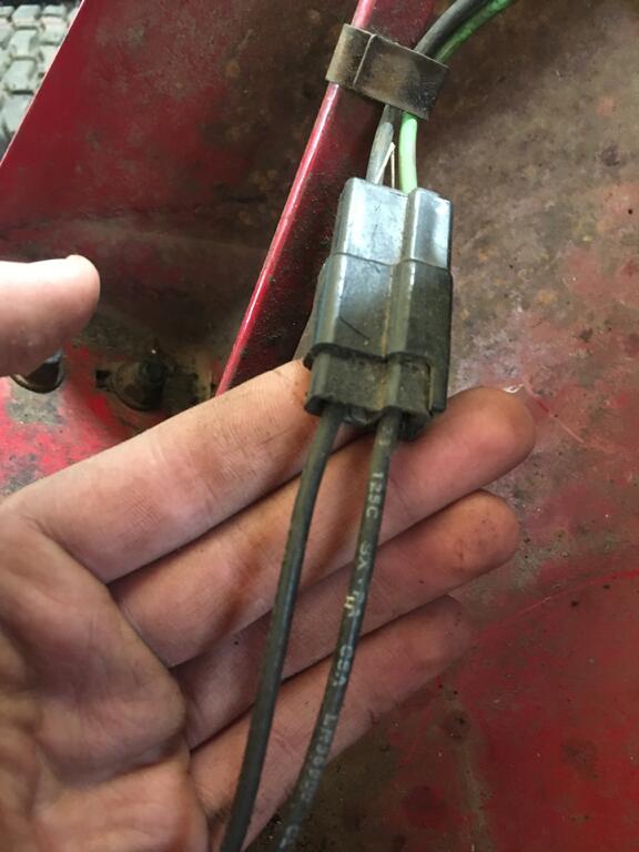

WheelHorse520H 710 #22 Posted May 16, 2021 (edited) Agreed, it was sitting for about 5 years outside so I will do better now that it runs. Also, I am trying to remove the hood for better lighting, and cannot get the headlight connector off, anyone on here know how? Thanks, Andrew Edited May 16, 2021 by WheelHorse520H 1 Share this post Link to post Share on other sites

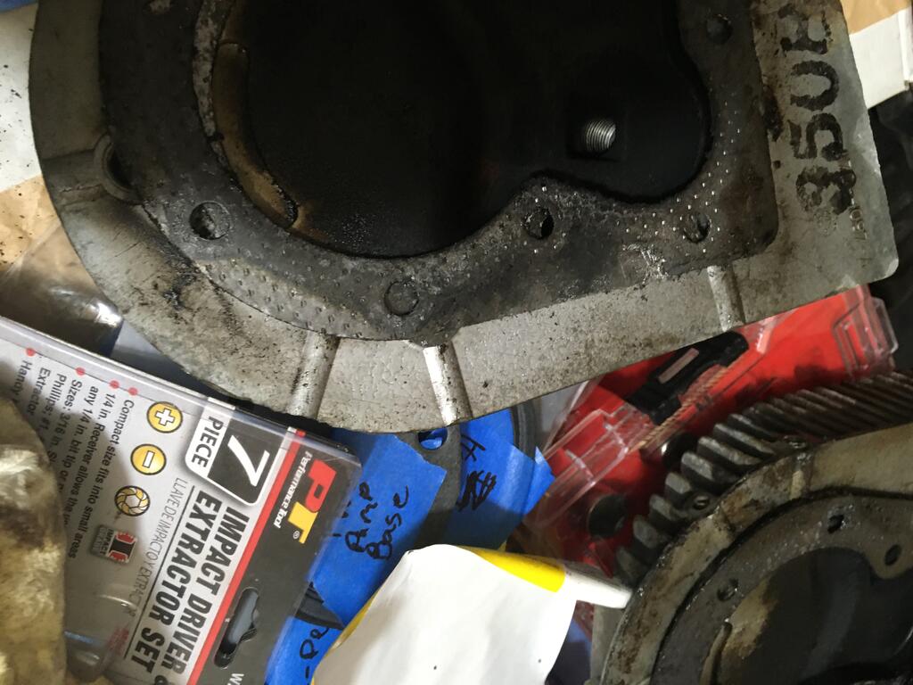

WheelHorse520H 710 #23 Posted May 16, 2021 New update: the intake manifold does not leak, holds the water just fine. The gasket between the carb and the intake was crushed one heck of a lot, could air get in that way? I do need new head gaskets and new intake and exhaust gaskets, should I just get one for the seam on the intake manifold since I have it all apart? Andrew 1 Share this post Link to post Share on other sites
lynnmor 8,915 #24 Posted May 16, 2021 The tab on the bottom right in your photo is preventing the plug from being pulled apart, pry it out a bit. If it still is stuck, spray WD-40 in and try again. You need a new carburetor gasket, there is no gasket between the manifold halves, just sealant. There is a sticky showing the repair process of the intake manifold, but apparently you don’t need a repair. 1 Share this post Link to post Share on other sites
WheelHorse520H 710 #25 Posted May 17, 2021 11 hours ago, lynnmor said: The tab on the bottom right in your photo is preventing the plug from being pulled apart, pry it out a bit. If it still is stuck, spray WD-40 in and try again. I thought that’s where it separated, but I didn’t want to break it. 11 hours ago, lynnmor said: You need a new carburetor gasket, there is no gasket between the manifold halves, just sealant. There is a sticky showing the repair process of the intake manifold, but apparently you don’t need a repair. Ok, so new carb to intake gasket, new intake gaskets, new exhaust gaskets, and new head/valve cover gaskets... got it. I will see about ordering those tonight, thanks again for all the help. Andrew 1 Share this post Link to post Share on other sites
