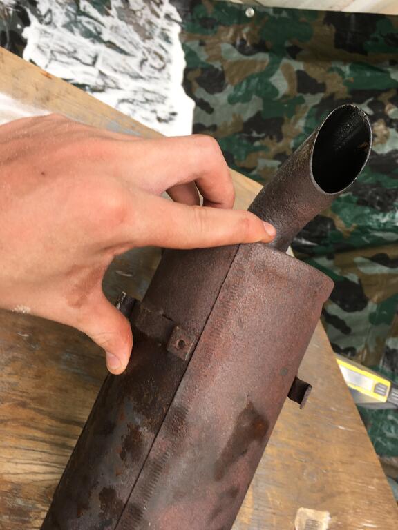

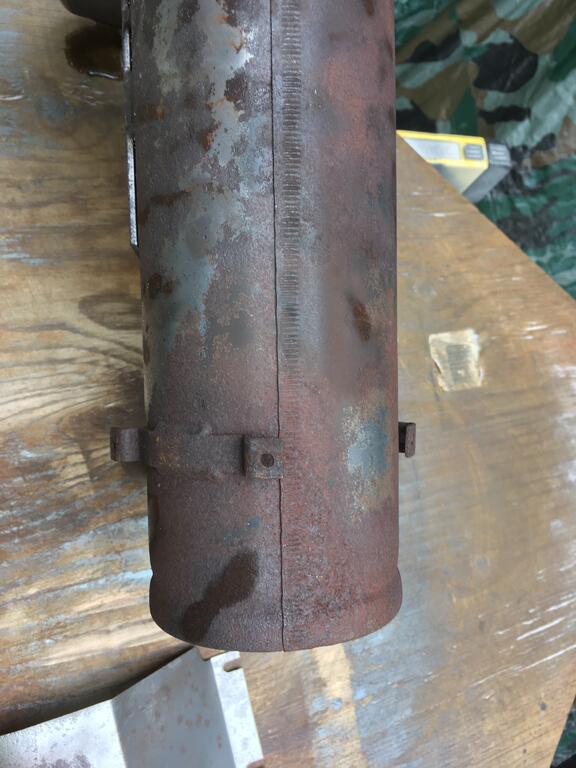

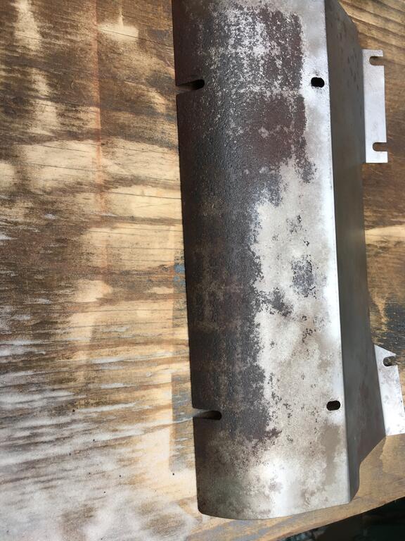

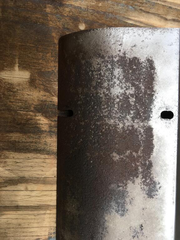

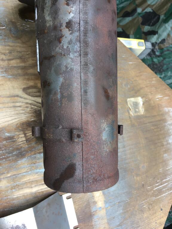

WheelHorse520H 710 #58 Posted June 19, 2021 3 hours ago, lynnmor said: true the gasket surface, but that should be done anyway. What do you mean by true the surface? I did some more blasting today but the rust on the muffler and heat shield is just not coming off, does all of it need to be completely rust-free? Or can I paint over it…photos below. 1 Share this post Link to post Share on other sites
kpinnc 18,756 #59 Posted June 19, 2021 (edited) I have never had a muffler that didn't re-rust after painting, even using high temp rust killing paint on sandblasted perfectly clean steel. My tractors are stored under a roof, but the humidity is pretty high here in NC. Probably a factor. It takes time, but they all do it eventually. I said all that only to say making the muffler perfect now can be a bit of a dissapointment later. As expensive as mufflers are, they should be made of stainless steel! Edited June 19, 2021 by kpinnc 1 Share this post Link to post Share on other sites
WheelHorse520H 710 #60 Posted June 19, 2021 1 hour ago, kpinnc said: I have never had a muffler that didn't re-rust after painting, even using high temp rust killing paint on sandblasted perfectly clean steel. My tractors are stored under a roof, but the humidity is pretty high here in NC. Probably a factor. It takes time, but they all do it eventually. I said all that only to say making the muffler perfect now can be a bit of a dissapointment later. As expensive as mufflers are, they should be made of stainless steel! Okay, thanks for the heads up, I won’t remember that by next week but at least I won’t waste time blasting anything just for it to come back. Thank you for the advice. Andrew 1 Share this post Link to post Share on other sites
lynnmor 8,914 #61 Posted June 19, 2021 2 hours ago, WheelHorse520H said: What do you mean by true the surface? I did some more blasting today but the rust on the muffler and heat shield is just not coming off, does all of it need to be completely rust-free? Or can I paint over it…photos below. To true a head surface, you need a perfectly flat surface, some use a glass pane but I use my cast iron vertical band saw table that I know to be flat. You place 400 grit paper on the clean surface and move the head about in a figure 8 pattern till the surface is touched all over. I don't know what media or pressures you are using to blast, but I completely clean using fine glass beads, yes it takes some time. When complete, I wash the parts with dish soap and hot water and blow out the seams. The surface will flash rust quickly, so be ready to get a light coat on right away. I've had little trouble with rusting after coating with Rustoleum High Temperature paint but some touch up is done when other work requires exhaust removal. 1 Share this post Link to post Share on other sites
